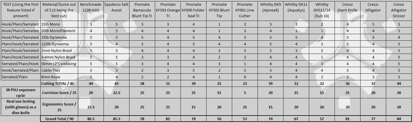

Overall results:
With so much information to present, unfortunately the only way is with a couple of results tables. There are two tables included here, one is the full results table with detailed cutting test results. This is packed with information and you will need to view the image separately (click on it) to expand it and read all the detailed results.
Please note the Benchmade 112S is incorrectly named the 112B in the tables.
Taking out the detailed cutting test results makes for a more manageable results table, and here the scores have been put into ranking order with the top scores at the top of the table.
