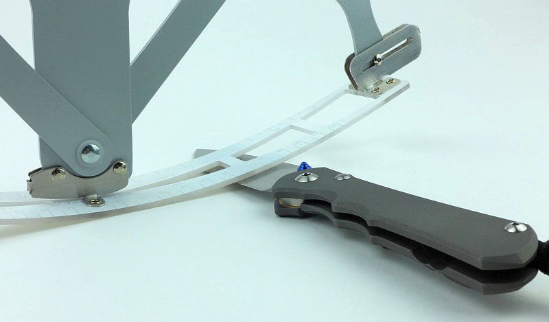

    Using a set of gauges and precision measuring equipment including a Vernier protractor, callipers, fixed radius gauges and the unique Arc Master adjustable radius gauge (the one that looks like a crossbow).
    These measurements have been tabulated and are presented along with a few reference blades (8" Chef's Knife, 5.5" Santoku and the popular Fällkniven F1).
    Key aspects such as the primary bevel angle, grind type, blade depth, blade thickness, length, weight are detailed, along with balance information.

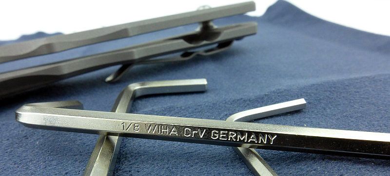

    Along with the Large Inkosi you get a CRK cleaning cloth, two Allen keys for the pivot and one for the spacer and stop-pin bolts. there is also a tube of grease and thread-lock, giving you a full service kit.
    Not to skip over this too soon, please note that these are not unbranded tools, you get WIHA Allen keys.
    The grease is a fluorinated grease and thread-lock is Loctite 222.

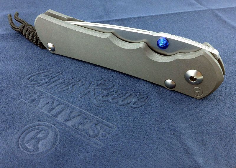

    As with the Sebenza 25, the Inkosi has finger grooves in the handle.
    Fit, and finish is flawless, just as you would expect with CRK.

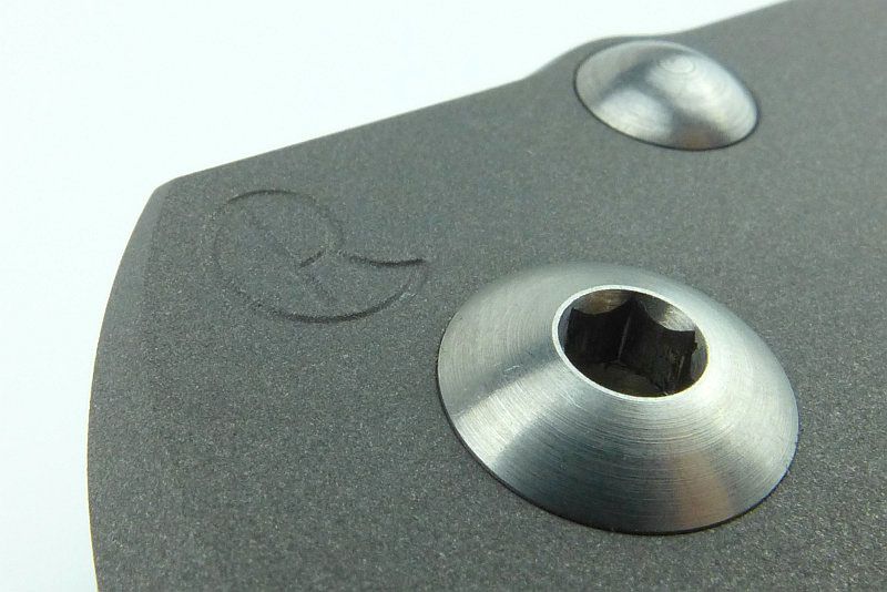

    The understated logo sits next to the large pivot bolt.

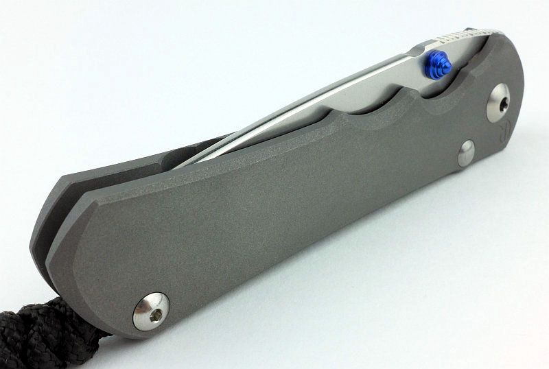

    Switching to the back of the frame and you can see the left-hander's thumb stud, but there is less space between it and the lock bar than for the right-handed thumb stud.
    On the back, the pivot bolt looks identical. You can also see the stop-pin bolt as the stop-pin is only fixed to the back of the frame.

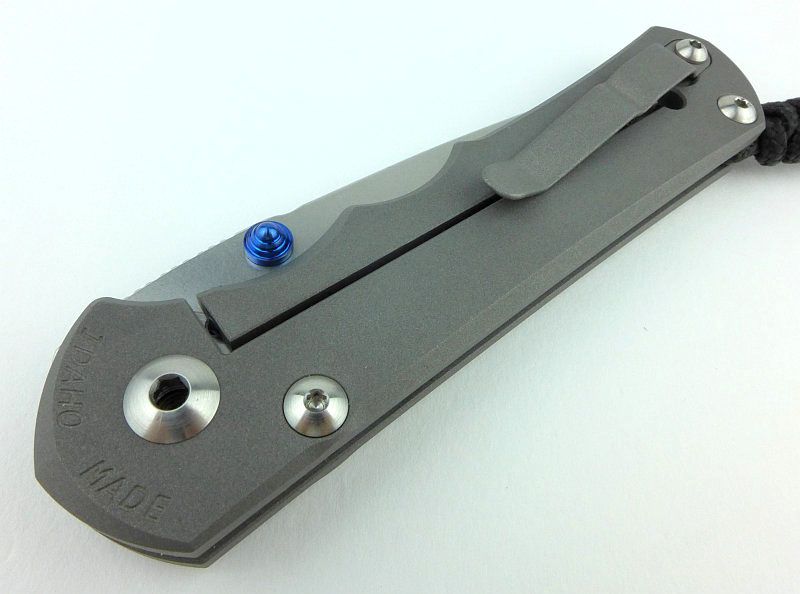

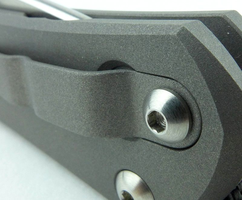

    Start casting your eyes towards that pocket clip.
    Another part of the CRK folder design that has changed is the movement of the clip so that it sits directly onto the frame instead of onto the lock bar. This ensures no additional pressure on the lack bar which might make opening the knife more difficult.

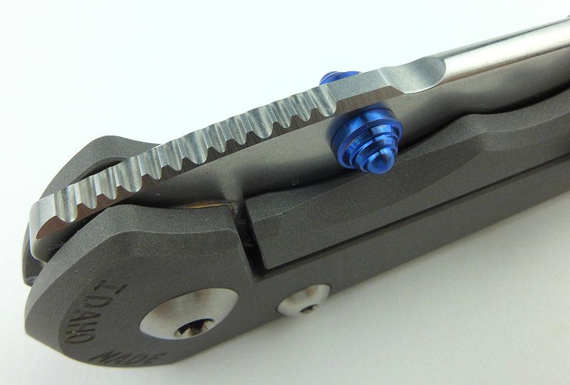

    Giving excellent grip, there is a section of asymmetrical pattern jimping on the thumb ramp.
    A single bolt holds the clip in place and can easily be removed if you prefer not to have a clip.

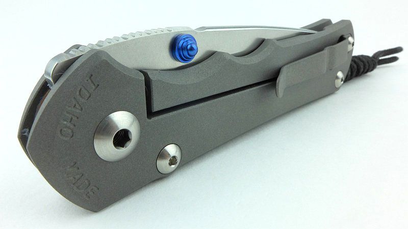

    To create the lock bar spring, two large radius scallops are cut out of the bar.

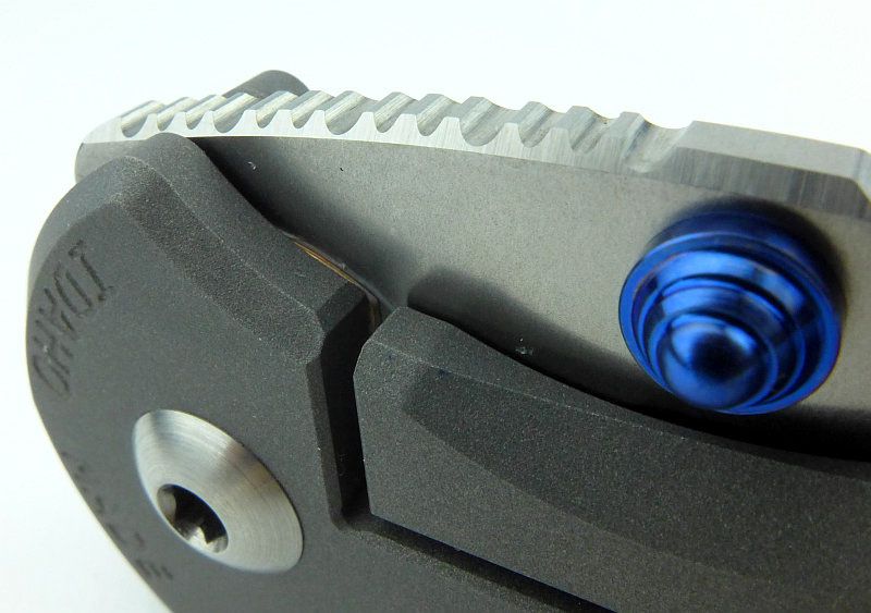

    Providing the spot of colour, the ambidextrous thumb stud is blue PVD finish.

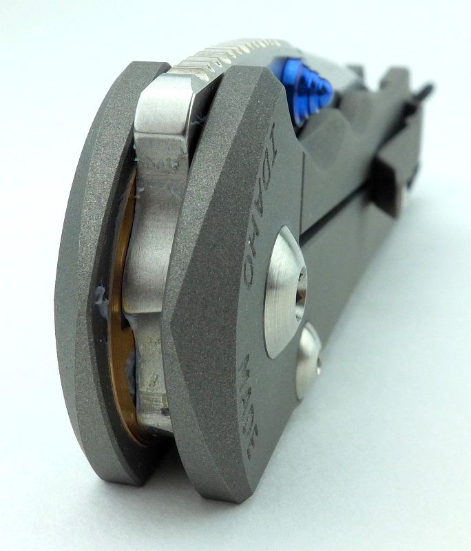

    With the blade partway open, here you can see the ceramic ball is out of the detent hole and sitting on the side of the blade tang. Like this the lock bar now stands slightly proud of the frame.

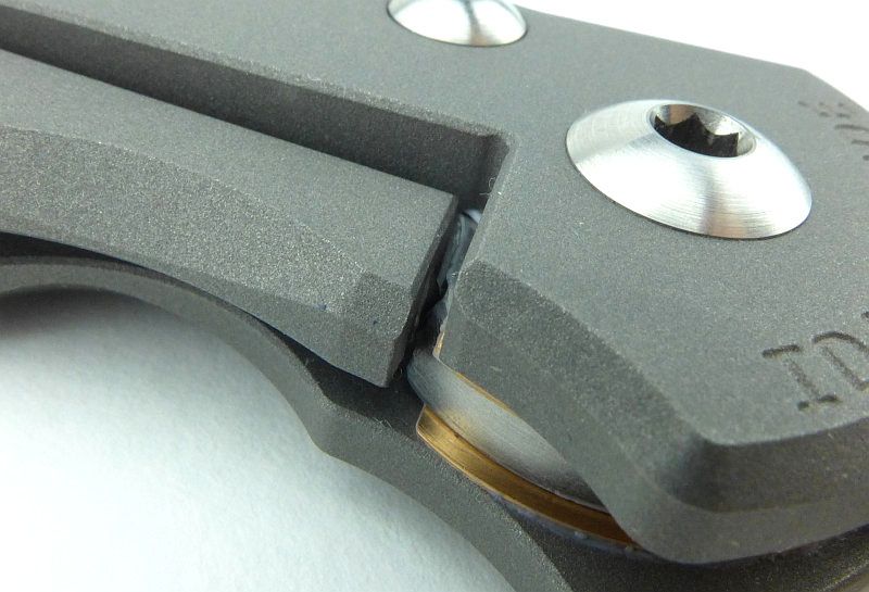

    When the lock engages, the lock bar has clearly moved into the frame. Also note here how the washer is actually larger than the blade tang.

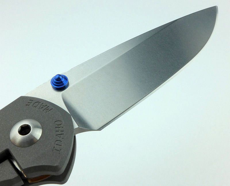

    The blade has a beautifully even stonewash finish.

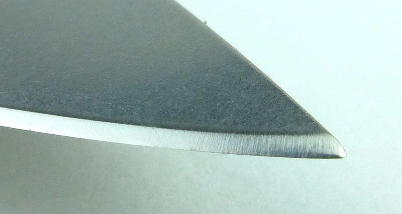

    Zooming in to the blade tip.

    In the assembled knife you can see how the over-sized washers are fitted to the lock bar cutout in the frame.

    On the first run of Large Inkosi knives the washer perforations were a little too large and could be seen when the blade is closed. Not a functional issue, but a potential point for dirt to collect. This washer design has been updated now.

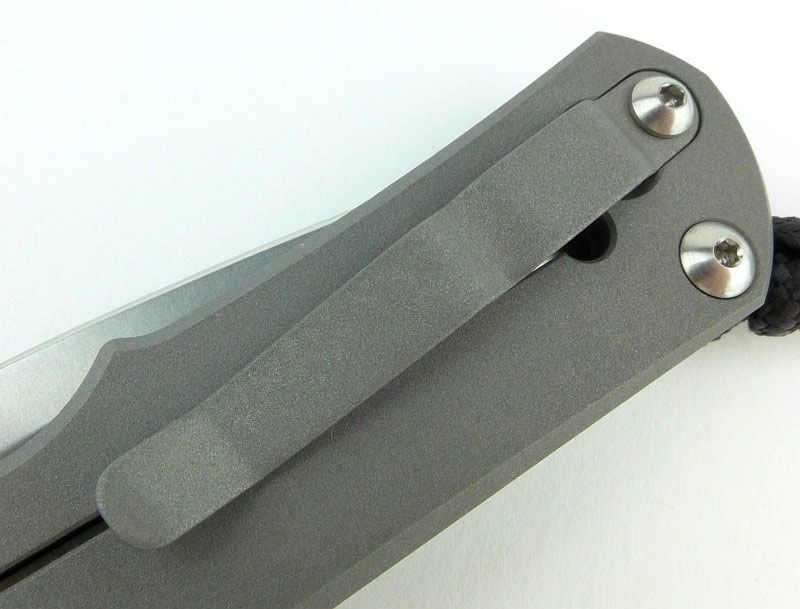

    CRK have really got it spot on with the pocket clip. I generally don't like them because they are never quite right, mainly too aggressive. In this case the tension is soft enough to be easy to use, but strong enough to hold. The bead blasted surface finish of the frame and clip give plenty of hold without being too abrasive.

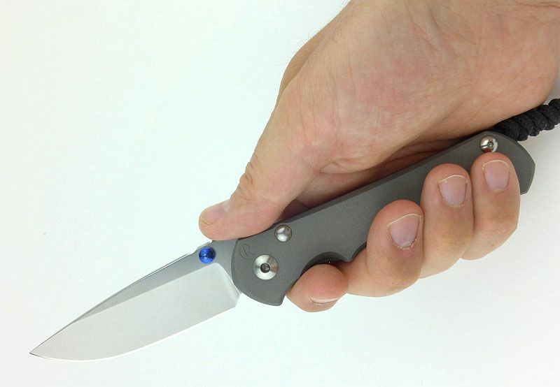

    And in the hand. (I take XL size gloves). So it is not really all that large, it is just the larger size of CRK folder. While we are looking at it in the hand, I'm going to mention those finger grooves. It often seems that the Sebenza 21 vs 25 debate has been very polarising with owners being adamant that the they love or hate the 25's finger grooves. I was concerned they might be problematic, but for my XL size hands, I can happily say that in all the time I've been using this knife I have actually not noticed the finger grooves. Clearly this is a good sign as the knife was secure in my hand but without anything digging in.

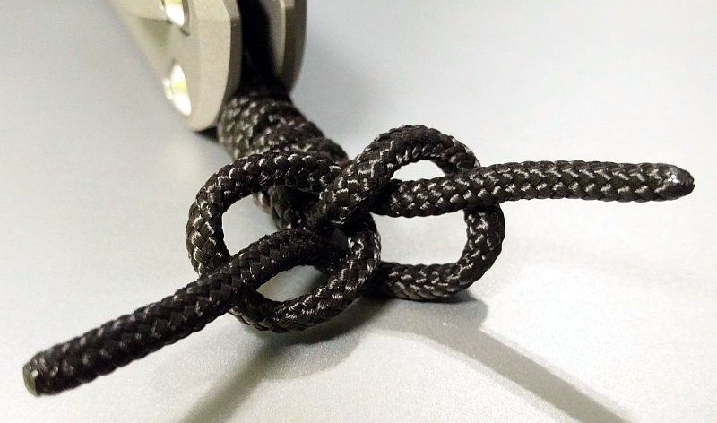

    Lanyards, hmmm. Not my thing. So this was to come off, but I thought I would just note down how it was tied so I could put it back.
    Loosening the first knot shows it is tied like this.
    And repeated all the way back to the first knot round the frame spacer. And with that removed I started putting the knife to work.
