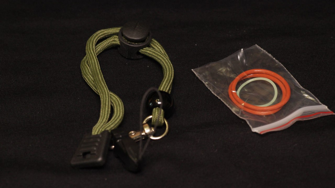

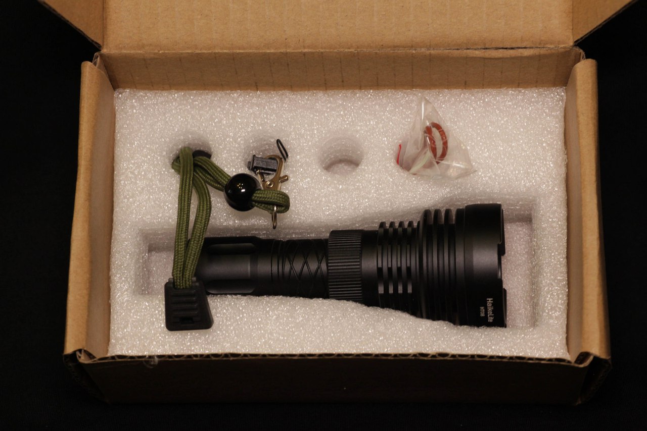

Package includes olive lanyard, and pair of o-rings, which is enough for cheap flashlight.
And what is DFINETELY not ok, is lack of manual. with S2\C8\unnamed zoomiezis not a problem at all. But once HT08 has several mode, giving user a clue how to switch them is an obvious necesserity.

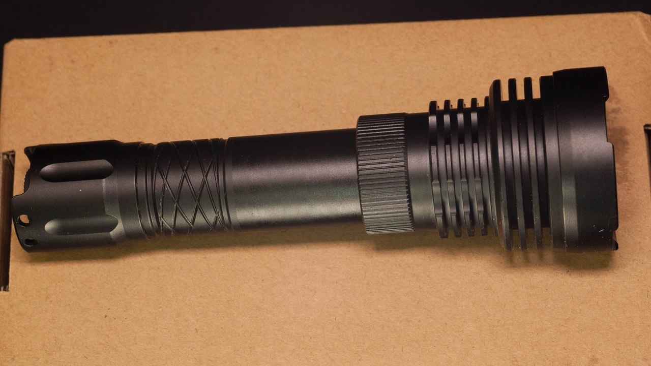

What about size – difference is vivid – 115\150mm, but still no more than C8
Expected tail button, no suprise for such price and sort of flashlight.
There are spings at both tail and head.

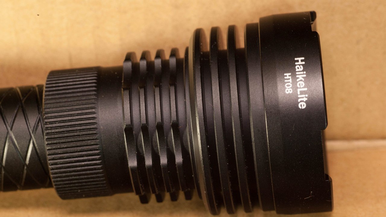

Knurling is not that long, only covers that part of body, which can be seen in short focus.
There are good cooling ribs, but you have to consider that heat transfer in out case will go through screws, on which head moves up and down body.

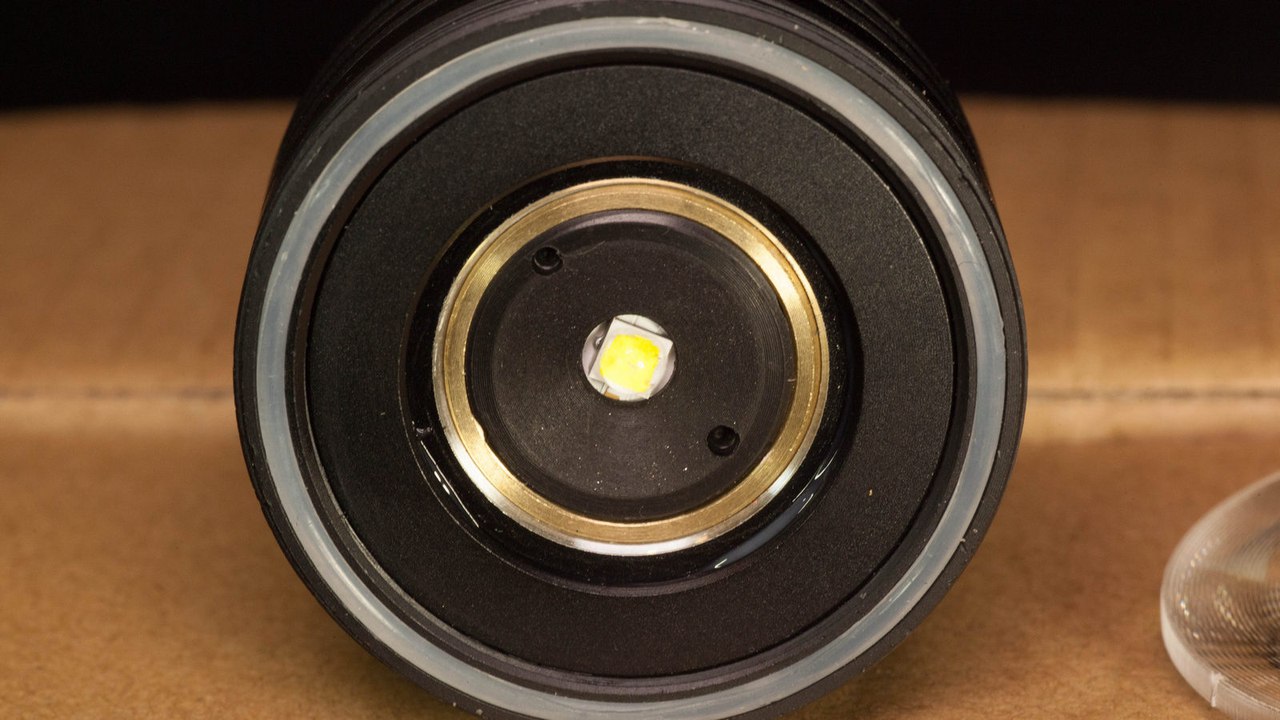

Haikelite put XPL 5000K here, the fact that makes light tint a way better than morgue-blue one of cheap zoomies.
Take a look – in tele position, LED is hidden deep into tonnel. So, no surprise, decent part of light will be consumed by threads at sides. Though, i outta add that even the rest is definetely enough for simple needs and brighter than you get from cheap zoomies.

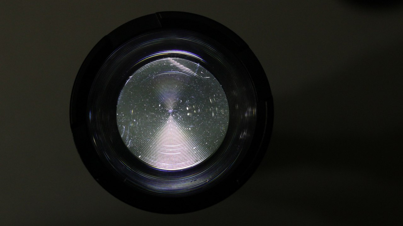

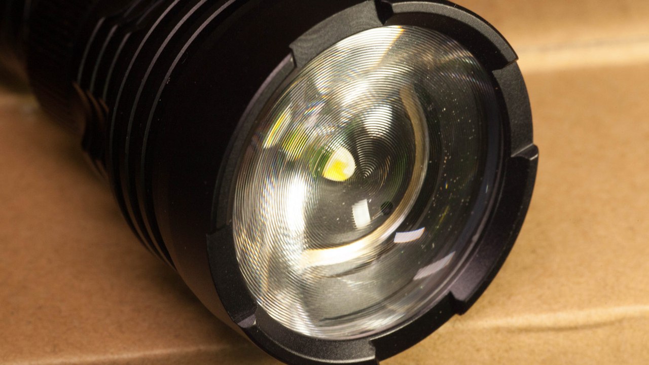

One more dislike is that in long-focus only part of Frenel lense is used.
In short position LED almost touches lens. The last one is covered with AR glass.
You have to screw head to adjust focus, and it`ll take some time, especially comparing with cheap zoomies.

No surpise – package is cheap, like most of of Haikelite. But still it`s a superb comparing with Convoy and zoomies, which has simple white paper box, in best case.
