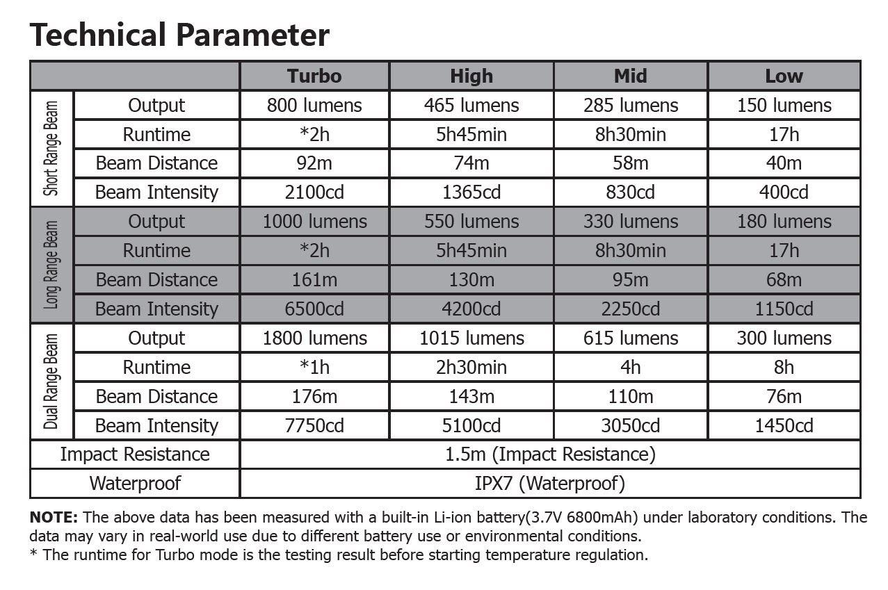

    To start with, I’ll give you the (manufacturer) specifications of the BR35:
    And here’s a chart of the output and runtime specs:

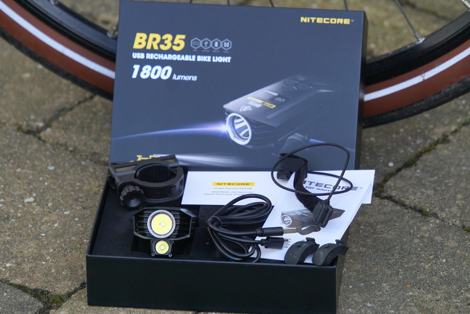

    A new box here that I never saw earlier by Nitecore. A “closed-top” carton that comes in main black color with yellow and silver letters. I like the looks of this luxury package! The light keeps its secrets this time, only the double output and the lumens are mentioned on it. Protecting-from inside that has three cut-outs in which you can restore the light and the parts. A very neat box that I really like! Inside we find the main things we need like (of course) the BR35, a charging-cable, adaptor for you bike, remote-cable, manual and thick and thin rubbers for the adaptor. Only tool you need here is a power-source, that, (in my case) I new saw supplied by Nitecore until now. For the rest this nice box is ready-to-go. No negatives here, this is a nice and complete package. Have a look at a couple of pictures that show the box and the BR35 and its accessories.
    a closed-top box for the Nitecore BR35
    this looks neat: it’s easy to (re)store the light and the parts
    the contents: ready-to-go!

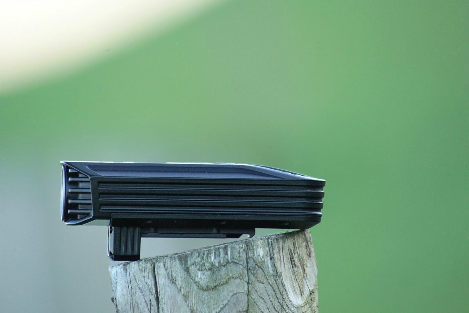

    I was really impressed by the BR35 when I held it for first time. Although it is a bit heavy, the overall build-quality is excellent! This diecast light, that is made of one piece, feels good. The body is fully made of metal, the light comes in matte black color with some nice accents. Striking are the “built-in” brand name above the OLED-screen and the white diffuser reflection board under the main head. Although the design of the BR35 reminds to some earlier released bike-lights, Nitecore has given the BR35 its own looks and appearance. Unique detail is the separate and tiny secondary head that is “pasted” on the body. Deep fins around the main head must prevent against overheating. We see these fins back also at both side and at the tail of the BR35. Personally, I like the design. About the anodizing: After some weeks use, I detected that the layer can release quite easily after a drop. This can be a disadvantage of a die-cast light. On top of the design, we see the OLED-screen and the control panel with three rubber buttons. The engraving is clear and well-aligned, like we’re used of Nitecore. If you want, the light can be put on its tail, but it isn’t stable. To me, this isn’t a must on a bike-light. At the right side there’s a micro-usb port, that is covered by a rubber cover. This port has two functions: It is needed to recharge the light and you can plug in the remote control there. In front of the BR35, we see two heads: A big and a small one. Both have smooth and shallow reflectors and a XM-L2 U2 emitter it, created to give the light a floody beam. The leds are well-centered, the lenses are clean, the reflectors without defects. An striking detail (and a nice find) is the white diffuse board that reflects the beam of the little head. Advantage is that it won’t blind oncoming traffic and it gives also a wide-angled beam to the light. The BR35 has a fixed accupack, so the the only way to open it is to unscrew the nine torx-screws. When I summarize this I have to say that the fit and finish of the BR35 is excellent, very well done by the manufacturer! Have a look at a couple of pictures below that show the details of the light!

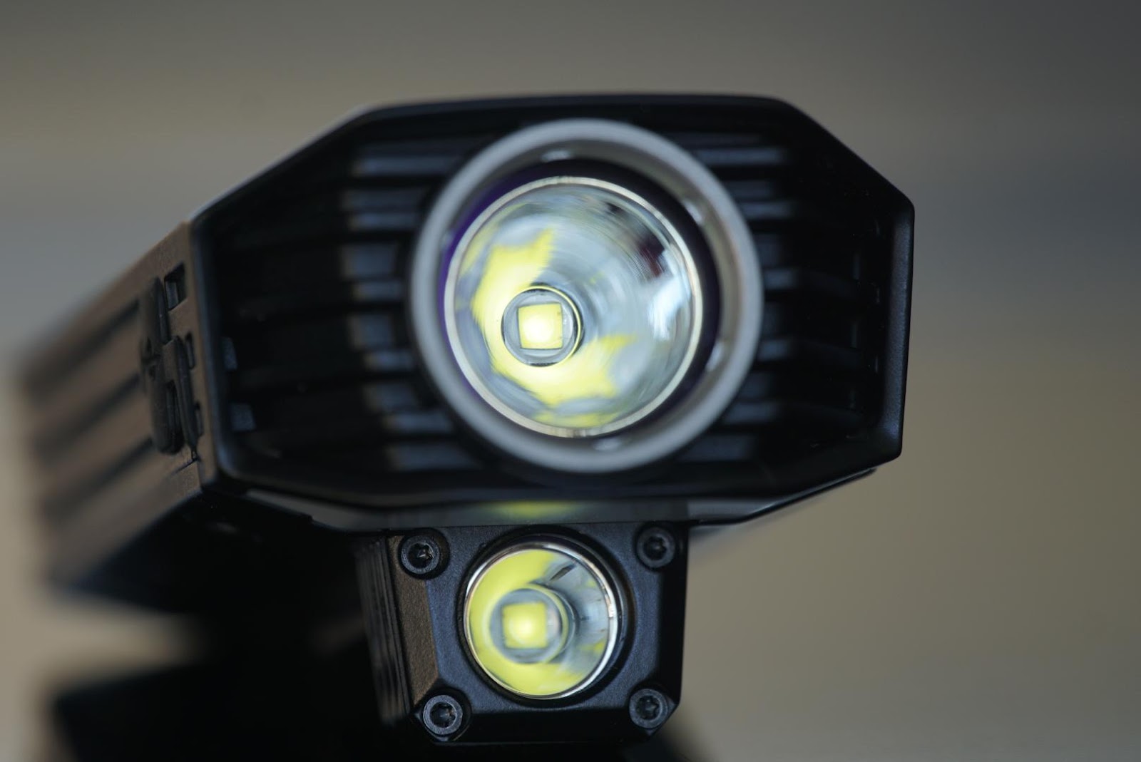

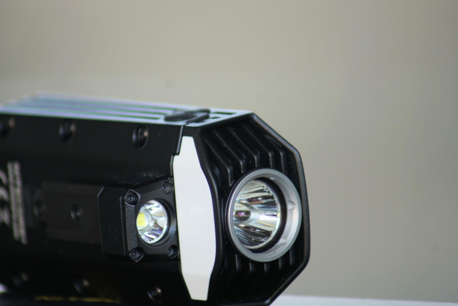

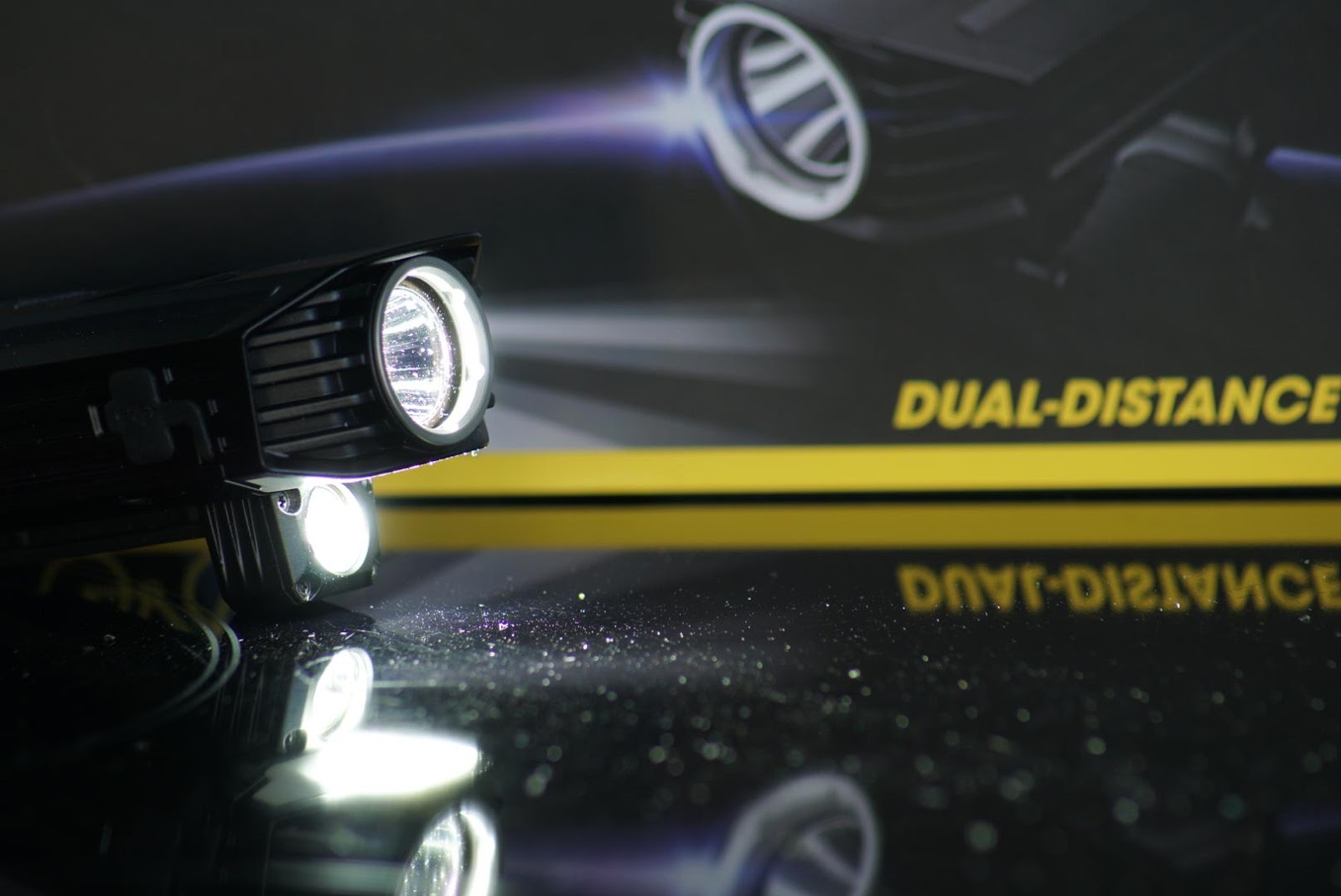

    fitted with two XM-L2 U2 leds
    with this “dual distance-beam” you can adjust the BR35 to current conditions

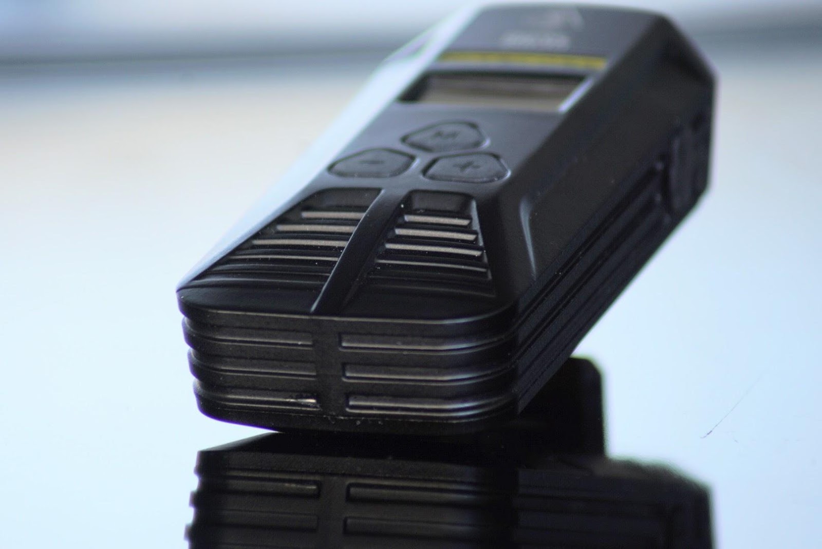

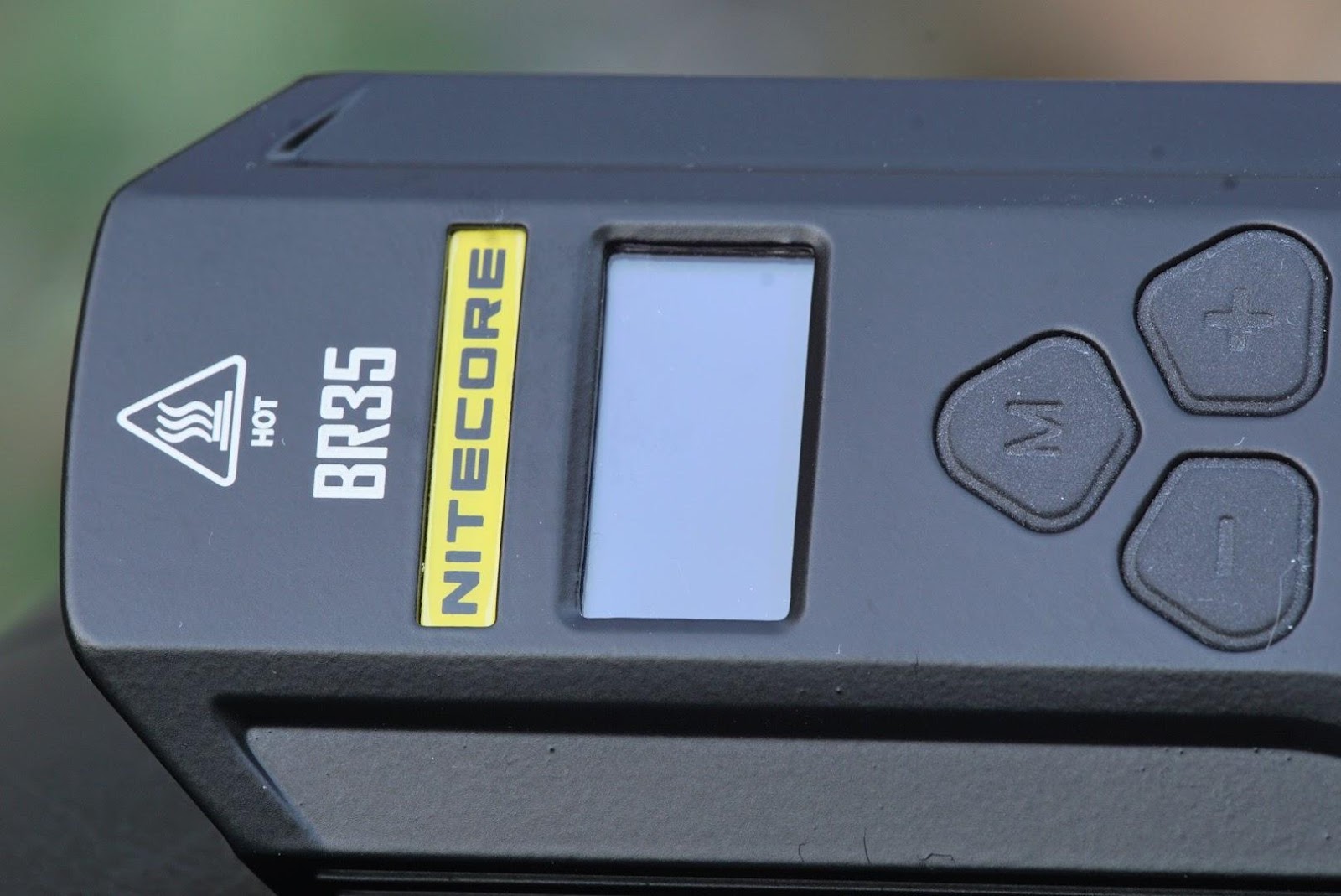

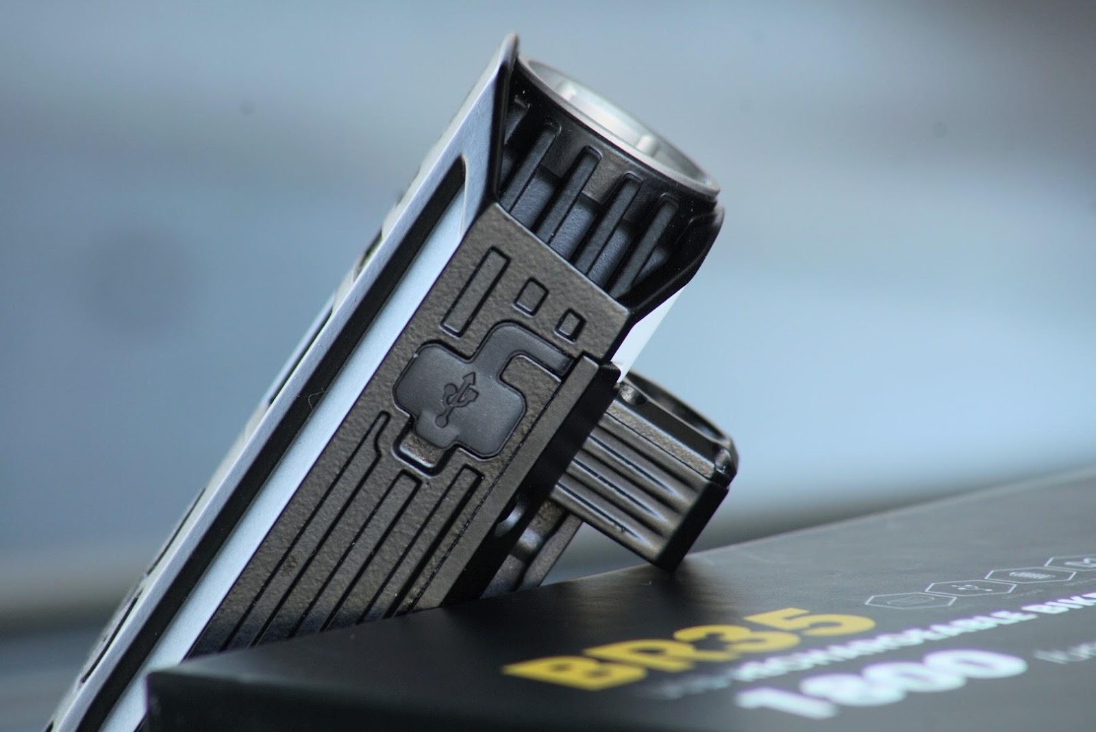

    a close-up at the control-panel
    a look at the head and the covered charging port
    thanks to the illumination you will always find the right button

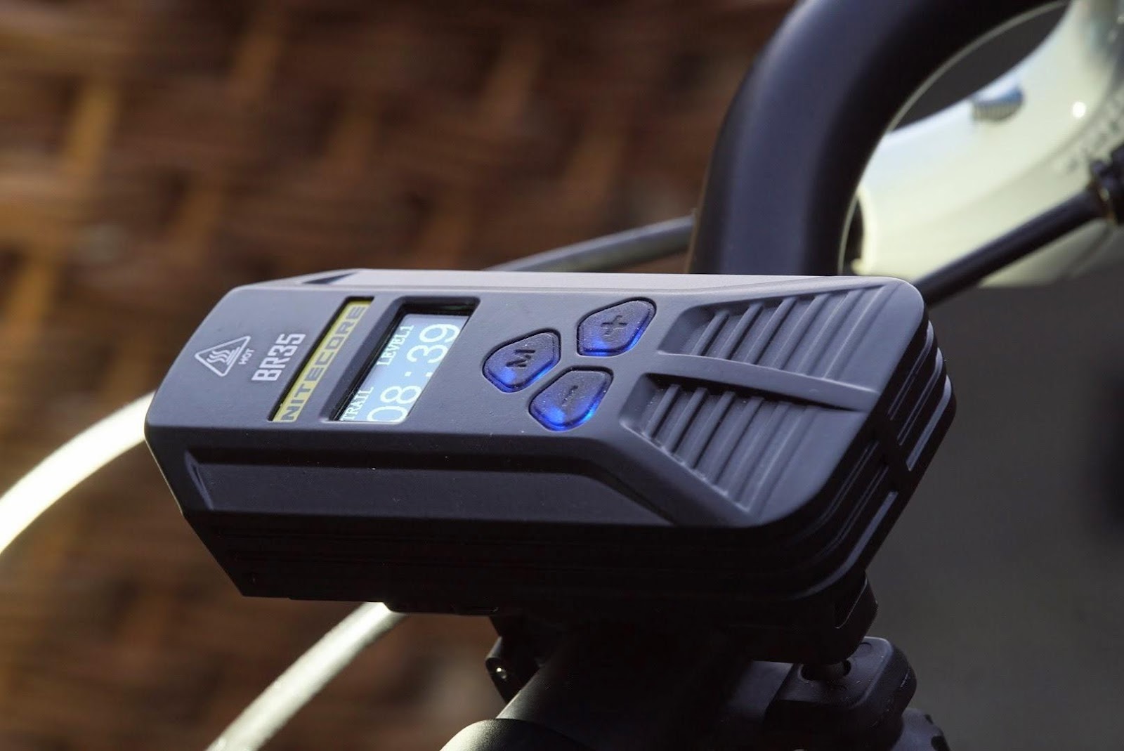

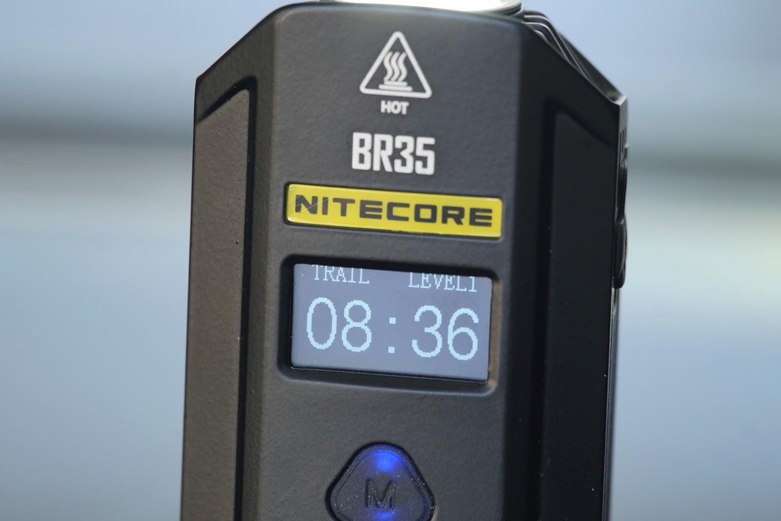

    at the display you see the main mode, the level and the remaining time of the battery
    everywhere fins to dissipate the heat

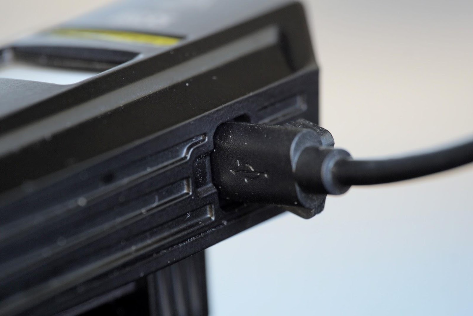

    an easy job: charging the BR35

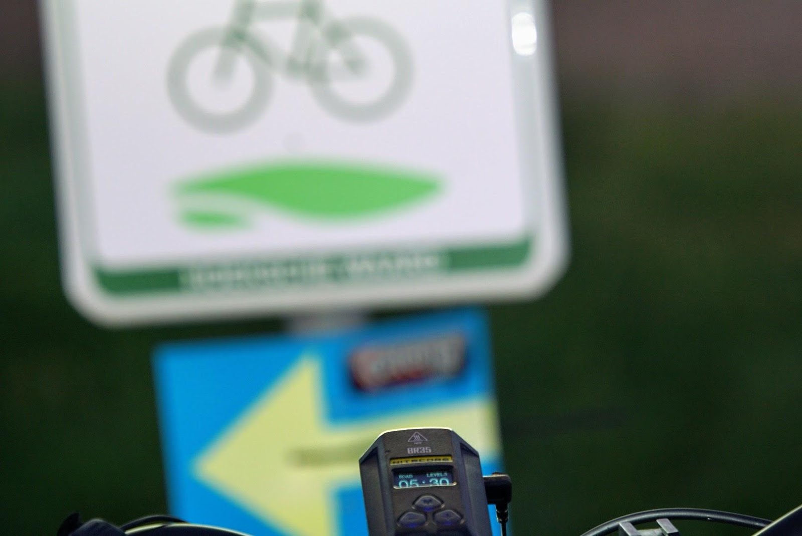

    looking for the way; five and a half hours left with the battery..
    the lower head is for short range

    heads work separate or together

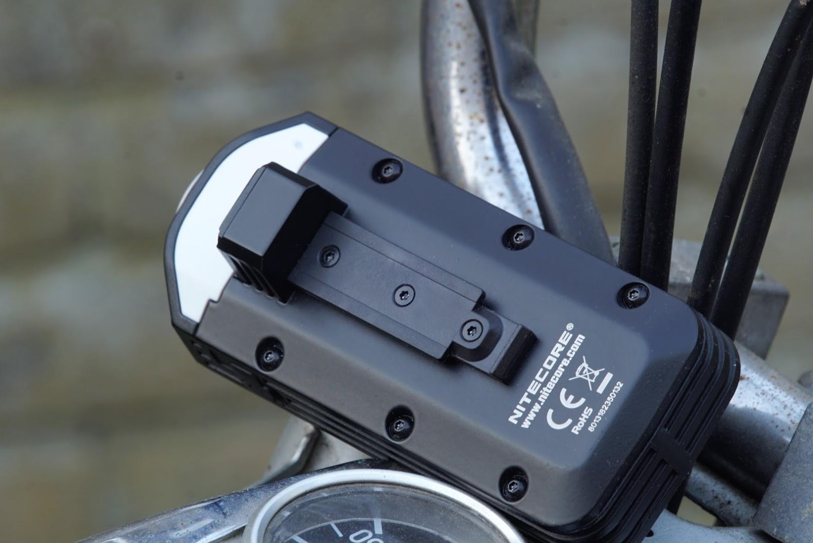

    Fixing the handle bar mount to a bike works easy and fast; in the manual you can find info about which rubbers are needed for your bike. Adding the mount takes only a few seconds, just fix it and use the screw to tighten it. After that, just slide the BR35 into the mount, beware that a soft click must be heard. If you want, add the remote control close to a handle and you’re ready to go! No issues here, works all smooth.

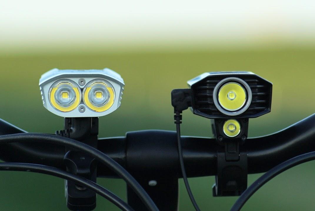

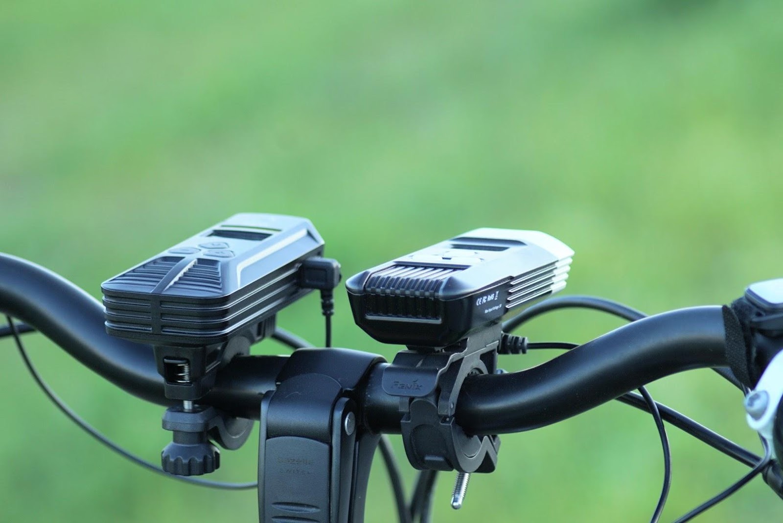

    To show the size of this light, a picture next to a 18650 and to another bike-light in this class, the Fenix BC30R. For the beamshots, that I will show you later in this review, I’ll pick those two again.
    Fenix BC30R and Nitecore BR35
    Nitecore BR35 and Fenix BC30R
    the heads: XM-L2 (T6) and XM-L2 U2

    Although both head use the same leds, the profiles are different because of the used reflectors. A shallow reflector for the floodlight, a deeper one for the upper head. As expected, the deep reflector gives a more narrow spot, and a clearer transition from spot to corona and corona to spill. The reflection-board gives a “flat-top” to the beamprofile of the short-range head. The main head is rather “throwy” so it can blind oncoming traffic. During testing, I got some comments about this and solved this by adjusting the head a little. I couldn’t see any defect in both beam, and they are free of PWM.

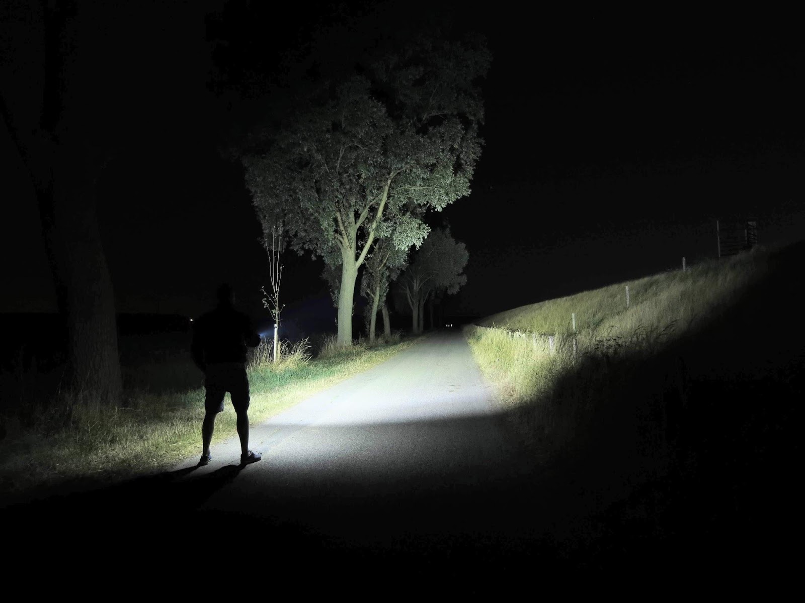

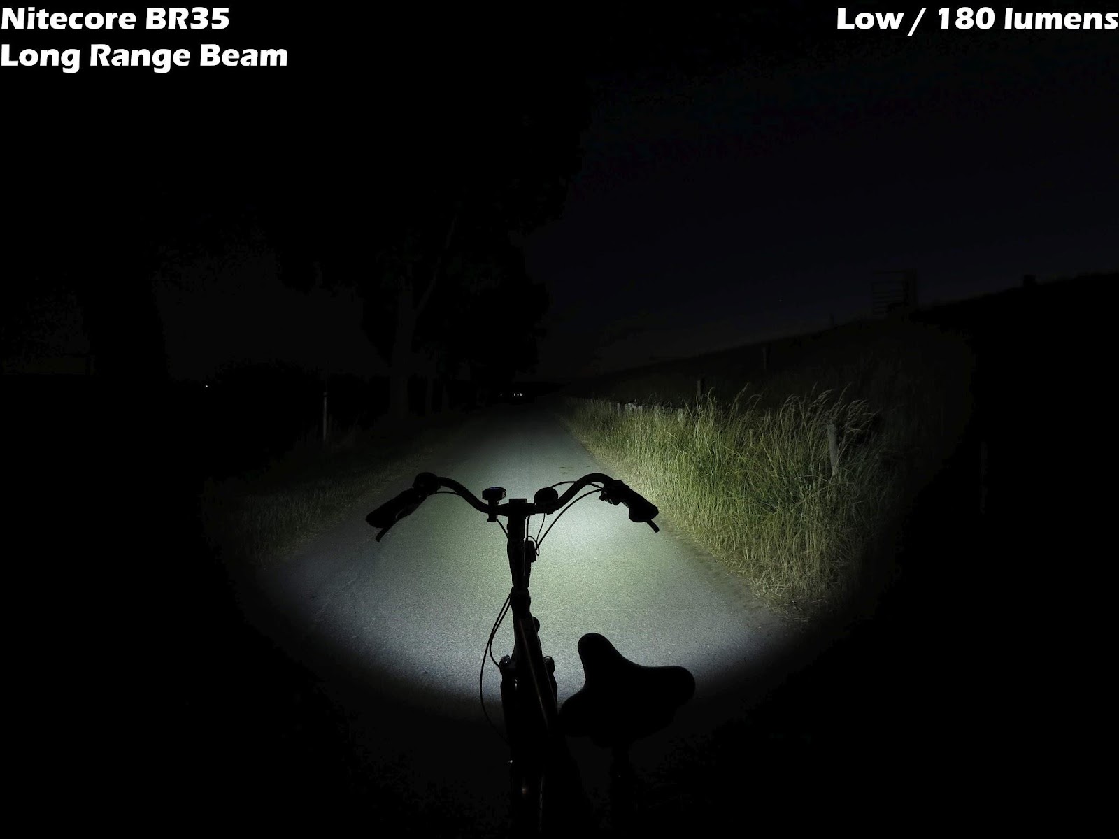

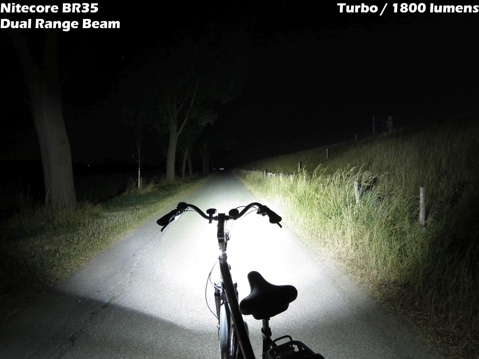

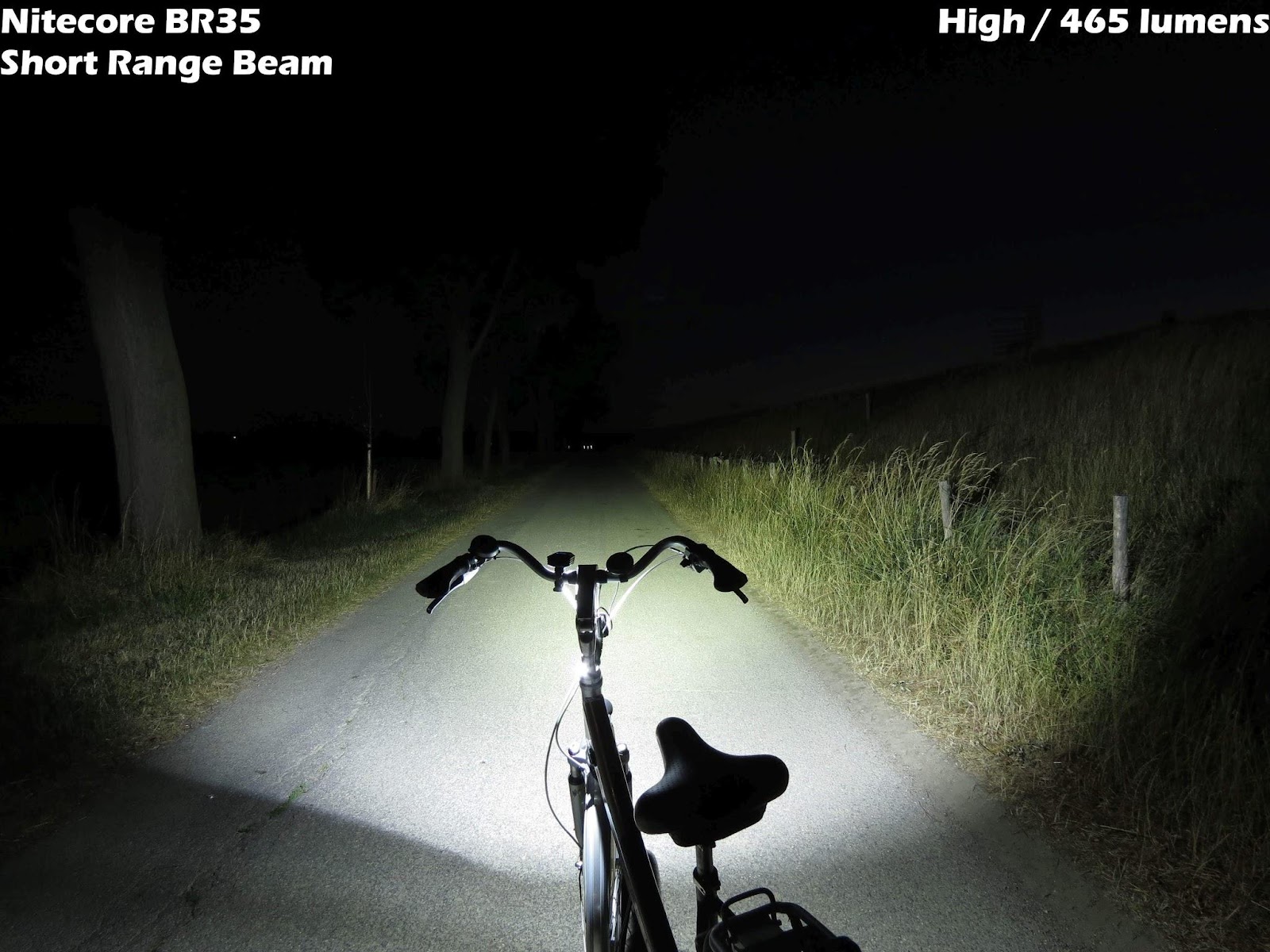

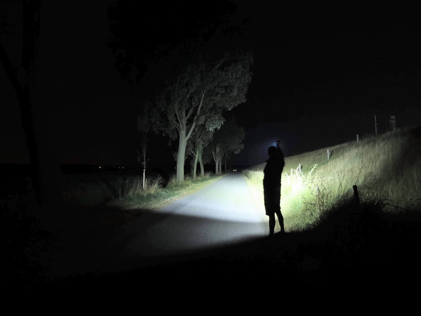

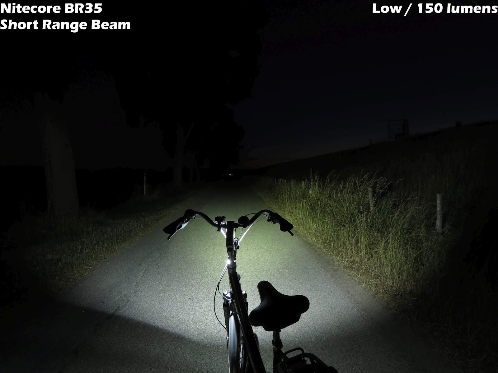

    Time to take the BR35 outside. Location is a road with some trees at left and a dike at right side. I’ll show you all modes and levels here; after that I’ll compare the BR35 to the Fenix.
    Camera settings: ISO100, WB daylight, F/2.7, 4 sec, 35mm
    Short range:
    GIF:
    Long range:
    GIF:
    Dual range:
    GIF:
    Here’s a picture that shows the difference between short, long and dual range. All modes show at maximum output-level.
    long versus short versus dual beam
    A shoot-out now with the Nitecore BR35 and the Fenix BC30R. The BR35 has better throw, the Fenix a wide, floody beam. Sorry for disturbing the picture with my arm, this is because the turbo of the BC30R is a burst-mode, and I had to keep the remote controller pressed during the shot...
    the BR35 versus the BC30R, both on highest level
