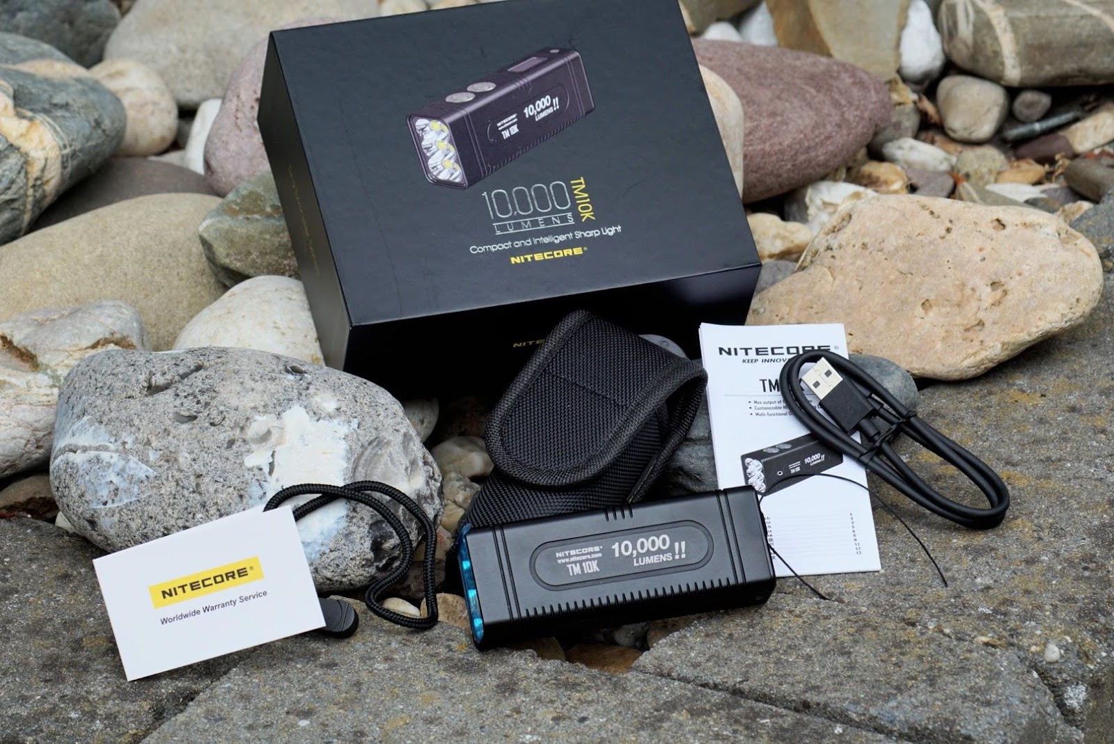

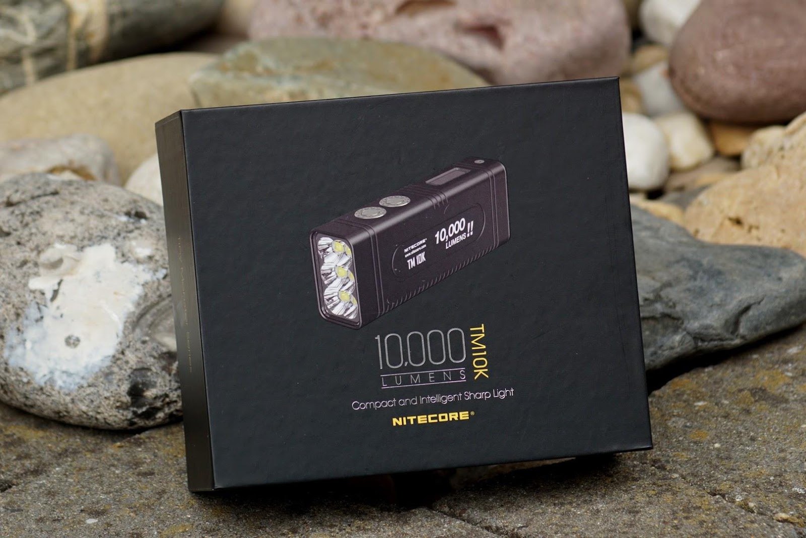

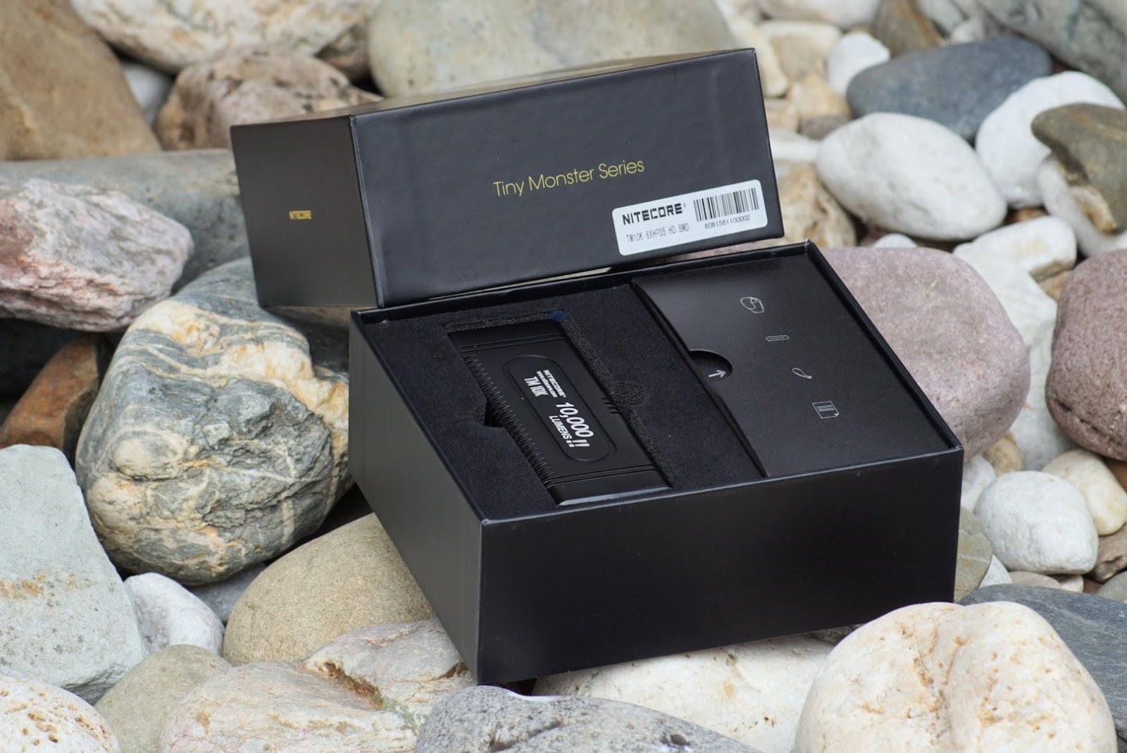

    The TM10K arrived in a luxury “closed-top”-box. As I said earlier: Mostly the big lights come boxes with little pictures and text. On the black box we only see the type, the maximum output, a very short description and a photo of the TM10K. In the box we see the TM10K in a foam casing; in the other compartment (that is covered by a flap) we find back the spare parts, the accessories, warranty card and manual. I’m happy with a box like this one, it doesn’t take effort to restore your light because there’s enough space for it. Except a power-source to recharge the TM10K all we need is in the box; you don’t have to look after spare rings or a battery because the cell is built-in to the light, so it can be opened. So, we can start almost directly; only this is that we firstly need to charge the light. A nice box in contemporary style. Scroll down to see some pictures that show the box and what we find inside!
    a nice, black carton with little prints on it
    big enough to restore the light and the parts without problems
    main colors are black, yellow and silver
    two compartments: one keeps the TM10K, the other is for the accessories
    inside: warranty card, strap, holster, TM10K, manual and charging cable

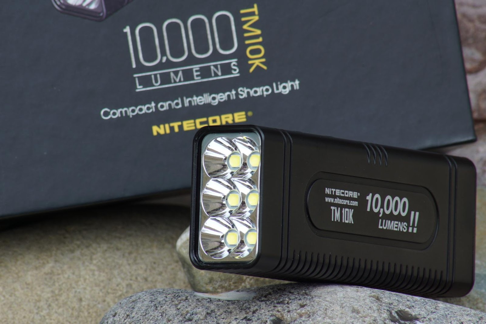

    Impressions:

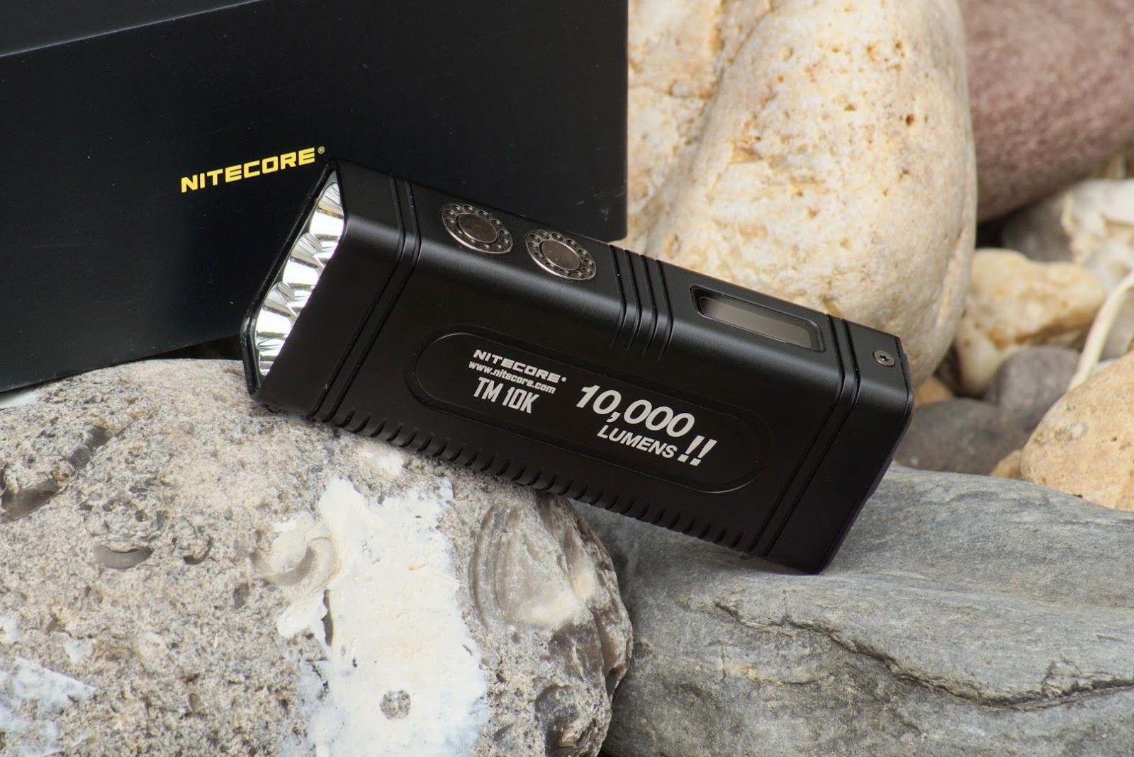

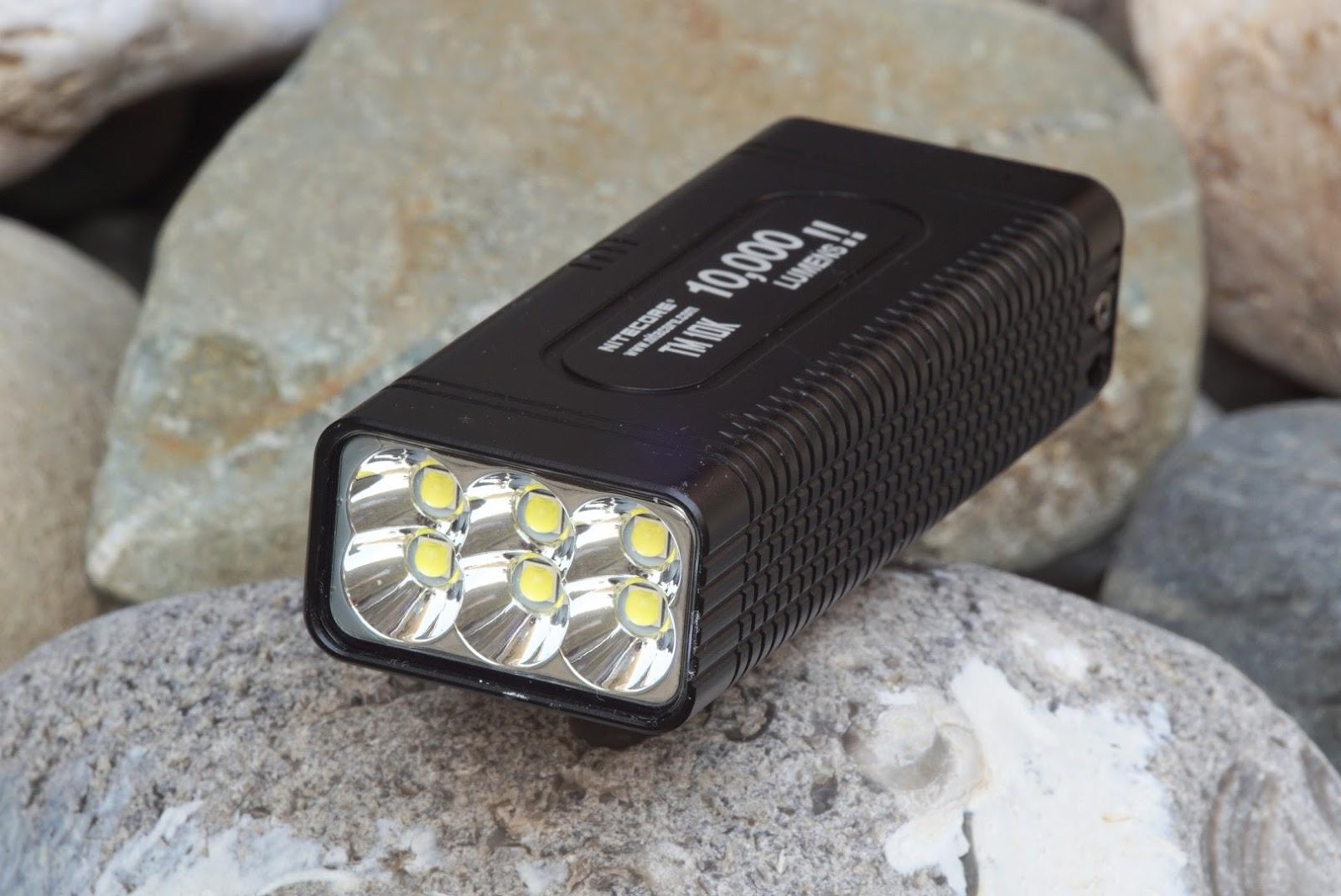

    First impression: Wow, this lumens-monster is more compact than I expected! It only has the length of a compact smartphone and about half the width. The TM10K has its own looks with details that I never saw before on a Nitecore. Some striking details that you can’t miss: The big clip, the print a the side with 10000! lumens and the head with six! leds placed near to each other in the head. Like I mentioned on other recent released Nitecores, the TM10K shows also that the manufacturer still improves their overall quality: The fit and finish on this flashlight is very good. The light comes in matte black and the job on the anodizing is done well. Same for the engraving; but personally, I’m not a fan of the big “screaming” letters on the side. Thanks to its shape, the TM10K can be put on each side without toppling, and will never roll away. One side on the TM10K has knurling for good grip, at the opposite we find back two metal switches that have nice “titanium” looks and design, and a compact screen. The screen is cover by plastic and therefore unfortunately not scratch-resistant. The OLED-screen gives a lot of information to the user, I will come back on this feature in the interface-paragraph. The TM10K has a big and strong clip that only can be removed by unscrewing the torx-screws. Looking in the lights’ lens we see rather shallow reflector that hold the six XHP35 HD-leds. The emitters are well-centered, the reflectors are clean. In my sample, I detected some some glue on the edge between glass and reflector. By the way, this did not hinder the output. Looking at the back, we see again a metal switch with an integrated blue led. Next to the switch, we find the first USB-C port on a Nitecore-light, covered by a well closing-rubber. Close the the switch, there’s a little hole on the side to add the lanyard or a paracord. Adding the strap requires a lot of effort, fortunately Nitetore provides a hairline which helps you to fix the lanyard to the light. For technical reasons, the manufacturer decided to bring out the TM10K with a built-in 21700-battery, so the light can’t be opened.
    At the end of this paragraph, my overall impressions of this light are good. The TM10K is built very well; the finishing is ok. Some parts, like the screen and the clip are sensitive to user-tracks; but some user will like this.. Please have a look at a lot of pictures below that show more about the TM10K and its details!

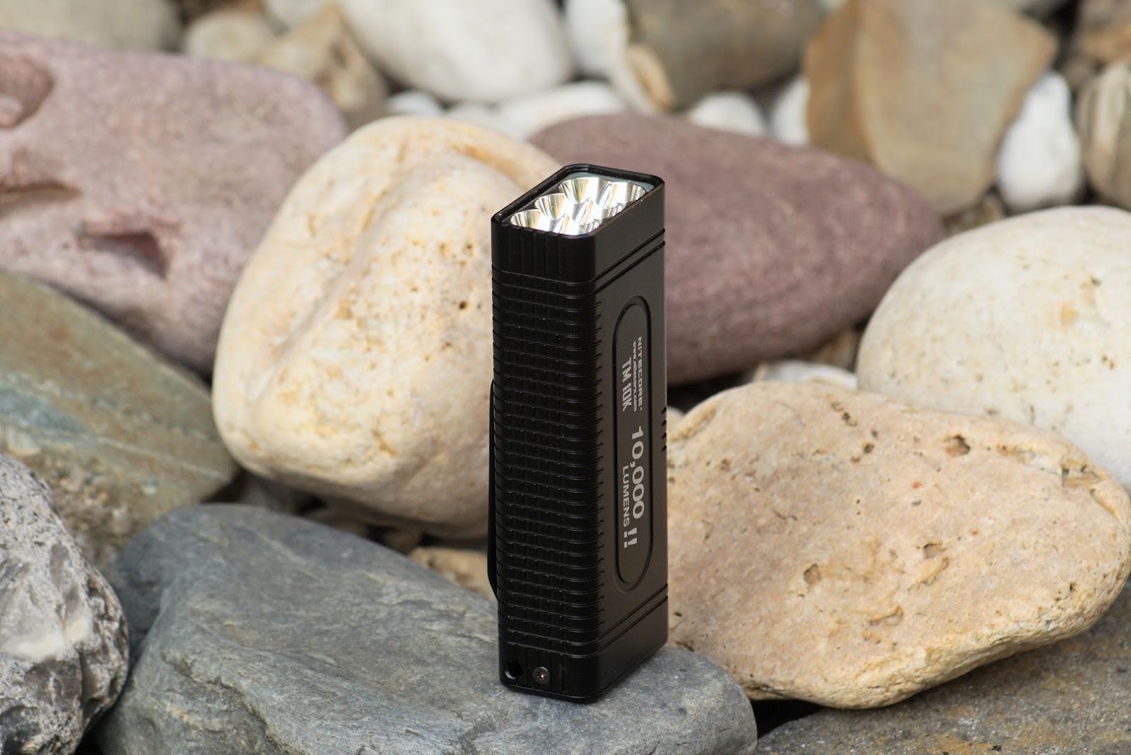

    stable standing on each side

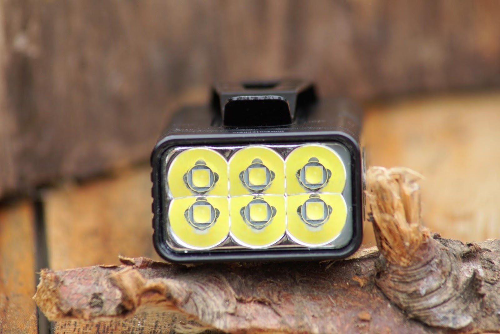

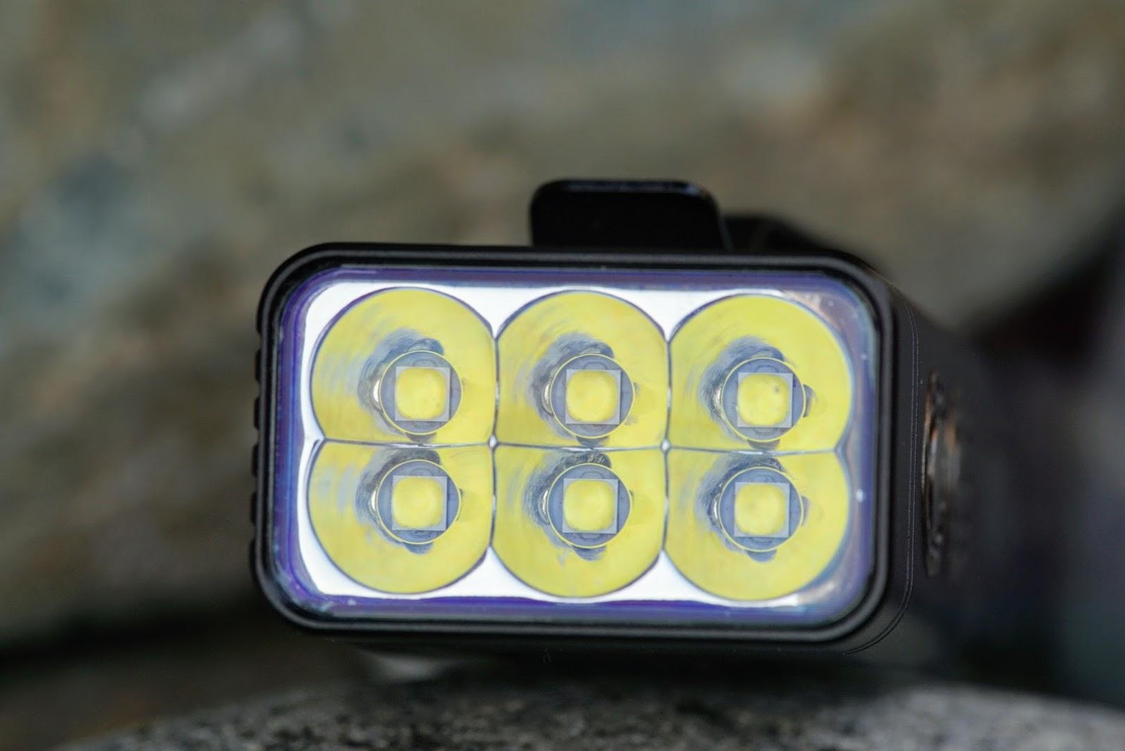

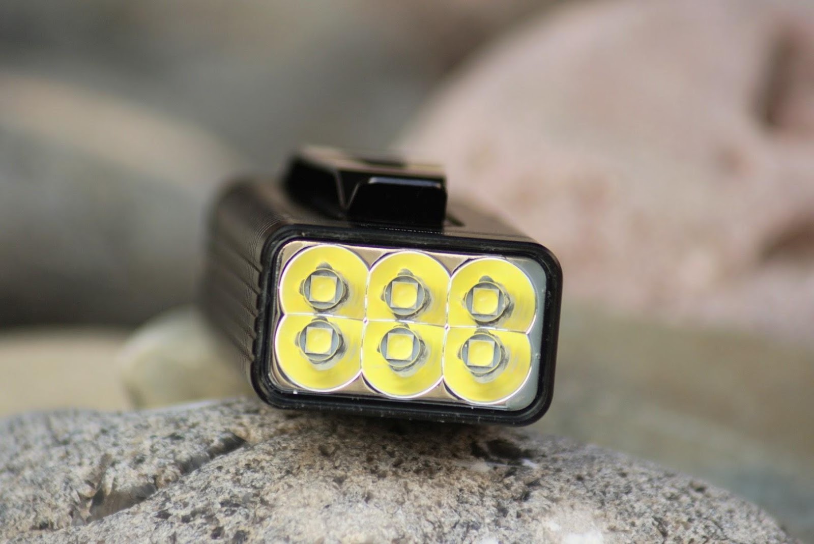

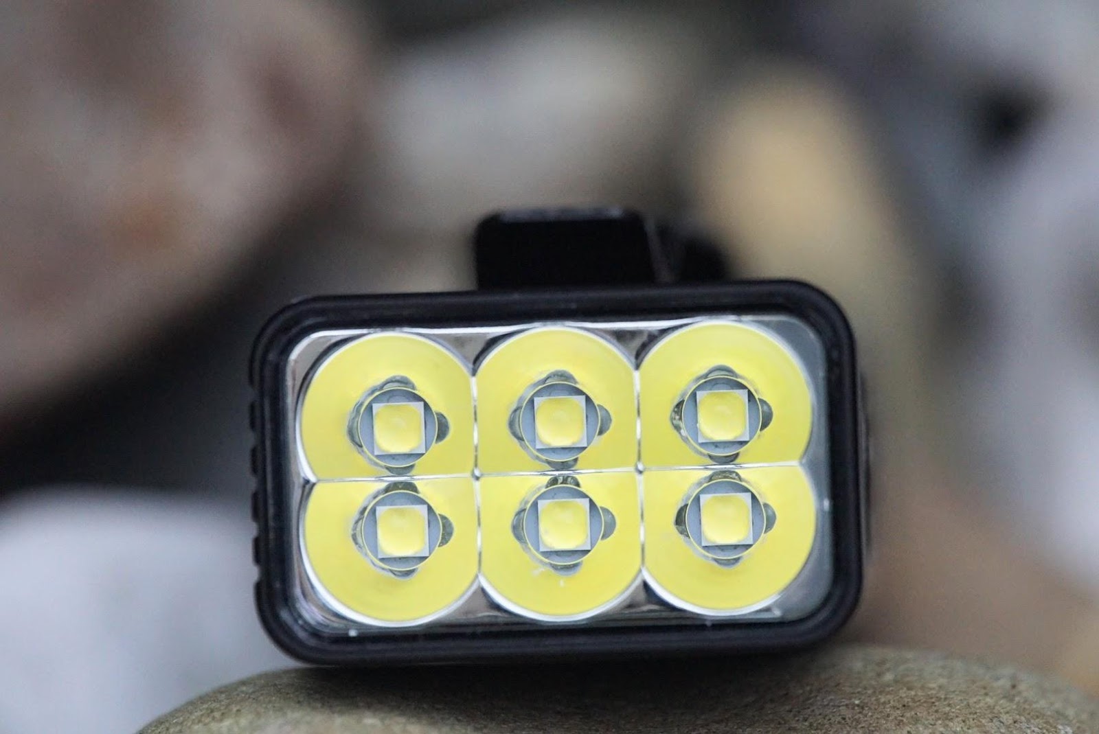

    six powerful XHP35 HD leds close to each other

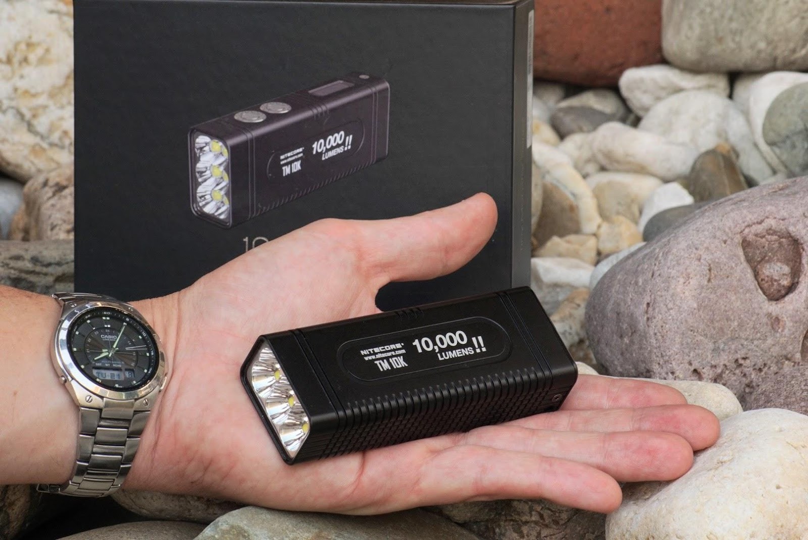

    in a hands’ palm you can see how compact the TM10K is

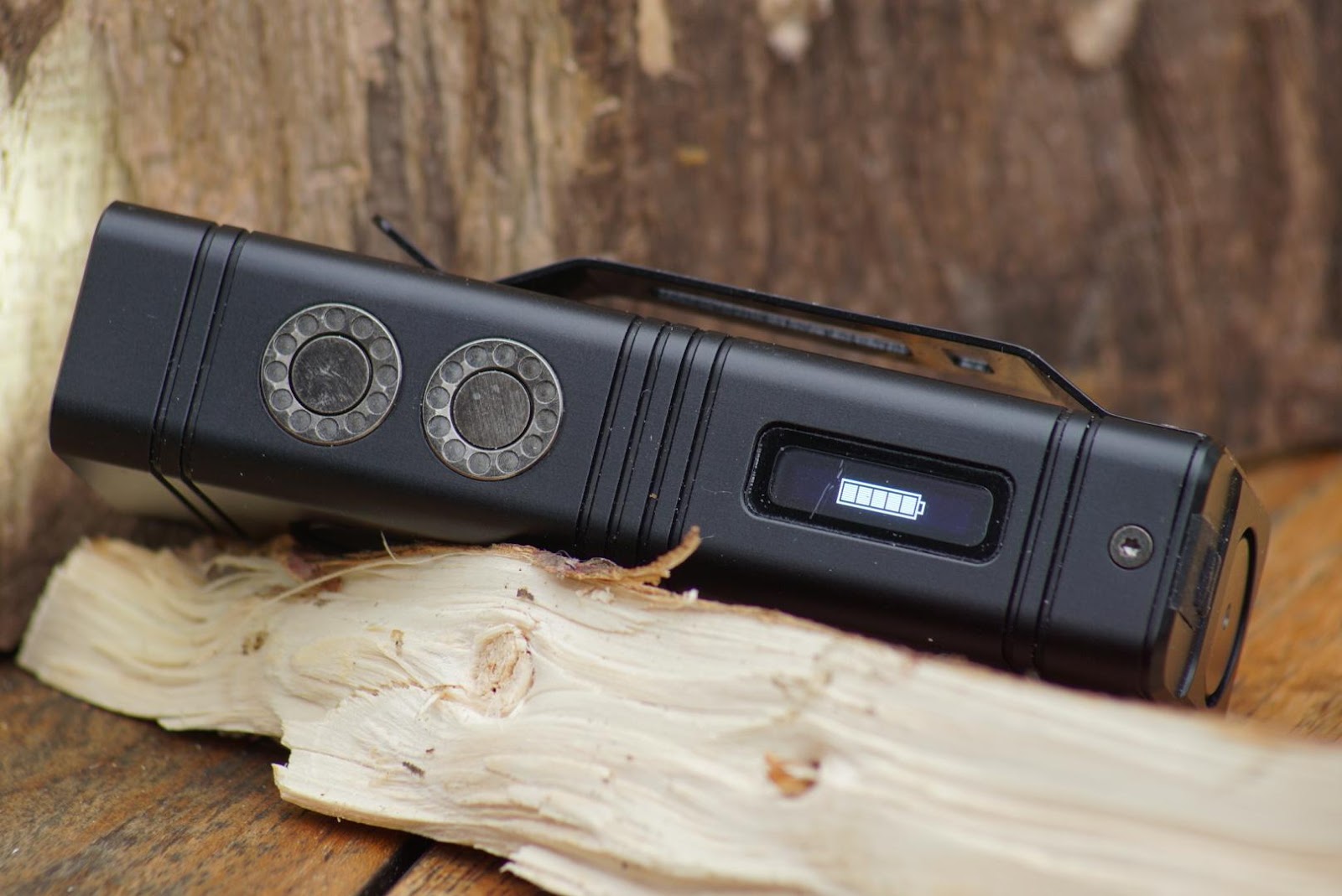

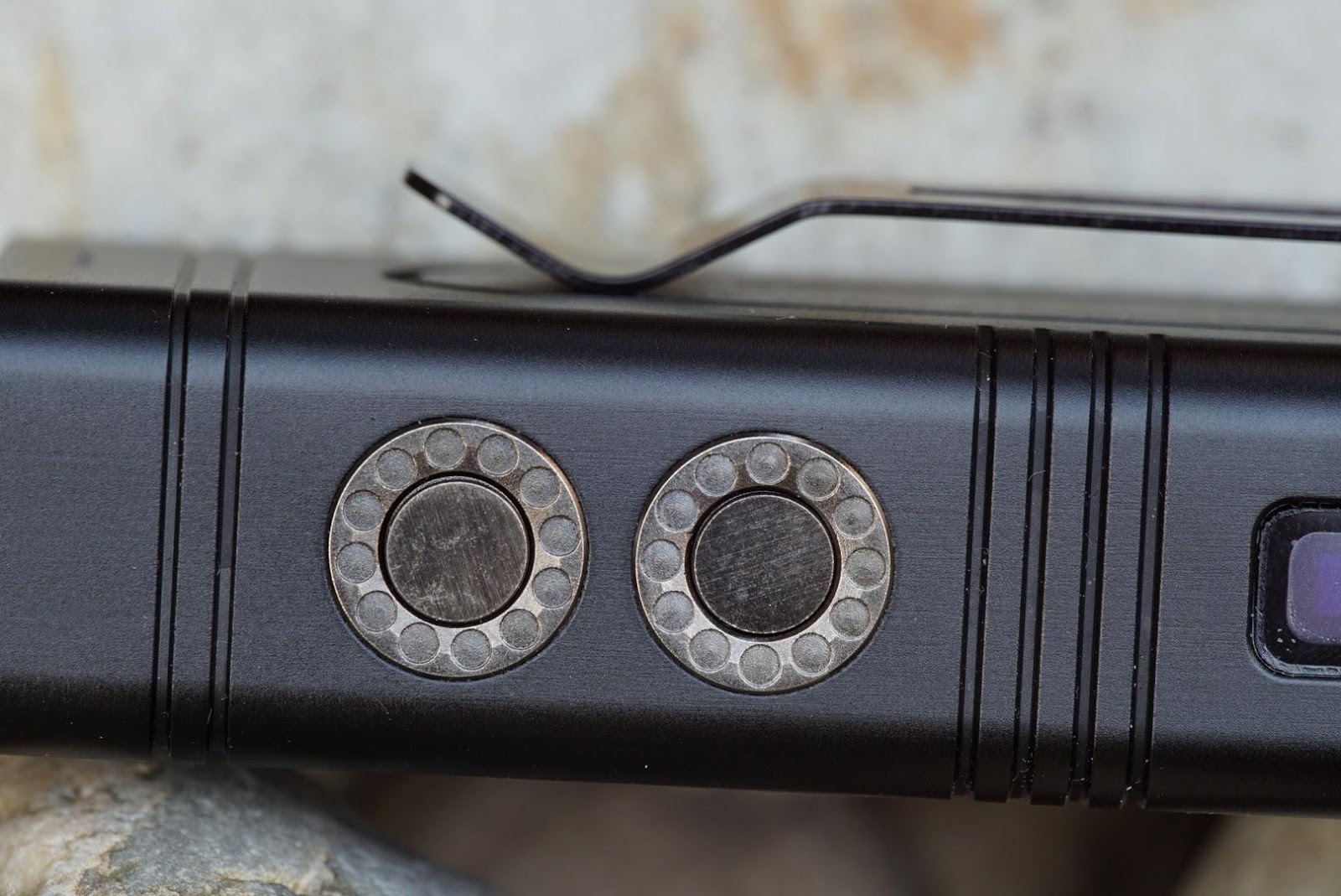

    nice metal switches with titanium looks

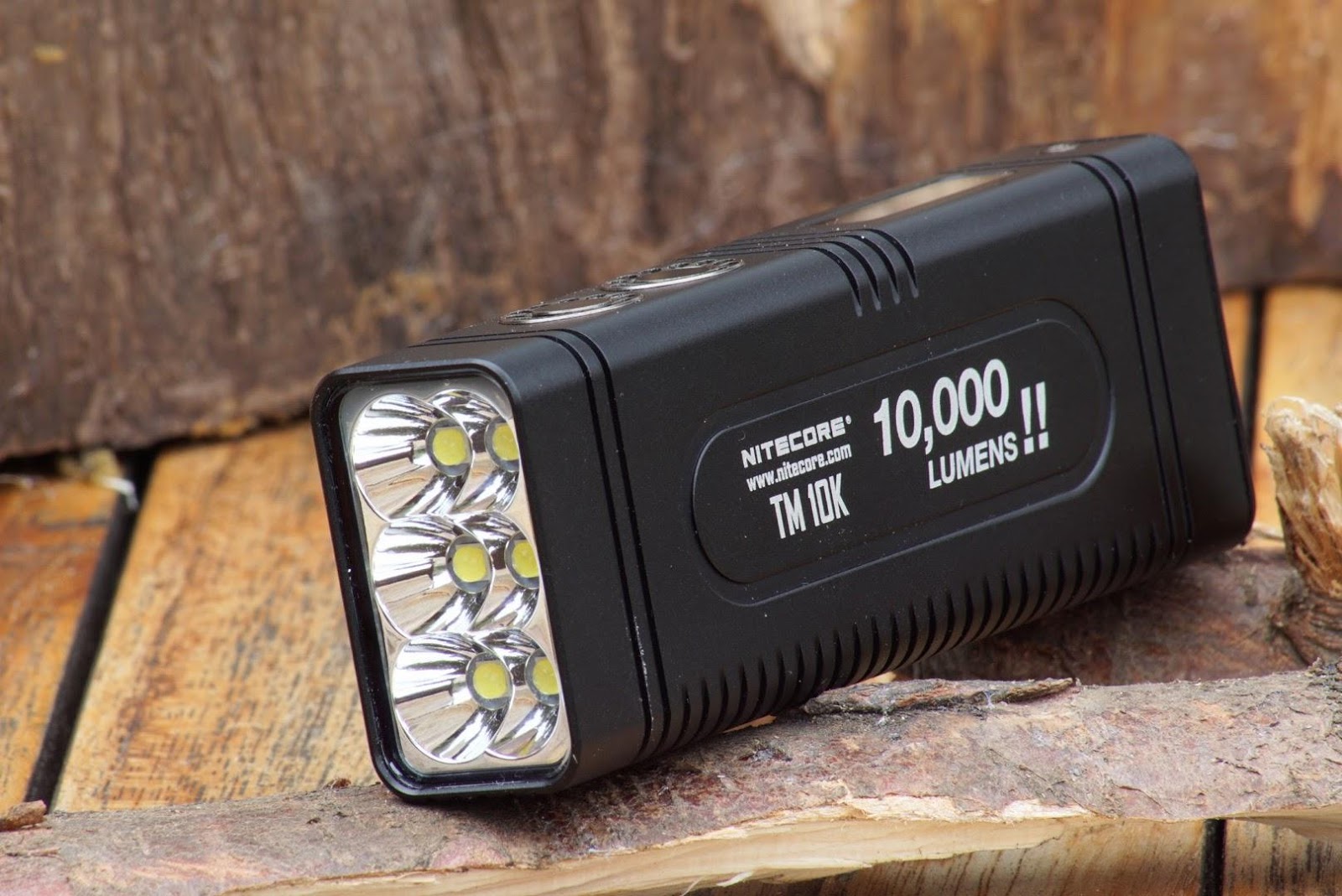

    you can’t miss the maximum output of the TM10K..
    shallow reflectors, so we can expect a floody beam

    the informative screen gives all information you need
    the LEDS are well-centered

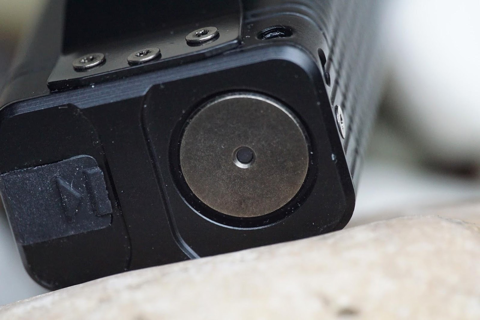

    the tail switch has an indicator built-in

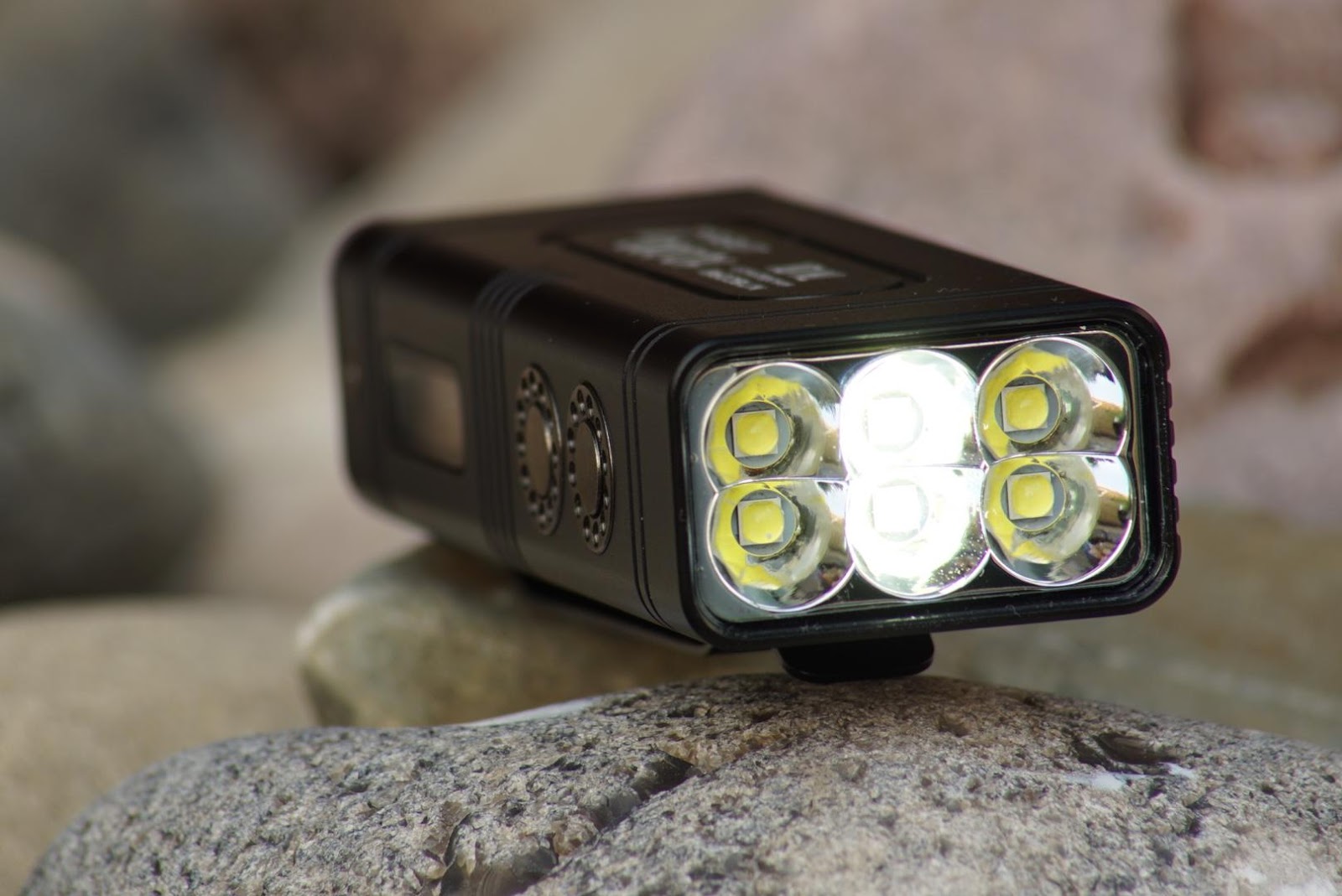

    in ultralow-mode only the middle LEDS will light up

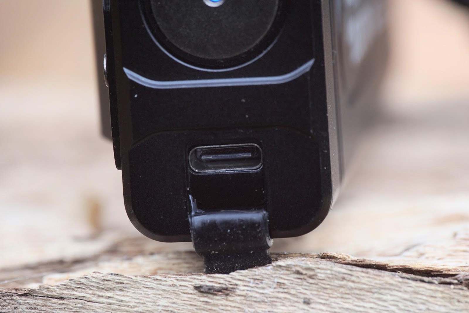

    a close-up the the USB-C port

    the indicator in action

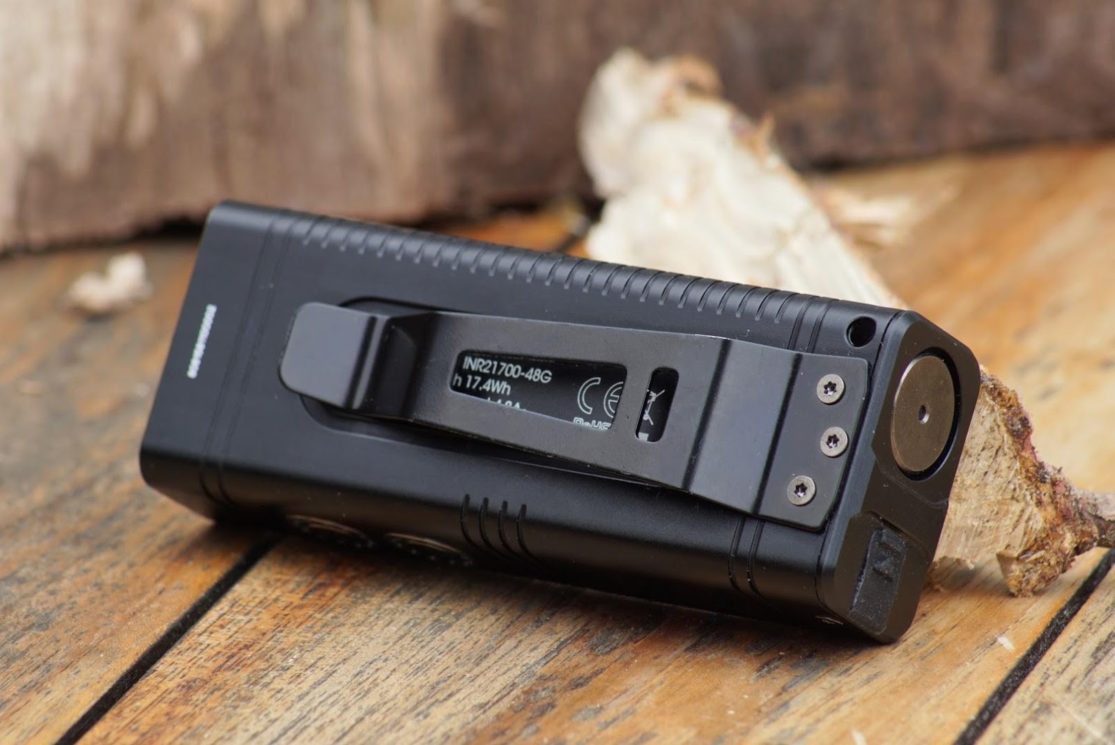

    thanks to the big clip you can attach the TM10K almost everywhere

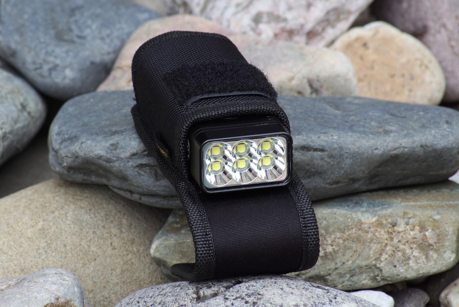

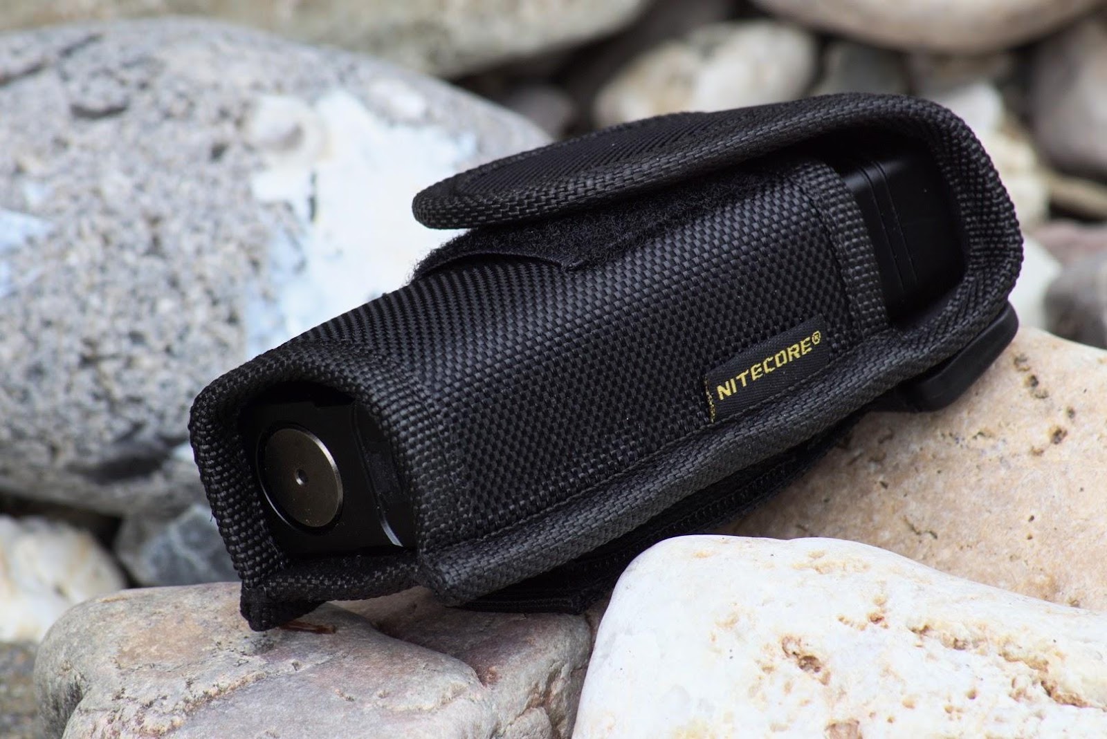

    the TM10K in the pouch
    that closes perfectly

    As I showed you on the pictures, the TM10K is a very compact torch. It almost fits in your hands´ palm and it's not too heavy to carry in your coat or to clip it on to your clothing or luggage.The TM10K is not too bulky to have good grip on it and can fully be controlled by one hand.
    The TM10K is the first Nitecore flashlight that comes with a USB-port. Most of my actual chargers have micro-USB, so I must beware that I don’t lose the dedicated cable. Advantage of USB-C is that the charging job should be done much faster. In practice, fully charging the cell (from 2.9 volts to 4.2) took about 3.5 hours. In my eyes, manufacturers should supply also a good powersource, not only a cable. By the way, Nitecore refers in the manual that you need a Quick Charge adaptor. You can see this a the display, it will show Q-charge than. Charging within an hour by using a powerful source should be possible; In my collection, I couldn’t find such a charger, my maximum output rate is 2A. If you use a “slow” source, the screen only will show “charging”. During the charging, the informative screen shows the actual voltage and also a notification if the job is done. It takes some effort to recover the port with the rubber, but this a good point in my eyes because is will protect the port well.
    What I mentioned on the TM10K is that the metal side buttons really need a secure press to activate them. If you press “too soft”, you’ll hear a click but the TM10K won’t react. On the one hand, this is a good protection against accidental activation. Personally, I would like to have a clearer pressure point on the switches.
    The TM10K has an informative screen, that gives you a lot of information. In standby, you can check the actual voltage by clicking the mode button. If you turn on the TM10K, the display shows consecutively the lumens and level, current voltage, battery symbol, remaining runtime and the actual body temperature. After that, the screen goes off until you choose another level or when you turn off and again on. Also information about lock-out, charging, beacon mode and a “7-seconds-bar” is displayed on this screen. I’m happy to have to information on a flashlight and would like to have such a screen on more flashlights.

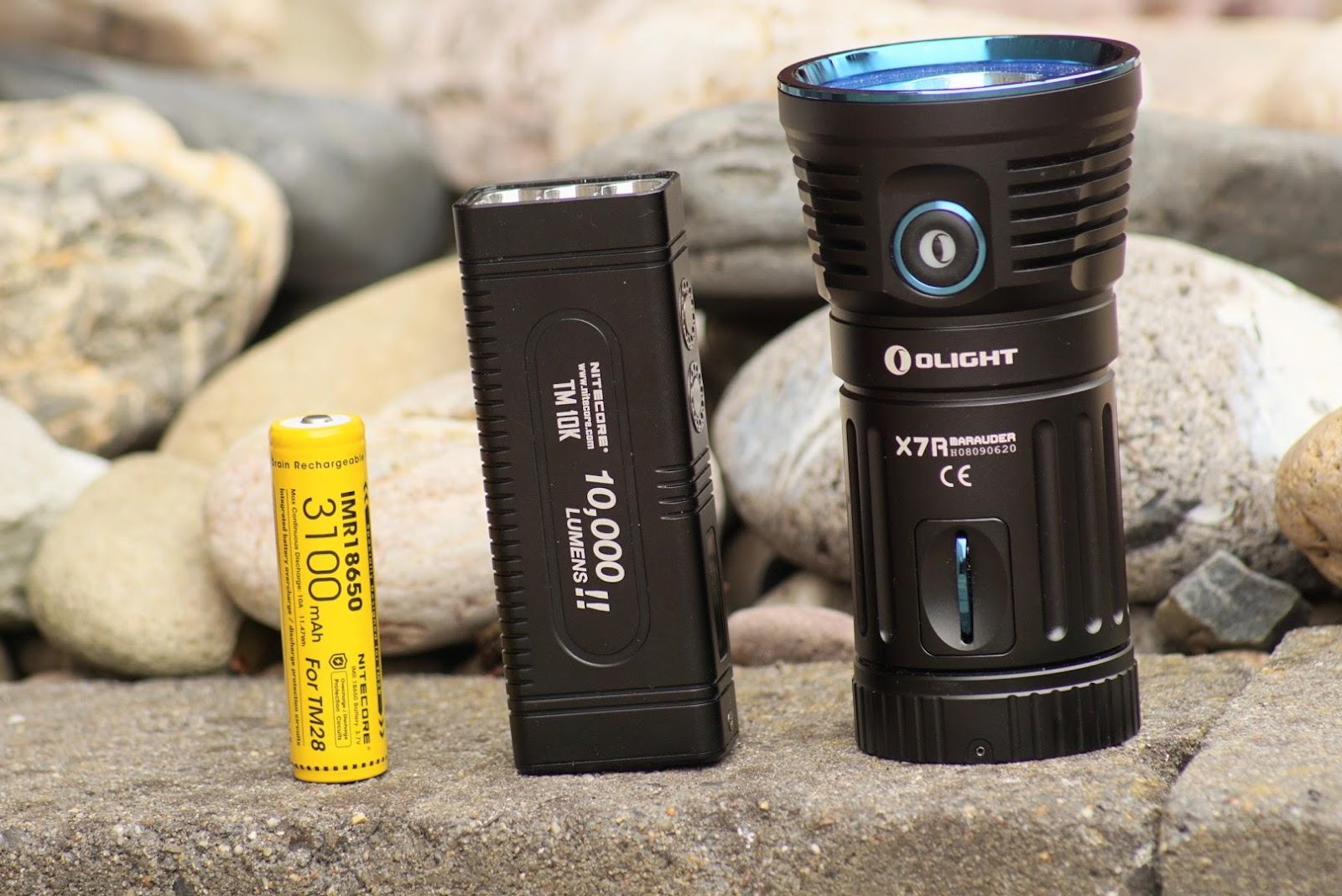

    Size comparison:

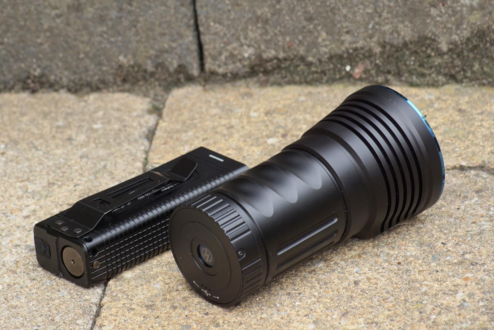

    For comparison, a picked a larger light this time. This torch has also a “five digits”-output, but uses different leds. Despite of that, I found it interesting to compare both lights. Next to the Olight X7R Marauder you can see again how compact the TM10K is. Later in this review, we’ll see both lights back in the beamshots-chapter!
    18650-cell, Nitecore TM10K and Olight X7R Marauder

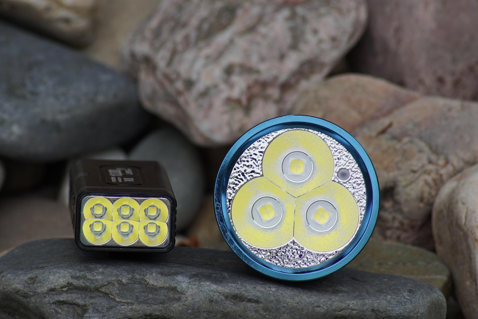

    the heads: six XHP35 HD’s and three XHP70’s
    the backs: Nitecore TM10K and Olight X7R Marauder

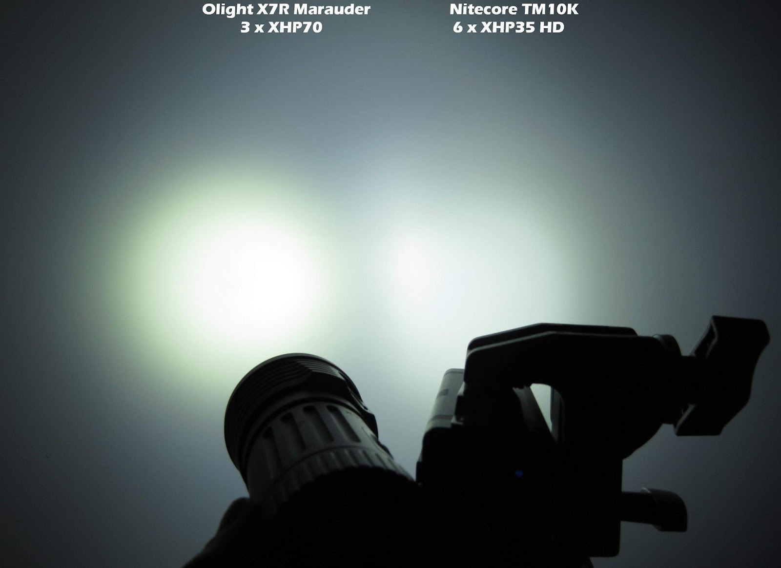

    The TM10K has, like most flashlights, a cool-white tint which you can clearly see if we project the beam on a white wall. Next to the Olight X7R you can see the tint of the TM10K has less green than the Olight. For a cool-white tint, it’s good to me; a neutral option would be nice for some users.

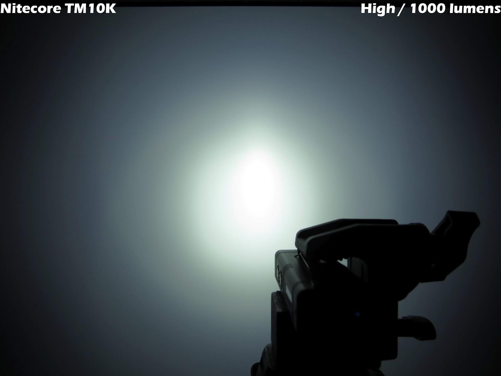

    Beamprofile:
    Six HD-leds in undeep reflectors will create a floody beam. That’s what the TM10K has. A broad hotspot, a big corona and medium spill. The TM10K creates a wall of light up to 75-100 meters in high and turbo mode. Nitecore added a good low to the light, (which is a good feature) by a nice find: Only the middle leds will turn on in the 3-lumens mode, this is really innovative! No donut-hole visible in the beam, neither artefacts or PWM. No comments further here.
    Highest time to have a look at one of the main-things of a flashlight: the output. Starting indoors, like always, by pointing the TM10K to a white wall in a dark room. I’ll show you the five output-modes here with the light on factory settings. The distance to the wall is about one meter.
    Camera settings: ISO100, WB daylight, F/2.7, 1/125 sec, 35mm

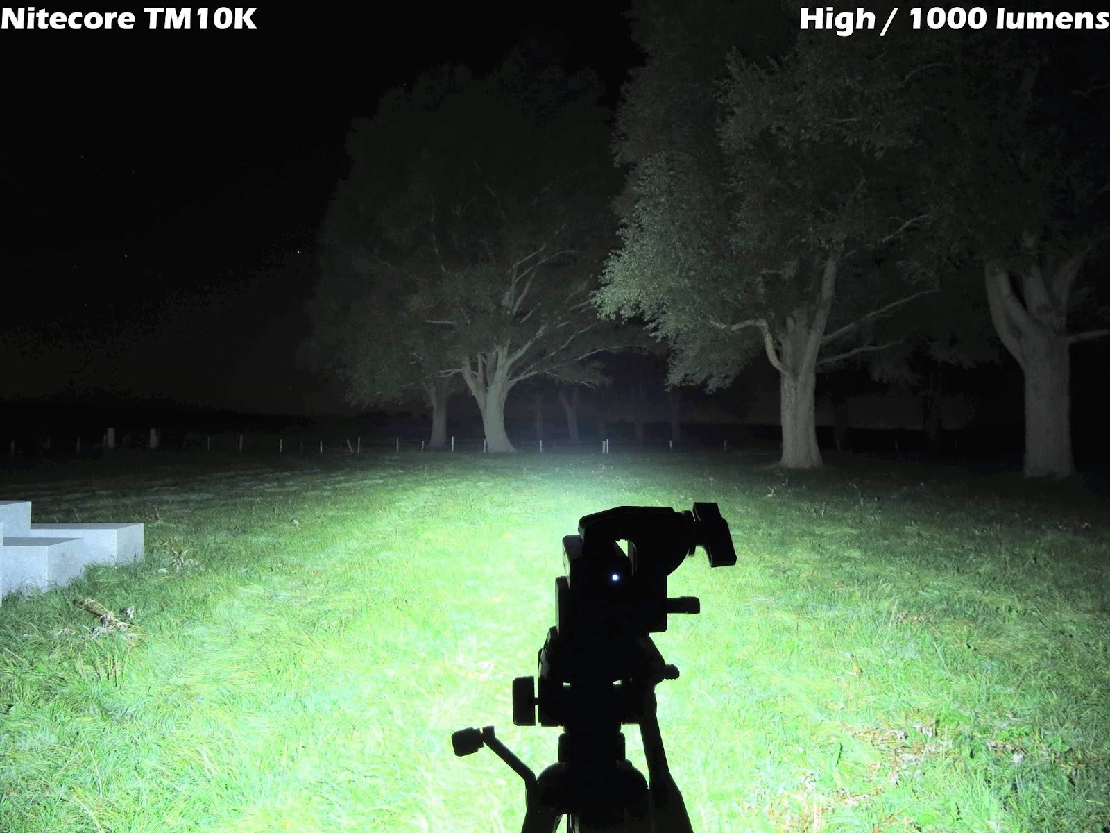

    How does the TM10K perform outdoors? Highest time to have a look at that! I took the light with me to a grass field near to a river with a couple of big trees at about 50 meters away. Starting by showing the five levels with high-mode on factory setting; after that a GIF.
    Camera settings: ISO100, WB daylight, F/2.7, 4 sec, 35mm
