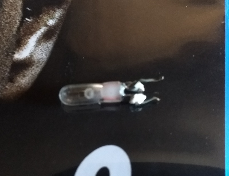

    Default Re: Buying incan bulbs is so tedious.
    Yes, you can user service a P60 but it has to be pre-cut bi-pin bulbs so that one of the pins is long enough reach the outter portion of the module.
    Tads bulbs are nicely pre-cut and so are the Streamlight TL-2 bulbs.
    But yeah, if you have a burnt P60 carefully take it apart and you'll see how easy it is to service.
    A burnt SureFire bulb
