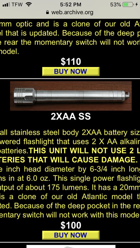

Just looked at that thanks arch.im really liking peak lights surprised that threads here are dead.

So I really love my Peak Pamir. It's a pretty big 2XAA twisty that could probably be used as a hammer with no ill effect. But it's kinda old school so wasn't expecting to much in the output and runtime department.it puts out about 150-175 lumens on fresh alkaline batteries and has a wide beam great for walking and using on trails or in the house. Well I did a runtime test with A couple of Duracell primaries and it took a nose dive at 2-2 1/2 hours down to 30 lumens or so which is still plenty to work with and figured if I got 2-3 more hours like that I would be happy. Well it's been running like that somewhere between 20-30 lumens for 23 hours! Really did I not expect that at all. I can tell you one thing now that I know it has some decent runtimes and built as it is I will definitely be putting one of them in my BOB.

Hmmmm . . .
I don't see that listed
AT ALL on their website !
:thinking:

Ya you won't. think they stopped making then in 06 or 07. That's why I say old school. The beam is NOT pretty on them. In fact you can see the LED diode on a wall out to 8 feet or so. Past that and you have a nice round floodlight. An as I say this is seriously the heaviest and best build light I have and to be able to run for "now it's at 25 hours" on a set of AA batteries is kinda amazing.

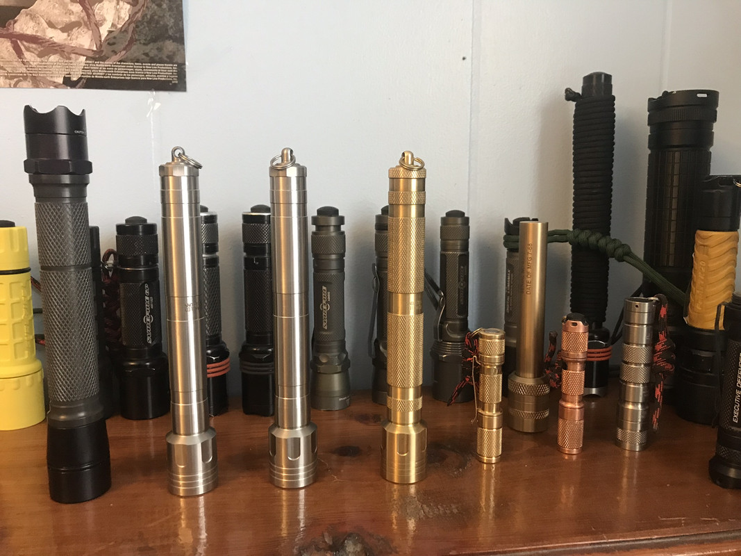

That's them right there
Now at 42 hours and still pumping out 3 lumens or so. Your not going to see more then 5 feet with it in complete darkness but in a tent or small room it is still very useful.im going to let her go to the 48 hour mark and check battery voltage as 48 hours off of a couple easy to find cheap AA I think is more then Acceptable in just about any situation. Got to say very impressed.

So pulled the plug at 46 hours. Was still putting out 3-4 lumens and could see in pitch dark if needed. Batteries were at .750 and .450! She's a battery vampire for sure.

Peak uses a quite interesting driver ... not the flattest regulation, but efficient and it never saw a cell it couldn't squeeze out a few more photons from (lol)

Well whatever there using it seems geared to long output. Combined with the build quality I'd say they are a pretty dam good light.
