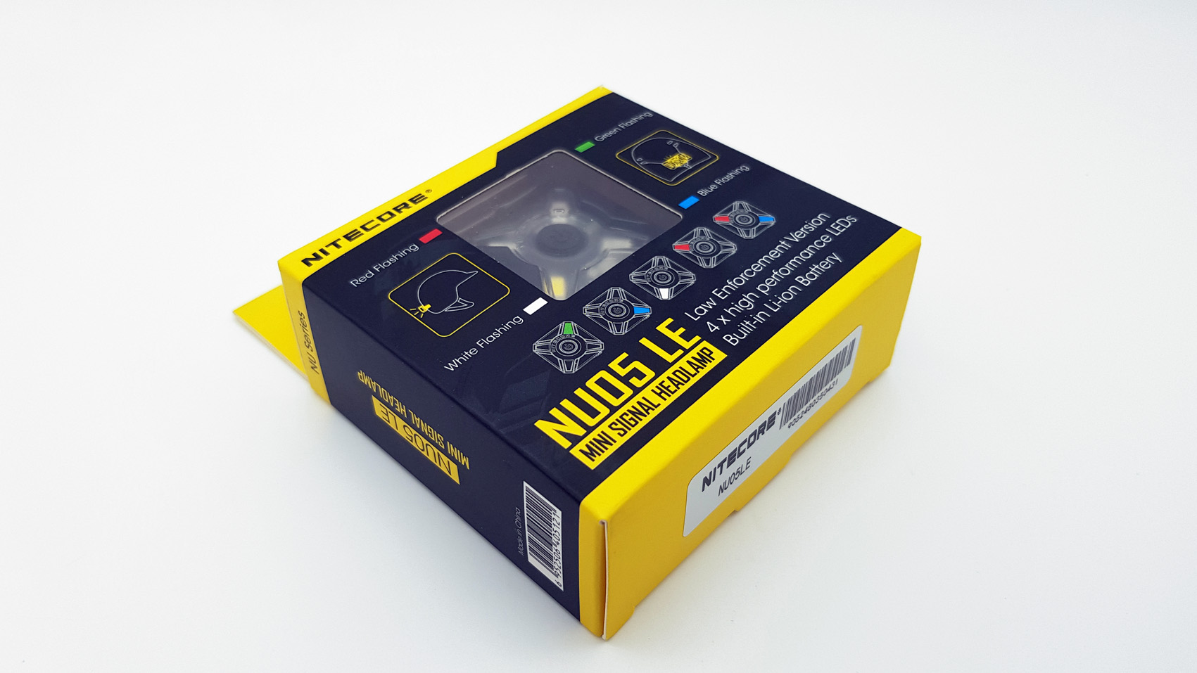

The packaging:
The Nitecore NU05 LE is sold in a cardboard box in the classic yellow / black colors of Nitecore.
On the front and back we find the main features that distinguish it.
Inside the package we find:
Nitecore NU05
Micro-USB cable
Support
Warranty certificate
Multilingual manual
