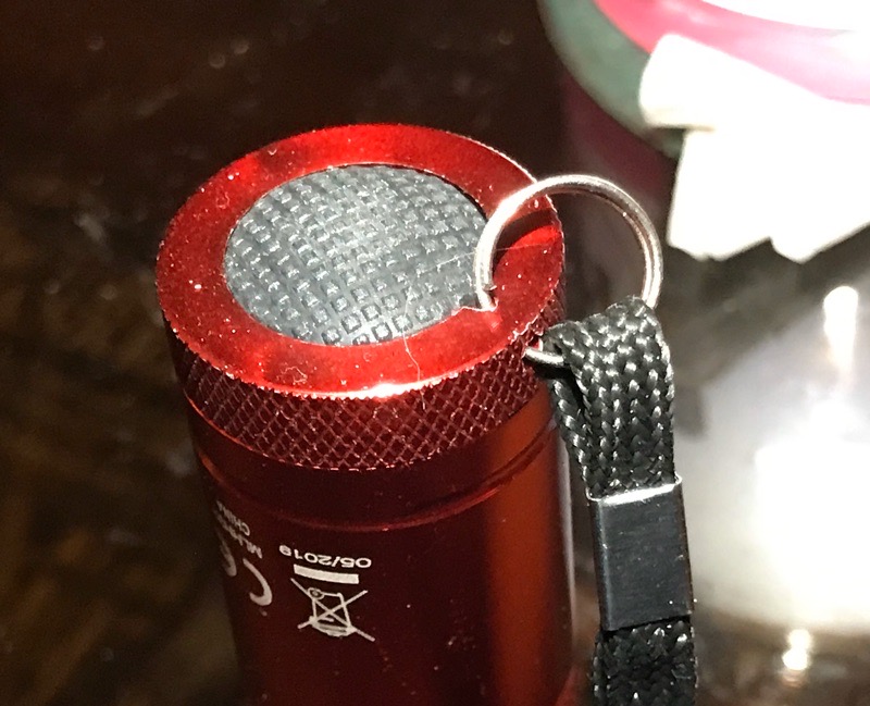

    I tried making a lanyard by putting a constrictor knot around the barrel and it works awhile but it slides off the end after putting the light in and out of my pocket a bunch of times.

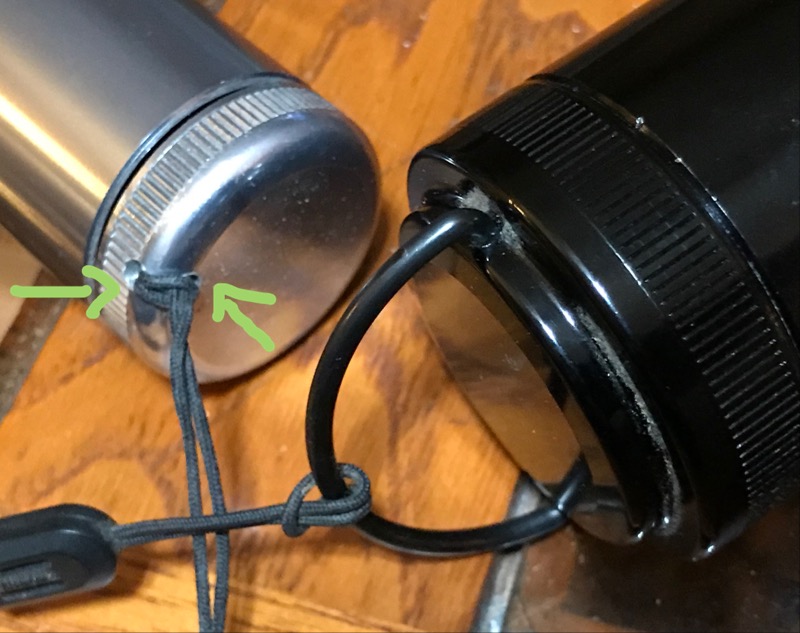

    Two ways I know of, one I did myself and other I may try some day.
    1) Drill 1/8" hole at 1/8" deep at a right angle to the light. Drill another straight down to end up with an L shaped hole.
    Feed cord into the L and pull it out of the hole with a dental pick or other small pointy object.
    2) Drill a small hole on opposite sides of the cap and install a D clip.
    Here's what I mean.
    Left is what I did and it is still sealed.
    Right was what Maglite did several years ago and it can be done again if you keep the hole shallow (say 1/8").
    Here's what I mean.
