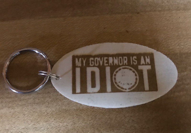

    The Va seal didn't turn out so great.
    I appreciate what you're saying IP. It makes a lot of sense after I read it a few times. It also opens my eyes to the potential of these machines. Mirror etching? Multiple levels? Good grief. Sounds like fun times ahead. I've been looking at kits to build with open source ability and upgradable parts. Fitting for a CPF'r to build one then upgrade it later, right?
