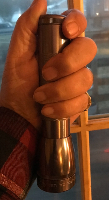

    There is definite flop on the 2nd gen ML25 after turning it about a half turn or more that I do not have on my first gen. When twisting the head off the 2nd gen it puts up a lot less resistance as well. Maglite used a thinner diameter o'ring for the gen 2.

    If I shake it, yes it rattles some, yes. The one in the photo. My other gen 2 are hit and miss for that. I have a few.

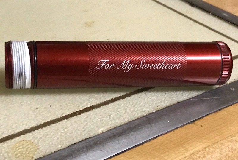

    For kicks and giggles I tried wrapping telfon tape 2 wraps thick just now on the red one in the photo above and wobble is completely gone. Neeeeeeat!!
    Everybody should have at least one roll of teflon tape (plumbers tape) in their home along with kite string and duct tape. So if you don't it's time to head to a hardware store and solve that issue……

    bykfixer, did you wrap the entire threaded section with the teflon tape? Was the turning operation still smooth? Did you add lube on top of the teflon tape?
  17. #467
    Default Re: Will I turn into a Maglite fan once again?
    Two wraps the width of the tape. Operation feels like the gray one in the photo above. No lube.
    The flashlight was a St Valentine gift to Mrs Fixer.
