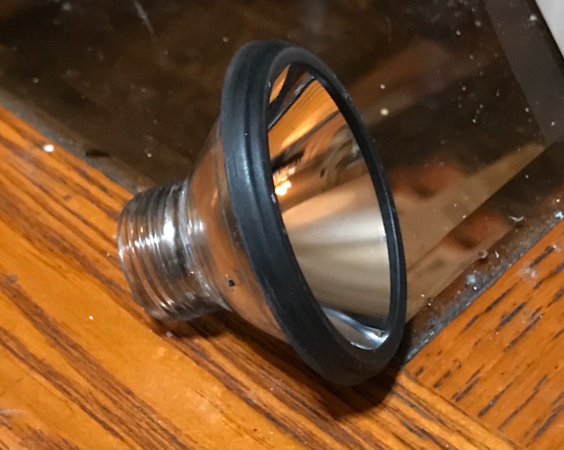

    Thanks for the info regarding my recent code 4 purchase, but I’m still a bit confused. Can anyone verify the diameter of the code 4 lens, and wether there should be a gasket in front of the lens, as in a maglite, or does the lens just push directly against the bezel/ face cap with no rubber seal?
    Default Re: Code 4
    The reflector has a gasket surrounding it.
    A Code 4 reflector with surrounding gasket.
    A reflector from a mid size Kel Lite head will work. The gasket is extra. So will reflectors from D sized Bright Star, Fulton's, Homart's, Hipco's, Tru Value, Ranger, Burgess, and some other chrome flashlights from the 1950's to the 1980's. A whole bunch of companies bought their reflectors from Bright Star. Eveready and Rayovac do not work as they have a proprietary reflector.

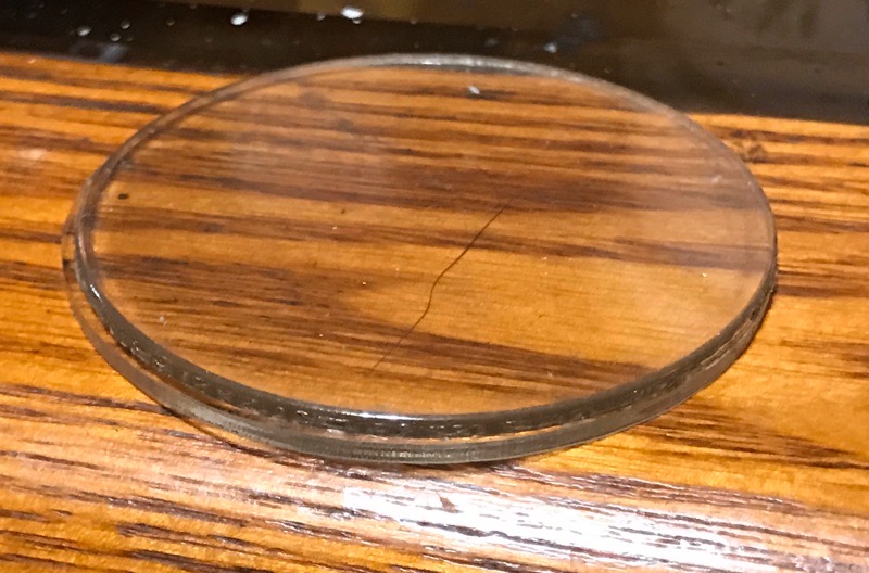

    Top is a Code 4 lens. Below is a Maglite lens
    The lens is about 51.5mm. A 52.1 Maglite reflector will work. In about 1972 or 73 Kel Lite made a mid size head that ended up being the standard size for numerous flashlights including Tru-Grit, Bianchi, Maglite, Streamlight and LA Screw.

    Thanks bykfixer. Yes I have the gasket that surrounds the reflector. The lens sits on that and then the reflector and lens are fitted into the face cap. But.. does the lens make direct contact with the metal of the face cap; in a maglite for example, there’s an o ring in there.

    My Code 4 does not have a gasket or o'ring between the lens and bezel.

    That’s interesting bykfixer. You wouldn’t think it was 100 foot waterproof like that, but obviously the plastic lens seals itself. Funny that a maglite has a seal there, AND lower down on the face cap, neither of which a code 4 has, yet is not waterproof?!
    Well I’ve made some good progress today! Replaced the missing tube seal with an o ring. Cleaned the 3 remaining seals in isopropyl alcohol, then soaked them in pellgun oil and refitted. Found a spare maglite lens and fitted that; the one supplied was 49.3 mm!
    New batteries, turned on .. nothing! Noticed that it would light if I removed the top body seal. Eventually repositioned the two adjustable ‘ears’ on the top copper contact in the head and works now.
