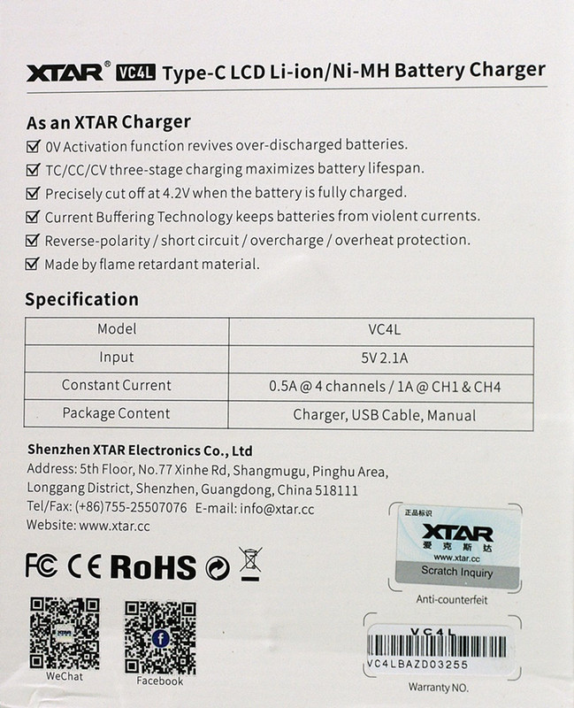

What can I say about the VC4L . Well it works , it does the TC CC CV stages of charging :
TC = Trickle Charge
CC = Constant current
CV = Constant Voltage

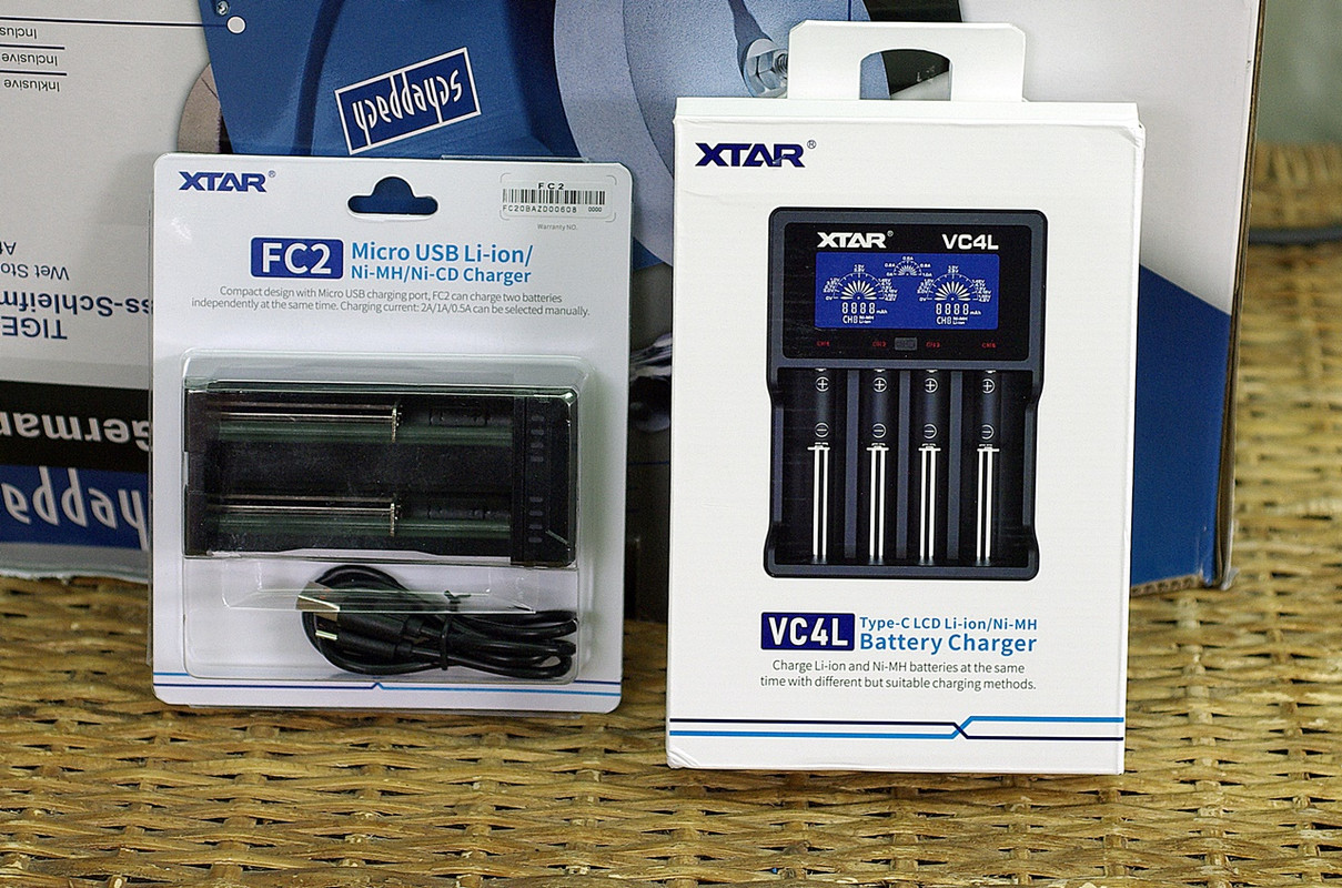

AA / AAA batteries - The VC4L does charge a little harder than the FC2 charger I recently tested and bye that I mean my AA batteries were some 5 degrees warmer on average . This sort of tells me that the VC4 is pushing a little more against the internal resistance . ( Charging the batteries a little more )
18650 batteries - Same as the AA , resting voltage was consistently 0.1 to 0.2 volts higher than the FC2 charger . I did not notice the 18650 getting any warmer than with the FC2 charger , but I did notice the consistently higher voltage after being charged . This means that the VC4L is putting in more charge consistently , across a range of batteries .
What I did not like - When the batteries have completed their charge cycle and you remove them . You really ( perhaps ) should not . Because if you remove the two inner most batteries and leave the outer batteries , the charge rate will change . So if you don't want to charge your little ( small capacity ) batteries at 1A , you best leave the batteries in place until all are charged . Yeah , I did this one night ! It was late , I had things to do and I removed the batteries at completion and my last two AAA came of the charger seriously hot . ( I was cooking them at 1A ) It was late and I was not thinking - just doing ! This could be problematic if you forget about this function ( as I did ) . Ch1 & Ch4 being 1A , till you add a battery to Ch2 or Ch3 .. ( Ch2 and Ch3 being 0.5A ) .
A bit of brain fade on my part for sure , but it was just too easy to do . I love the build quality , I like the charger overall and the automatic charge rate is something that needs to be treated carefully , especially with small batteries . I think the VC4L is an excellent 18650 and larger battery charger , but when it comes to those smaller cells I would really like to see a smaller charge rate and manual charge rate selection . I am still waiting for a low current charger . I would be tickled pink if Xtar did a 100 / 200 / 500 mAh charger . That would be amazing . ( 4 bay )

It's good that this charger can take protected 21700 cells, but the charging current is too low. Charging a fully discharged 5 Ah 21700 @ 1A takes close to 6 hours. Why didn't they use the PD capabilities of the USB-C interface? This would have allowed at least two slots to run at 2 A. And 4 slots @ 0.5 A is waaaay too slow, even for 18650.
