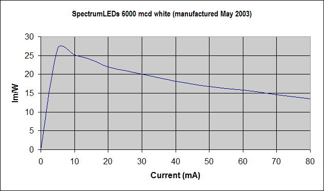

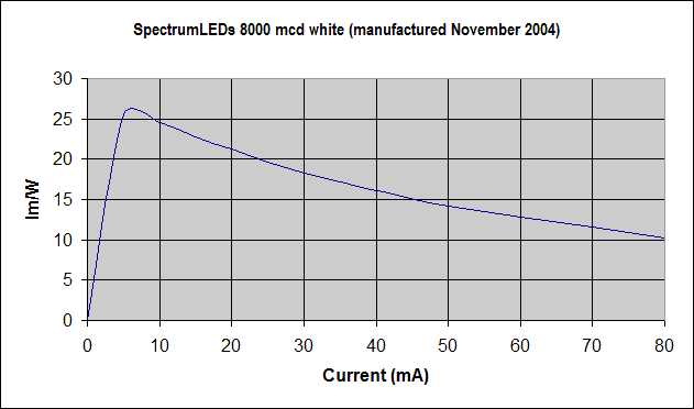

    Having acquired quite a few different types of white LEDs over the last two years I've long wanted to see how they stacked up against each other. To that end, and since summer is traditionally my season for indoor projects, I ran a slew of tests. Besides the usual intensity and Vf measurements, I also built a device to enable me to estimate lumen output:
    I made a cradle to hold my light meter out of silicon rubber for consistency of measurements. An old CD serves as the dial to rotate the LED. Starting at 0°, I first position the LED so that the light meter reading is as high as I can get it in order to obtain a hot spot reading. This is important because the relative value of all the other measurements to the highest reading is what will ultimately determine the accuracy. I record the reading, and then rotate the dial in 5° increments all the way to 180°, recording all the light meter readings. A few times during the test I block off the LED in order to obtain a background reading which needs to be subtracted from all the readings. The value is usually 0.1 to 0.2 lux, and while it may not sound like much, at the 17.5" distance between the LED and light meter it can affect the final result by as much as half a lumen.
    After I obtain my results on the test jig running the LED at 20 mA I then take lux readings of the LED at one meter at different currents using the constant current source with the thumbwheel switches to change the current. I also record the LED's Vf. I then plug all the data into an Excel spreadsheet made for that particular LED and come up with the final results. Here is a .zip file containing all my spreadsheets so far for anyone who wants to see how I do my calculations.
    This post contains my results for low-power LEDs. For those interested in power LEDs, I collected all of my power LED test results in this post.

    SpectrumLEDs (noshankyhank at time of purchase) 6,000 mcd, 30° 5mm white (purchased May 2003)
    The first white LED I purchased on eBay. Very blue tint.

    SpectrumLEDs 8,000 mcd 20° 5 mm white (purchased November 2004)
    Decent color but very dim for a late 2004 LED, seemed to degrade rapidly even at 20 mA.

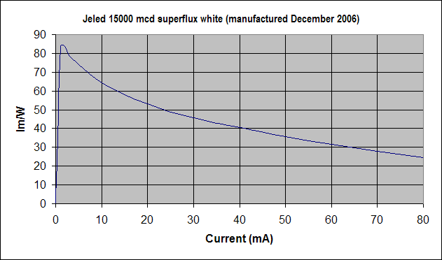

    Jeled 15,000 mcd 140° superflux white (acquired January 2007)
    This is the fourth of four different types of LEDs sent to me by CPF member TMorita for testing. I only tested one of the three samples since the other two appeared very similar in output. The result was 2.9 cd and 3.46 lumens at 20 mA. Beam angle was 60.6°. Vf was 3.26V and overall efficiency was 53.1 lm/W. Color was very blue, perhaps as high as 9000K, and the beam was very smooth. Of course, these figures are nowhere near the claimed output of 15,000 mcd and a 140° beam angle. However, consider that an LED with those specs would have a total output of around 70 lumens so I wasn't expecting this part to meet specs. If it did, it would have had an efficiency in the 1000 lm/W area which would be physically impossible! Overall this is a decent LED which should give long life owing to the superior heat dissipation of the superflux or pirahna package.

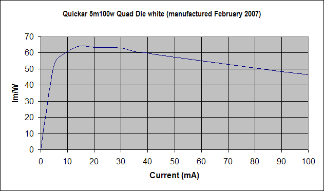

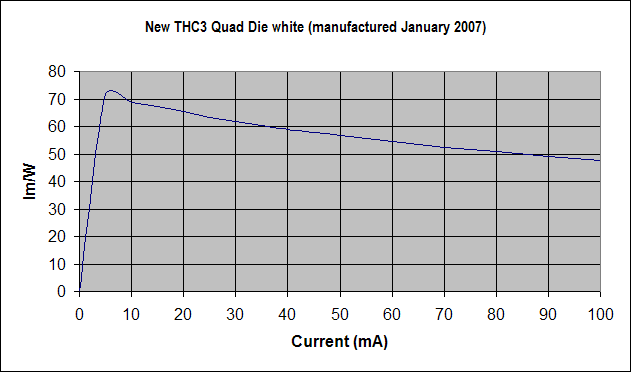

    New LS Diodes THC3 4-die 5mm white (acquired February 2007)
    CPF member milkyspit sent me a new THC3 and a Quickar 5m100w for comparison testing. The beam is very smooth and white, coming in at about 6500K. Half-intensity beam angle is fairly wide at 29.4° so the intensity is only 6,400 mcd at 20 mA. Efficiency at 20 mA is 65.5 lm/W, a little lower than the original THC3 which was 72.8 lm/W. As with other 4-die LEDs this one does well at higher currents. Even at 100 mA efficiency is still a very decent 47.6 lm/W. As expected, forward voltage is very low compared to other 5mm whites since each die is only getting 1/4 of the current.
    Quickar 5m100w 4-die 5mm white (acquired February 2007)
    This LED is similar to, but less expensive than, the LS Diodes THC3. In a head-to-head comparison with the new THC3 it did very well. The beam is very smooth and white, quite similar to the THC3, and with a similar color temperature of roughly 6500K. Half-intensity beam angle is fairly wide at 33.9° so the intensity is a mere 5,600 mcd at 20 mA. Efficiency at 20 mA is 63.2 lm/W, a little lower than the new THC3. At 100 mA efficiency is a very decent 46.4 lm/W, just a hair under what the new THC3 does. Once again, forward voltage is very low compared to other 5mm whites since each die is only getting 1/4 of the current.

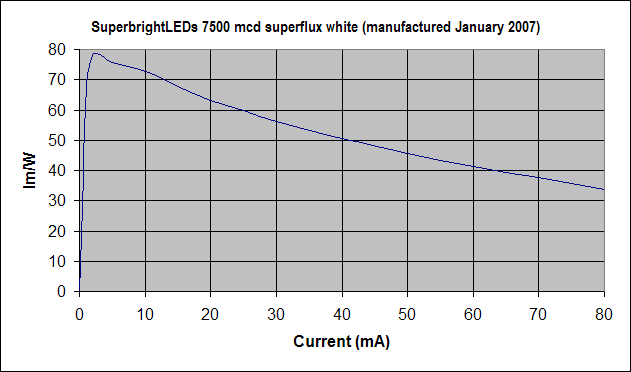

    SuperbrightLEDs 7,500 mcd 90° superflux (acquired February 2007)
    CPF member TMorita sent me this LED along with a bunch of others for testing. The result was 2,600 mcd and 3.83 lumens at 20 mA. Beam angle was 72.0°. Vf was a very low 3.04V and overall efficiency was a decent 63.0 lm/W. Color was pure white, about 6500K, and the beam was very smooth. This is a decent LED which should give long life owing to the superior heat dissipation of the superflux or pirahna package.

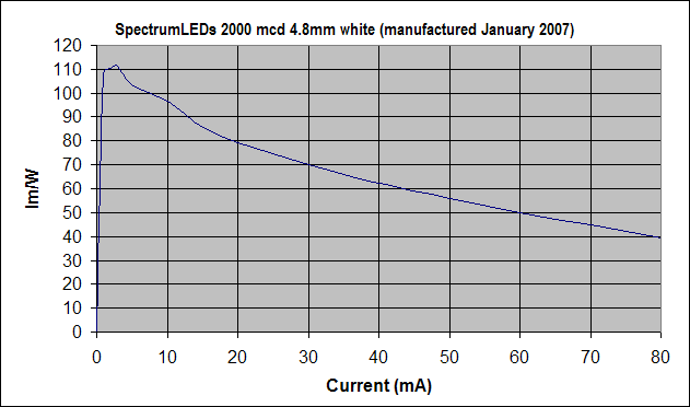

    SpectrumLEDs 2,000 to 4,000 mcd 180° 4.8mm white (acquired February 2007)
    TMorita sent me 3 samples of this LED for testing. These are the 4.8mm "top hat" package which is designed for area lighting applications. The results were 1.75, 1.84, and 1.81 cd at 20 mA, around the low end of the spec. Average beam angle was 105.6°. Color temperature was 6500K, which is pure white to most people. Even though the intensity was low because of the wide beam angle average efficiency of the three samples was an excellent 79.2 lm/W. Average output was 5.10 lumens, and average Vf was 3.22V. Consistency between samples was impressive-outputs were 5.06, 5.15, and 5.10 lumens. Overall these are great LEDs for any application required flood lighting, or perhaps to focus with a reflector.

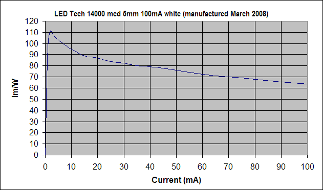

    LED Tech 14000 mcd 5mm 100 mA white (acquired March 2008)
    CPF member TMorita sent me 3 samples of this LED for testing. These are LED Tech's 100 mA whites which have a larger lead frame to allow operation at 100 mA, and probably also multiple dies. The results were 2.8, 2.8, and 3.2 cd at 20 mA. I assume the 14,000 mcd rating is at 100 mA, so the corresponding results at 100 mA are 11.0, 11.2, and 12.3. The average is 11.5 cd, somewhat below spec. Average beam angle was 77.1°, nearly equal to the specified 80°. Color temperature was around 7000K, and the beam was very smooth. Average efficiency of the three samples was a very decent 86.8 lm/W at 20 mA and an excellent 63.8 lm/W at 100 mA. These are better numbers than the very similar BestHongKong LEDs because they're apparently using better dies. Average output was 5.12 lumens at 20 mA, and average Vf was a low 2.95V (expected due to the multi-die construction). Corresponding figures at 100 mA were 20.06 lumens and 3.15V. Consistency between samples was OK-outputs were 4.71, 5.05, and 5.60 lumens at 20 mA. Output scales very well with current as expected (output at 100 mA is 3.92 times the output at 20 mA). Overall these appear to be a decent, well-constructed LED capable of sustained operation at higher currents.

    Here are the graphs for efficiency versus current:
    [/SIZE]
    Here is a series of head-to-head comparisons of all the LEDs for a number of different parameters:
    Note how there is more or less (with the exception of the SpectrumLEDs 8000 mcd white) a steady improvement in efficiency from 2003 until the present. Most of the LEDs clustered together in the efficiency graphs were purchased at roughly the same time.
