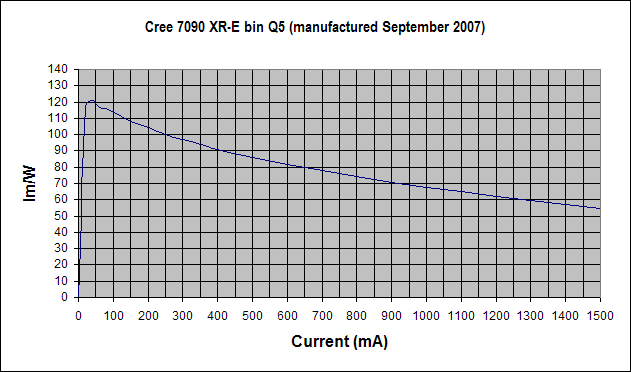

    *Flashaholic*
    Nov 2003
    Flushing, NY
    5,892
    Default Re: White LED lumen testing

    The P4s have 3 bond wires instead of 4. This and variation among chips probably account for it. I also noticed that the Cree warm white has a different colored phosphor (slightly more orange in color), although this has nothing to do with Vf.

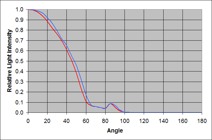

    The warm white XR-E has an interesting beam profile. Is the "step" visibly noticable? Is the warm white using the conformal phosphor coating like the cool whites?
    My Q4 XR-E has a higher Vf than my P4 did, even though it had 4 bond wires vs. 3 - Vf is influenced more by the individual die than by the number of bond wires. Some have noticed a trend that the Q4s and Q5s tend to have a higher Vf than lower binned XR-Es.
  25. #145
    Flashaholic* Erasmus's Avatar
    Dec 2004
    The step is slightly noticeable (it looks like a faint ring). The phosphor coating method looks very similar to the cool-whites, so yes, I would say it's conformally coated. I also noticed that my P4 warm white does have four bond wires, same as the Q5s.
    Possibly true. Another one of my Q5s tested slightly lower than the first one (103.77 lumens) but Vf was also lower (3.16V versus 3.20V), making efficiency nearly the same.
