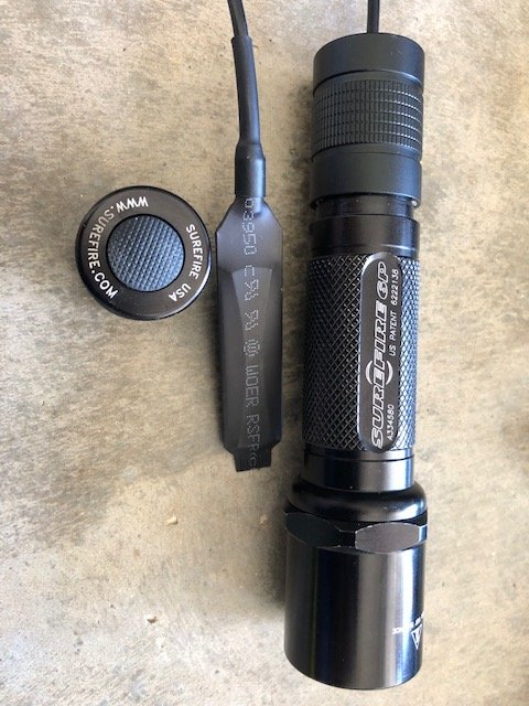

Going through some accessories in plastic bins and found my Surefire 6P Original. Hadn't been turned on in about two years, at least. I purchased one of those cheap Chinese remote switches to mount on my AR and it worked, too. Not a lot of lumens, obviously, but it proves these are rock solid lights. I probably got this one in 2004 or 2005 from and old Army buddy at Fort Hood, TX. Was going to sell but it's a keeper. Any recommendations on minor maintenance on these? Thanks.

You might not need to do this since it's been "protected" in a plastic bin, but you might want to consider unscrewing the head (bezel) and tailcap/switch assembly, cleaning the threads with a single-use alcohol pad, and then re-lubing the threads and o-rings with a silicone grease like Nyogel. If it's using an incan lamp assembly as the light engine, replacing the bulb with a quality led drop-in like one of the 6v Malkoff modules is going to let the batteries last a lot longer. Oh, and congratulations on finding a lost friend!

Thank you for the info. Will get on it ASAP. Is Nyogel available online only?

'Nyogel' and 'Lubri-film' are considered good, (and Malkoff carries it). Auto parts stores (and hardware stores?) tend to carry silicone grease, but I am not knowledgeable enough about different silicone greases to know what makes one better for flashlights, or whether the brand truly makes a major difference. I just know that Nyogel and Lubri-film are highly regarded by folks here, which is why I ordered some online awhile back. Hopefully someone more informed about silicone greases than I can weigh in here.
Edit: Sorry, one more nit-picking point. Black o-rings are made out of a synthetic rubber. If you come across red o-rings, they are usually made of silicone, and you shouldn't use silicone-based lubricants with those, because it will start to cause the silicone o-ring to 'break down' over time.

I looked for nyogel here in the uk and it was to rich for my blood so bought silicone grease from my local dive shop. I figured if it's good enough for O rings when scuba diving at the bottom of the sea it will be good enough for my flashlight that might experience the odd bit of rain.

I have a tube on Nyogel 760g for threads and a tube of Nyogel 7797Z for the O rings. I got them from Oveready back in the days when they stocked it about 10 years ago. Still got plenty left.

You can always upgrade to an led drop-in when the original dies. That light can handle the heat since it's a metal light, so you can always go for higher lumens

I'll also mention that if you put in a single 16650 (or 17650 if it fits) and a Lumens Factory HO-4 gives you a nice 150 lumens of incandescent. You can also use 2 RCR 123's and an HO-9 but that comes with a lot less runtime.
