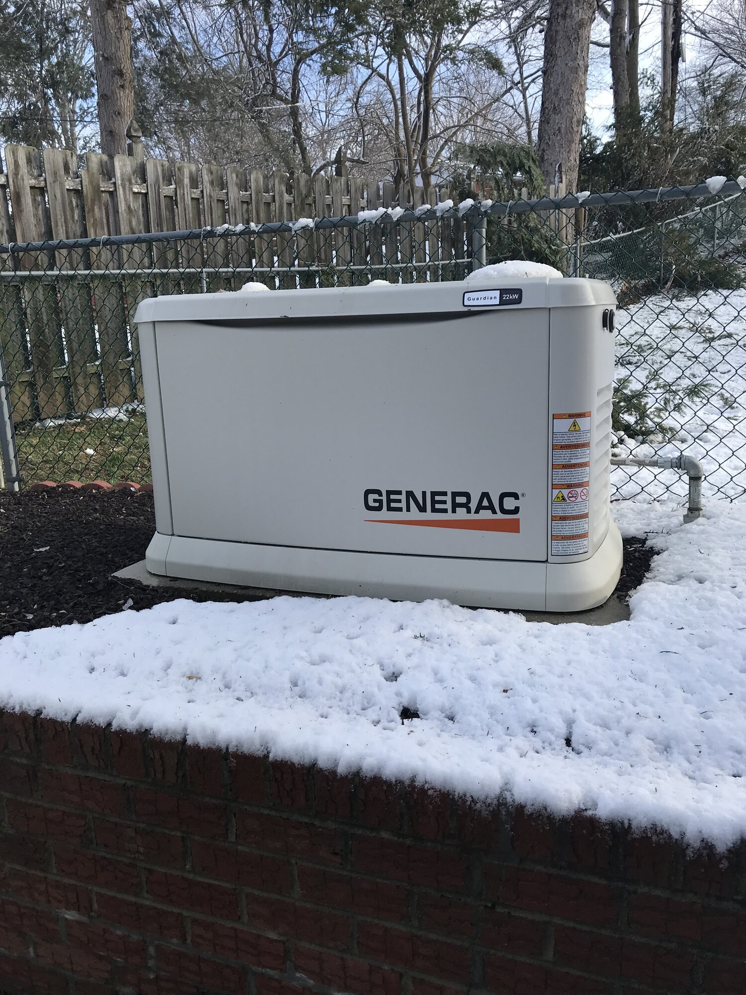

I have a 22kw Generac that I had put in March 2017
Best investment I've ever made!
The picture shown was taken after its first real test, a 28 hour run
Ran like a champ!
I highly recommend them!
