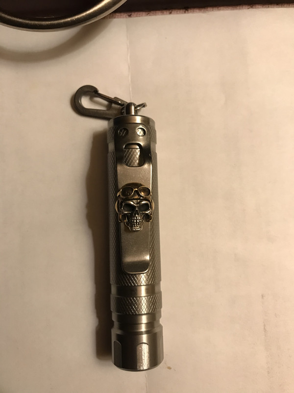

Well after years on my list I finally pulled the trigger and picked up a SS keychain body 17500. As expected it really is a great little light. Solid built and dam thing will run on practically any cell I can find. Perfect light for traveling when you might have a concern about what cells will be available. A VERY nice member gave me a fantastic clip that I'm thinking I can have mounted on this but will require putting some drilling and tapping but looks like theres plenty of meat at the top of this thing. And it will definitely be unique. In short I REALLY like this light.

My SS Logan 17500 came today. I really like the ability to run all kinds of cells in it with the adapters. I do have a question though: It is very finicky, as in it flutters on about every level except about full output. I pulled the QTC pill and couldn't see anything wrong with it. I didn't disassemble the pill yet as I didn't want to break it yet and i couldn't see specifically how it could be done gently. I have seen other pictures on here of them, and i my just be a little over cautious at this point. I do like the light quite a bit. It is heavier and a bit larger than expected, but i am used to the eigers, which i also really like. They too are a little fiddly, but they don't flicker once they are in a set position. This Logan flickers unless the QTC is about fully compressed. I tried different battery/ adapter arrangements, tried with the press switch and the keychain, all the same; flickering. Any ideas? I guess i need to pull the pill apart, anyone have advice on doing that? This bad boy is big enough for a clip.. shouldn't have dragged my feet on that.
