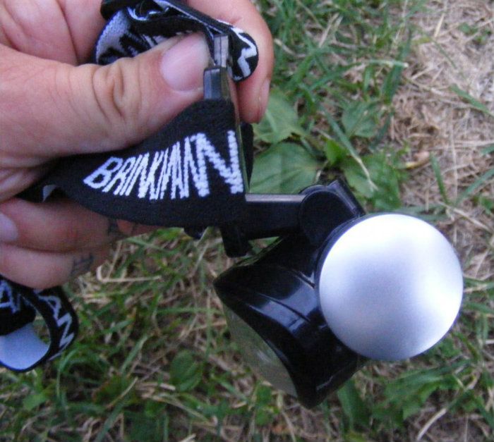

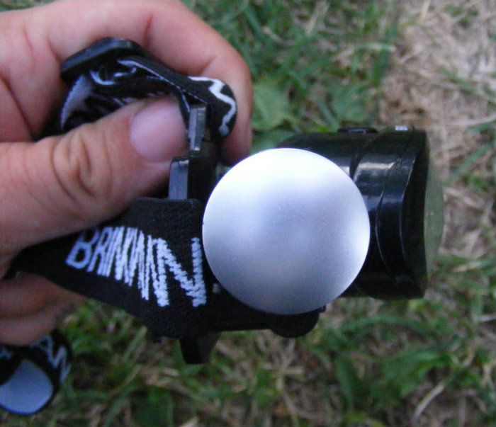

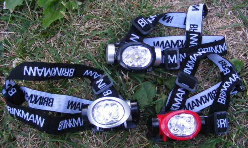

    You get one of each: black, silver, and red headlights. Functionally, they're all the same. The headstraps are all the same as well. The top strap is removable. Quality is the straps are okay, but not great. They do adjust for almost any size head, and they stay where you set them...
    The tilting system consists of small plastic ratchets inside the pivot. They work very well...
    It adjusts from here...
    To here...

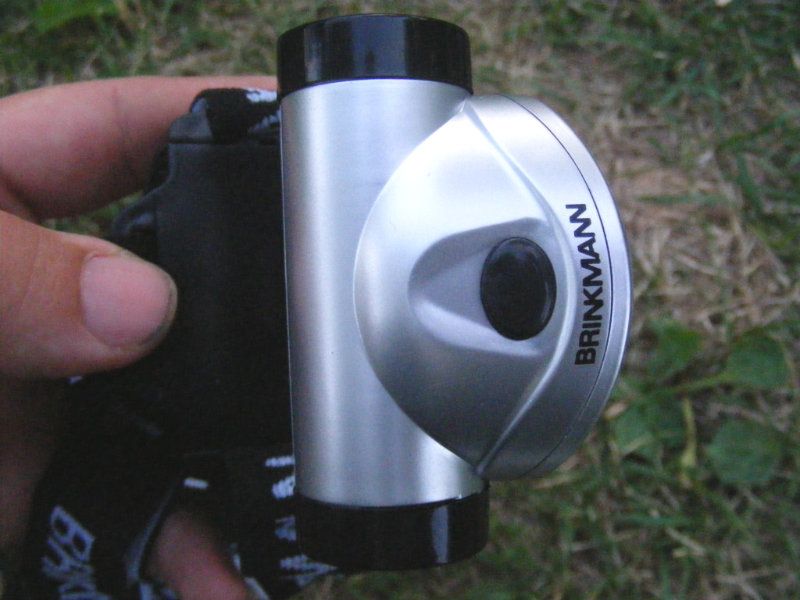

    The bush-button switch on the top. It's an electronic switch, and turns the light on in the following sequence: low, high, flashing, off. You have to cycle through all the modes to turn the light off.

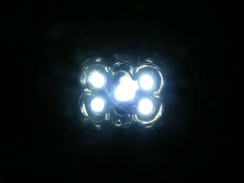

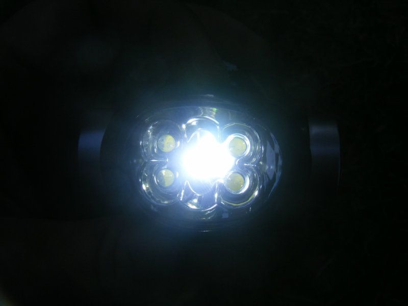

    Low uses one 5mm LED and is rated at 7 lumens for 47 hours, 20 minutes...
    High uses all five 5mm LEDs and is rated at 48 lumens for 8 hours, 50 minutes...

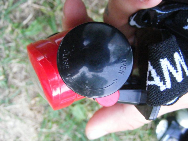

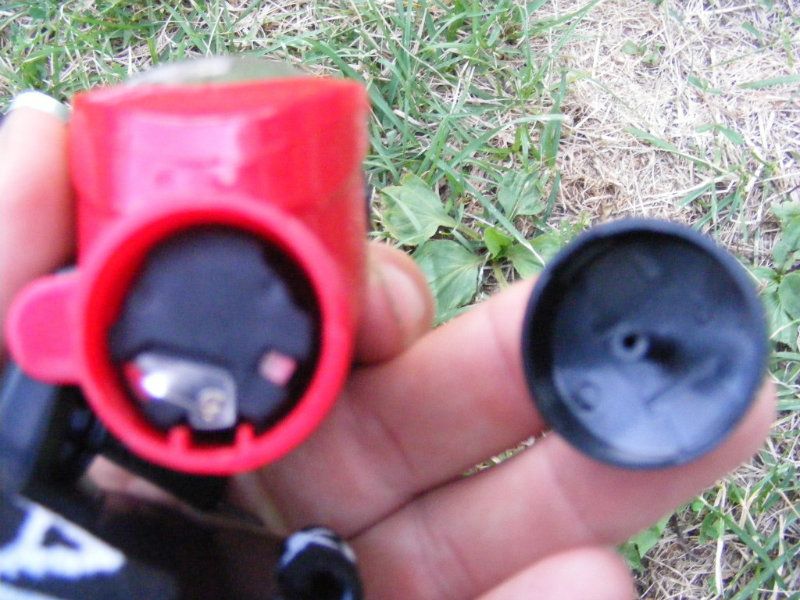

    The battery door screws off with 1/4 turn...

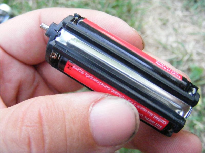

    The battery door doesn't have a spring on it, so like most other Brinkmann headlights, there's another way of doing it...

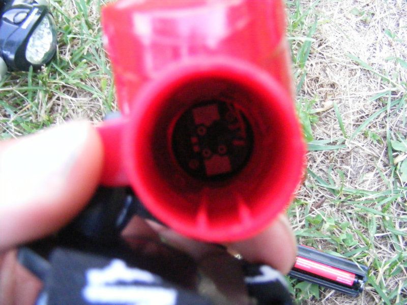

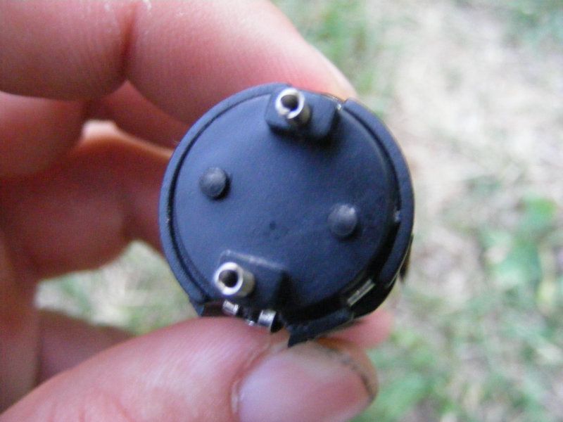

    The carrier uses two springs in its positive end...

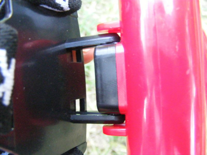

    ...to line up with the contacts inside the headlight. Notice the tracks at the bottom.
    Those are so this metal strip on the carrier can glide into them...

    Those look really high-profile. Do they stick out a ways?
    May 2009
    Ohio
    316
    Default Re: Brinkmann 3-Pack From Home Depot
    Quote Originally Posted by Bolster View Post
    You're lucky Delica likes to model headlights right after hiking...
    (She's ten, for reference of size.)
    She just caught four garter snakes and we put them in an aquarium; that's what she's staring at. She's not a zombie.
