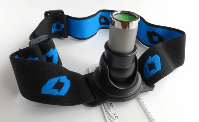

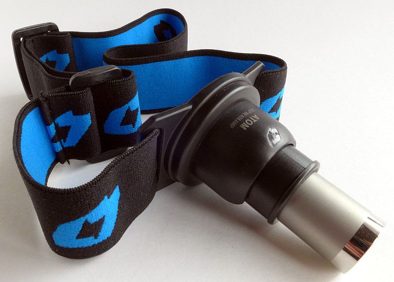

    The Atom AL is supplied fitted into the headlamp mount. Included in the box are the adapter collars to fit each of the different Atom lights allowing you to use the one headband for any of the Atoms. Also included are the instructions, the elastic headband, various size O-rings and a lanyard. (The CR123 may not be supplied as standard).
    The fully assembled Atom AL headlamp.

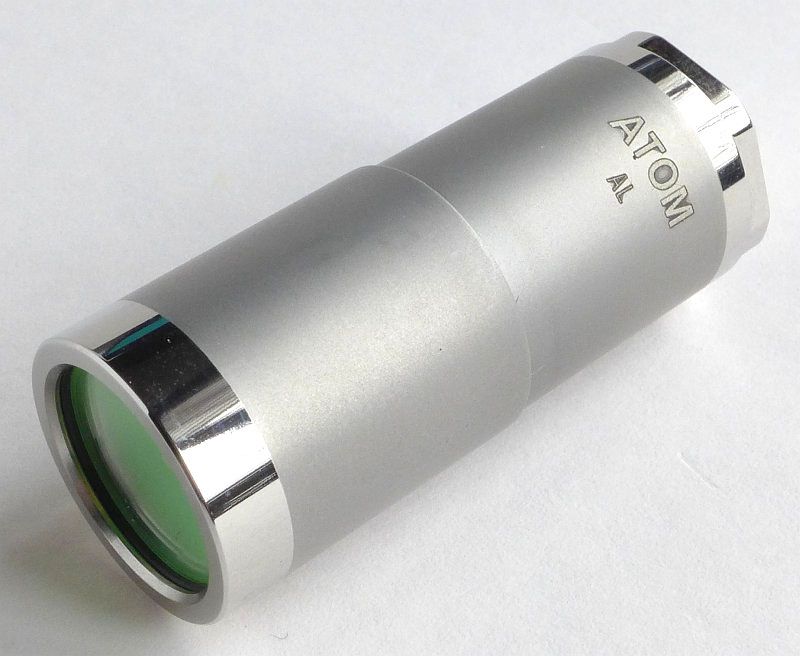

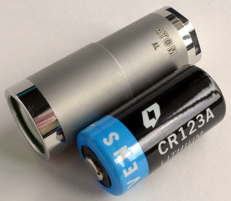

    The model designation is engraved into the stainless steel body. There are polished areas at each end of the Atom AL, and the rest of the tube is bead blasted.

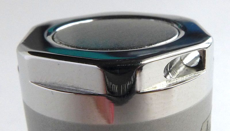

    The base of the Atom AL has a hexagonal shape which locks into the headlamp mount and prevents the base turning, and a strong magnet which holds it in the mount.
    This is one of the clear features of the Atom range; they really are only a bit bigger than the battery that powers them.

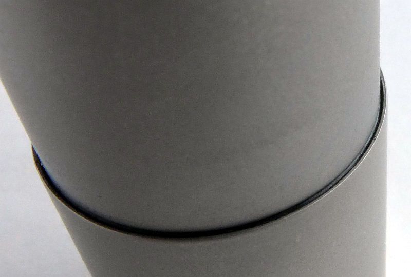

    The overlap of the head to the body really is super thin. (0.2mm thin, I believe. Something FOURSEVENS are rightly proud of)
    Looking more closely at the magnet, lanyard hole and hexagonal shaping.

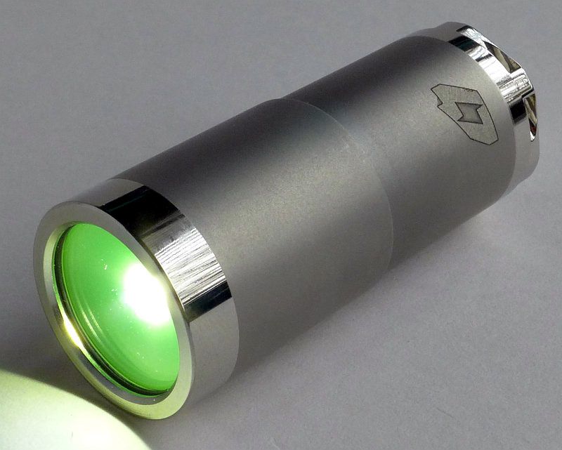

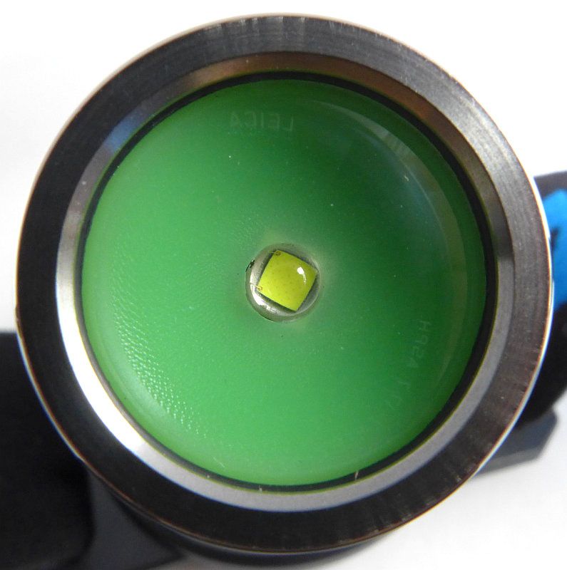

    Peeking through the glow in the dark 'reflector' (which is not a reflector at all) is the dome of an XP-G2 LED. Covering the emitter is a slightly domed plastic lens.

    Simply a full flood beam. Those familiar with this location for my indoor beamshots will not have seen such full flood before. Though only 120 lm, the High mode seems very bright despite being full flood.

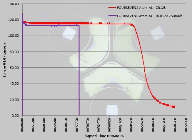

    Able to run on both CR123 and RCR123, the Atom AL gives you the choice of guilt free rechargeable lumens, or super reliable primary cells.
    FOURSEVENS Atom AL - CR123 I.S. measured ANSI output Lumens PWM frequency or Strobe frequency (Hz)
    High 120 0
    Low 5 0
    Performance and runtime is much better on CR123, with the runtime trace on RCR123 ending abruptly as the cell's protection kicks in. Output is very well regulated for 2.5 hours on High when using CR123.

    The Atom AL is super compact, but feels satisfyingly heavy due to the stainless construction and magnet. The headlamp holder allows you to direct it anywhere within an entire hemisphere thanks to its full articulation. This feature also gives it a very distinct look for a headlamp.
    Thanks to the forward projection of the headlamp holder, the Atom AL still worked very well even when mounted over a baseball cap. Without a cap, the front of the light is visible in my peripheral vision, but not the spill beam (so there is no glare for you).
    With the magnet securing the Atom AL into the headlamp holder, it can easily be pulled out of the holder to let you use it as a flashlight and then popped back into the holder as required. I've not used any other headlamp with this ease of access to the 'flashlight function'.
