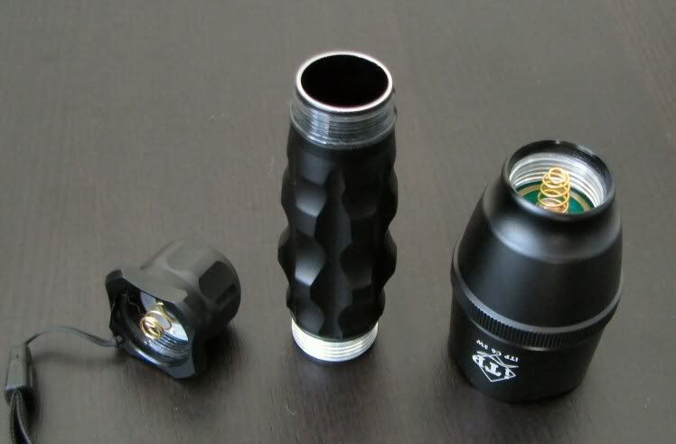

iTP is a new entry into the flashlight business, and the C6 series is their first offering here at CPF. These multi-power lights feature continuously-variable output levels and come in two variants that share basically with the same build - the C6T (Tactical) comes with a forward clicky and lacks the strobe/SOS modes (which are accessed by soft-pressing the reverse clicky on the regular C6 model). A smooth or OP textured reflector is available for either version. For full detailed specs, please check out the box label pics or visit iTP's Manufacturer's thread in CPFM
The packaging is identical for the two C6 variants. Inside the box, wrapped in individual plastic pouches, are the light with attached wrist strap, a package of spare o-rings and extra tailcap cover, and a carrying pouch. Quality of the pouch is pretty good, but the quality of the wrist strap is consistent with budget lights. I'd recommend they provide a better one. Instructions for use are on the back of the box:

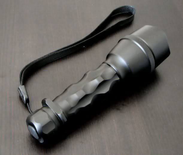

Design is interesting, with the "pineapple" body and tailcap grip ring. Both work well to help improve grip, and the light is well-balanced and comfortable to hold in any format, including cigar-grip fashion. I find the shape of the head to be a little uninspiring, but the texture ring does help for grip (you twist the head to activate the ramp). Both lights come with a scalloped bezel. Fit and finish is good on my samples, with clear lettering and type III hard anodizing (according to the manufacturer).

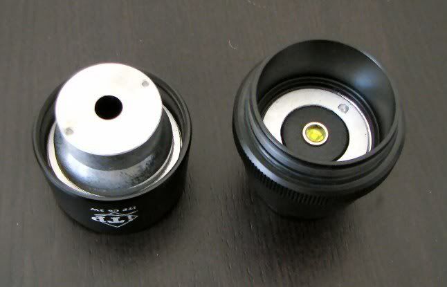

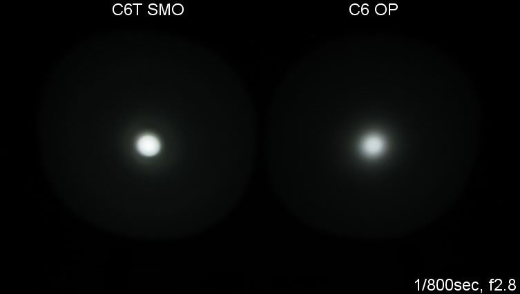

Both lights use a Cree Q5 emitter, and are available with either of the two reflectors shown above. Both of my lights came with the standard "yellow" backed Crees (as opposed to the asian "silver" ones). Texturing on the OP reflector is heavier than on most lights, producing a beam pattern that is virtually devoid of rings. Of course, this also greatly reduces max throw compared to the smooth reflector.

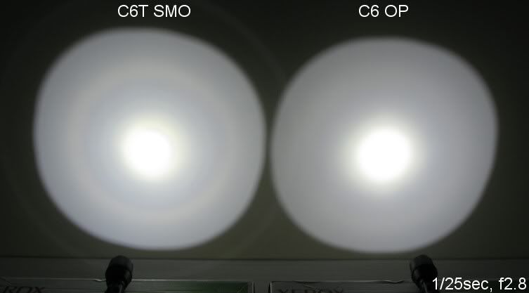

As you can see, spillbeam profile is a little square at close range due to the four-corner scalloping of the bezel (beamshots taken at ~0.5m from a white wall). I'd recommend iTP shorten the bezel to reduce this. Harder to see in the pics, but the smooth reflector is quite ringy (like most throwers). The heavy OP textured reflector produces a very smooth beam profile - it's actually somewhat SSC-like in its beam pattern.
IMO, this is a point in iTP's favour - many vendors sell lightly textured OP reflectors that don't really help with Cree rings, but still reduce throw. If you are going to offer both smooth and textured reflectors, probably best to go with a heavier texture like this one. If you are only going to offer a single reflector, a light OP makes sense to me (i.e. intermediate solution). Just my $0.02. :)
Overall build quality of the light seems quite good. Weight is a respectable 154g. Reflector and emitter assembly are easily accessible. Body tube comes with anodized tailcap threads, so tailcap lock-out is available on both models. :thumbsup:

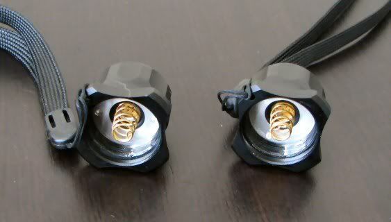

Tailcaps are pretty much identical except for the greatly protruding forward clicky on the C6T (Tactical) version. Both switches have good tactile feel, and are easy to access. Note that tailcap cover on the regular reverse-clicky C6 version protrudes slightly, preventing tailstanding (the forward clicky certainly can't tailstand).

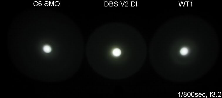

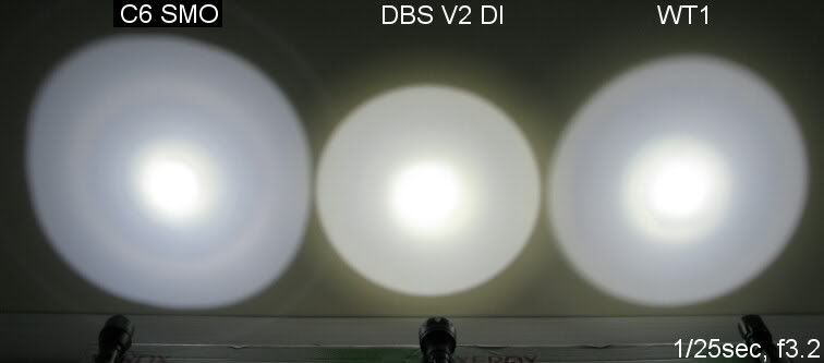

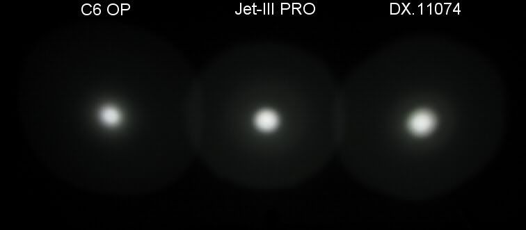

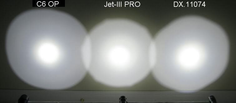

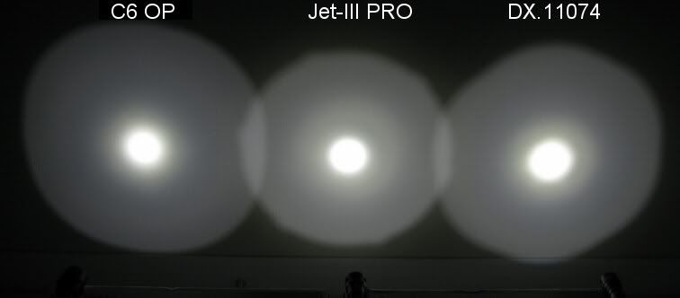

Comparison Beamshots
All lights are on max/100% on 18650 (AW Protected), about 0.5 meters from a white wall.
Testing Method: All my output numbers are relative for my home-made light box setup, a la Quickbeam's flashlightreviews.com method. You can directly compare all my relative output values from different reviews - i.e. an output value of "10" in one graph is the same as "10" in another. All runtimes are done under a cooling fan, except for the extended run Lo/Min modes which are done without cooling.
As you can see, the overall characteristics of the C6s are pretty similar to their other continuously-variable competition (Jet-III, DBS DI-pill, DX sku.11074 drop-in for P-60 hosts). Max throw is roughly comparable to the Regal WT1, with both using smooth reflectors. The OP textured reflector for the C6 greatly reduces throw.

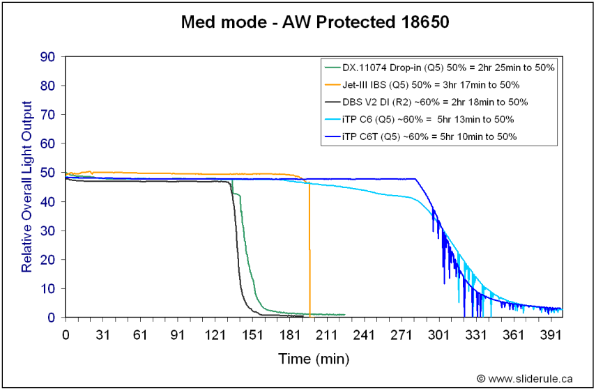

Output/Runtime Comparison:
Output/Runtime Pattern:

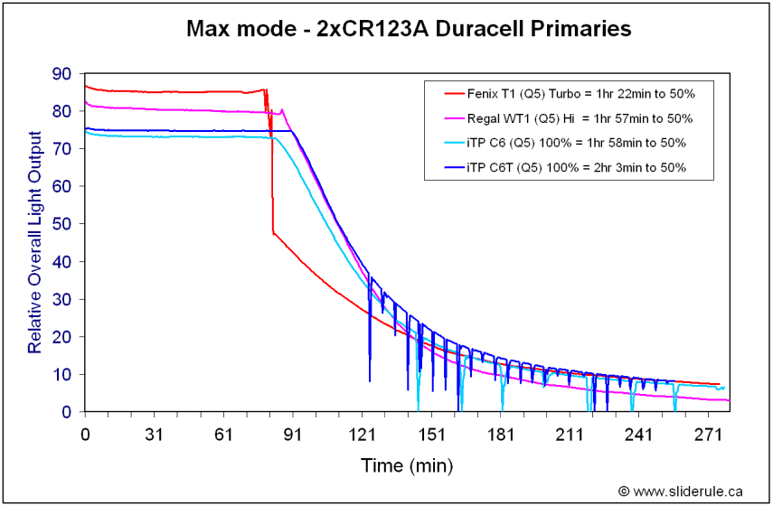

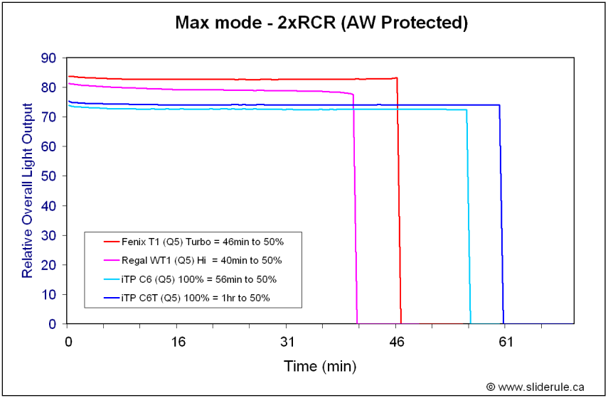

If you just looked at the Max output runs, you might be disappointed to see the standard direct-drive pattern of the C6s on 18650. But first appearances can be deceiving in this case. A few points to keep in mind:
  • Unlike the continuously-variable competition, the iTP lights are multi-power and fully regulated on 2xCR123A and 2xRCR.
  • The C6 is regulated at lower output modes on 18650 - until the battery is nearly exhausted and then it drops out of regulation. An advantage to this pattern is that you don't suddenly hit the battery protection circuit without warning - you have a long period of declining low output light first.
  • C6 lights feature a low voltage warning flash (i.e. all the spiky noise at the ends of the traces). This is a rapid triple flash of the light (similar to the max and min flash at the ends of the ramp). It occurs at a freq of ~6 secs once the low voltage trigger is reached. Personally, I find this a bit superfluous, since the lower output tells you that you are out of regulation and thus nearing the end of useful battery life.
  • Max output seems a little lower than some of the lights tested here, but with corresponding longer runtime. The max output/runtime variation between my two samples likely just reflects Vf differences between the emitters (which would be expected to have a significant impact when direct-driven).
Output/Runtime Efficiency:
Personally, I was pretty blown away by the Medium runtime test on 18650. As you can see, the 18650-only DX 11074 drop-in has roughly equivalent output/runtime as the DBS DI pill (also 18650-only). The JetBeam IBS circuit (which has a higher burden since it also has to support lower voltage standard alkaline/NiMH batteries in the Jet-I/II format) pulls ahead with a significant increase in runtime. But the C6s just blows right past even the IBS! :faint: Frankly, this is remarkable performance for a multi-power setup that can also handle 2xCR123A and 2xRCR in fully-regulated fashion. :twothumbs
On primaries, the C6s don't do quite as well as the current-controlled low mode of the Fenix T1, but that's hardly surprising in PWM-based lights like the C6s. And again, keep in mind the T1 only has a single defined low mode (and isn't compatible with single Li-ions). Unfortunately, I don't have the newer multi-power TK10 or TK11 to compare.
