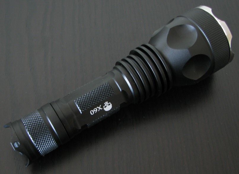

I’ve reviewed a couple of Ray lights in the past, but this is their first 1x18650/2xRCR “thrower” model. Let’s see how it compares to other lights in its class … :whistle:

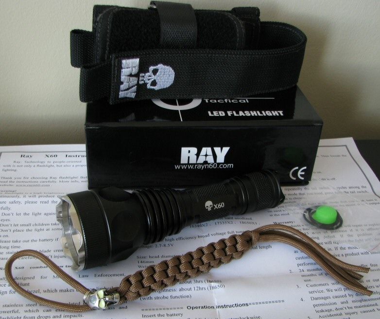

Packaging is fairly standard for Ray, with a hard carboard box with magnetic closing flap and cut-out foam. Inside, the light comes with a manual, spare o-rings, GITD boot cap, paracord lanyard, and high-quality re-configurable pouch.
A couple of thoughts here – the paracord lanyard reminds me a lot of the earlier Nitecore Defender Infinity. Interesting skull motif everywhere, including on the parachord (the eyes of the skull are GITD!).
The holster is remarkably high quality, and reminds me a lot of the Maxpedition sheaths – but with even more configurable arrangements (i.e. flap off, parts reversed, etc.). :thumbsup:
From left to right: AW Protected 18650, Lumintop TD-15, Ray Tactical X60, 4Sevens Maelstrom G5, Olight M20, Eagletac T20C2-II, Tiablo A9-R5
X-60: Weight: 148.6g (no batteries), Length 146.6mm x Width 44.9mm (bezel)
TD-15: Weight: 139.2g (no batteries), Length 148.7mm x Width 37.8mm (bezel)
4Sevens G5 Weight: 145.5g (no batteries), Length 156mm x Width 38.9mm (bezel)

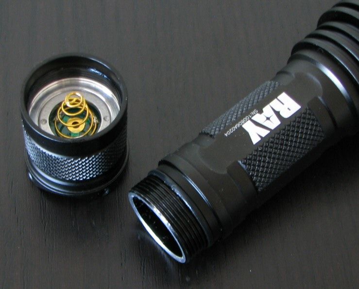

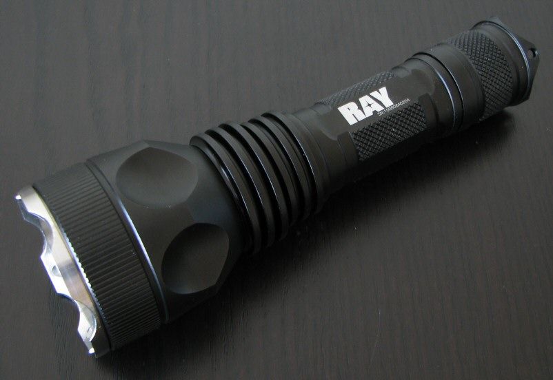

Build quality is very high. Screw threads are anodized at the tailcap for lock-out. :)
Anodizing is perfect on my sample, no chips in the medium gloss black (HA = type III). Knurling is decent, and grip is good. Lettering is sharp and clear, in bright white against the black finish. Note the skull motif continues here, but it is rather understated compared to the holster.
Light can tailstand.
Flat-top 18650s worked on my sample. :)
Note there is no clip included with the light – I recommend you use the holster.

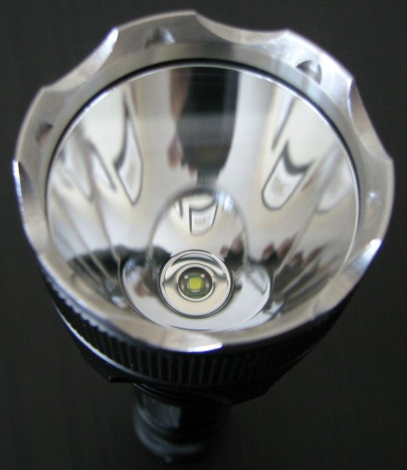

The X60 features the latest emitter (XP-G R5), with a large and deep smooth reflector. This should produce excellent throw.
Which brings us to the requisite white wall hunting ;). All lights are on Hi on AW protected 18650, about ~0.75 meter from a white wall (with the camera ~1.25 meters back from the wall). Automatic white balance on the camera, to minimize tint differences.
From now on, all my beamshots will be taken in this standard configuration, to facilitate comparisons.
As you can see, the X60 has excellent throw. My sample has only mild evidence of the center-void darkspot common to XP-G lights with smooth reflectors (your experience may vary, however).

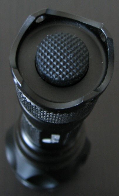

Turn the light on by pressing the tailcap clicky (press for momentary on, click for locked on),

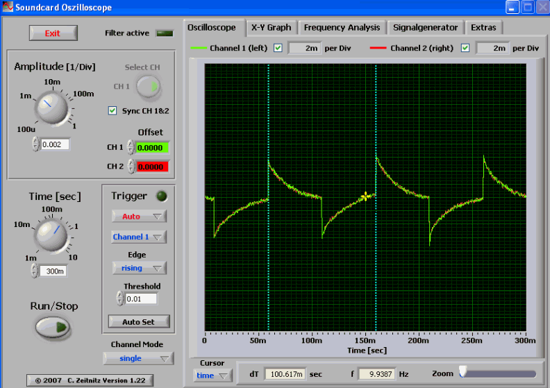

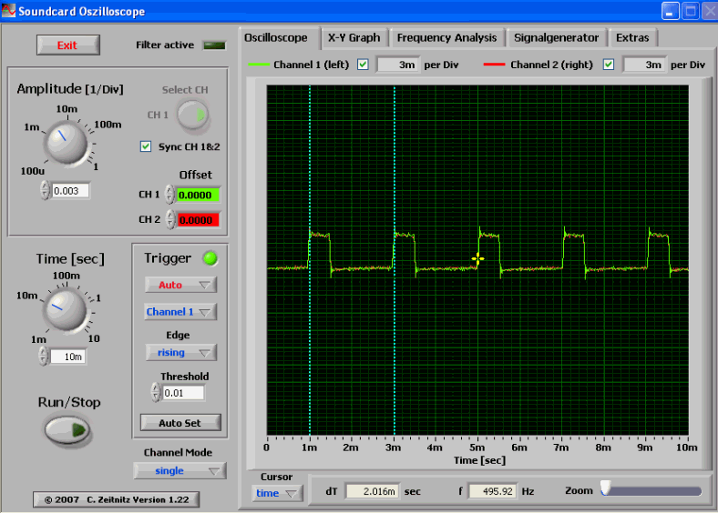

PWM and Strobe
The X60 uses PWM on its low mode, at a frequency of 496 Hz on my sample
Strobe is 9.9 Hz.

All XP-G lights with smooth emitters can show a relatively dark center to the hotspot, although I did not notice much of one of my sample.

Light uses PWM on the Lo mode, at a detectable but not obtrusive 496 Hz.
