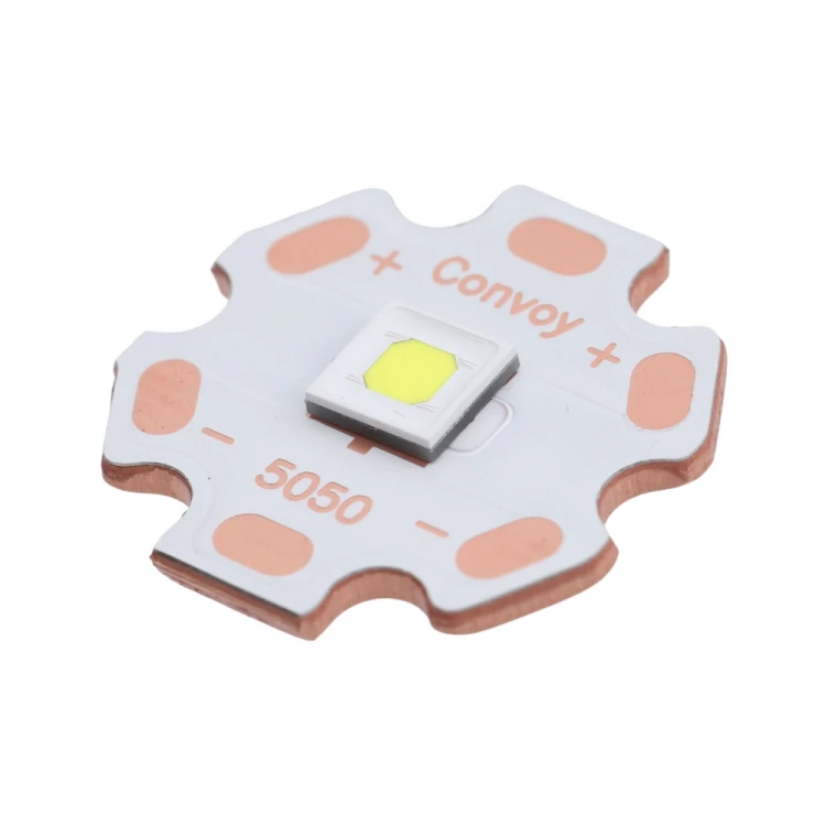

Convoy has started getting the Luminus SFT-60 emitter in some of their lights.
I find smaller & mid-sized emitters interesting (SFT-60 being 5050 mid-sized)
..a Cree 70.3 is 7070 size

The driver Simon developed is a version of the 3V 20.5A buck used in other lights.
for the SFT60, he made a 3v 15A buck,, 45W to a 5050 size emitter = good times

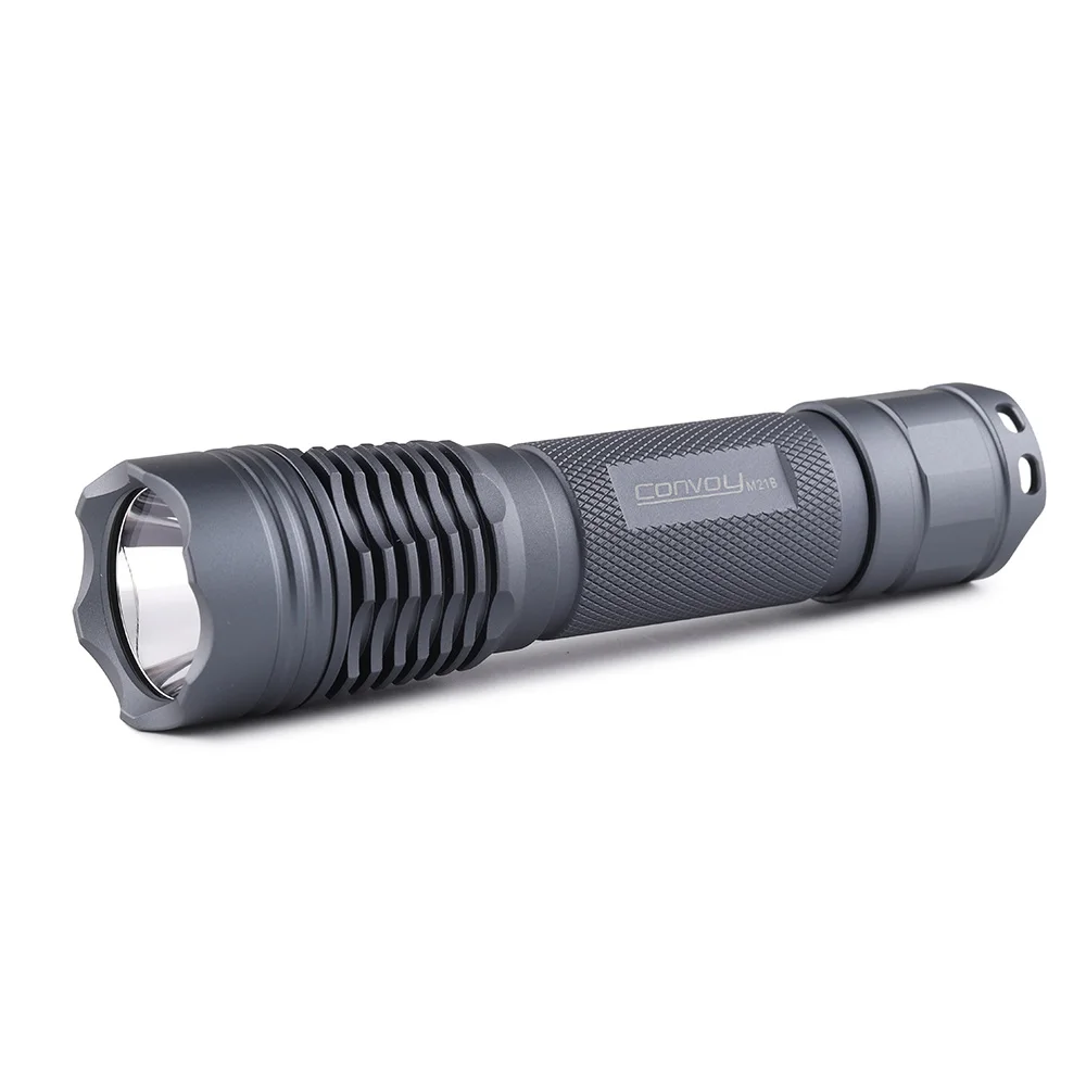

For just under $27 got a M21B in gray with the SFT60,, that's approx. 4500lm on high from a duty size light ~ Holy *^&(
uses a smo reflector
I'll use a EVE 50PL 21700 me gots on hand
edit: believe it comes as 0.1%, 1%, 10%, 35%, 100%____ that can be changed to 1%, 20%, 100% or others,
has memory
