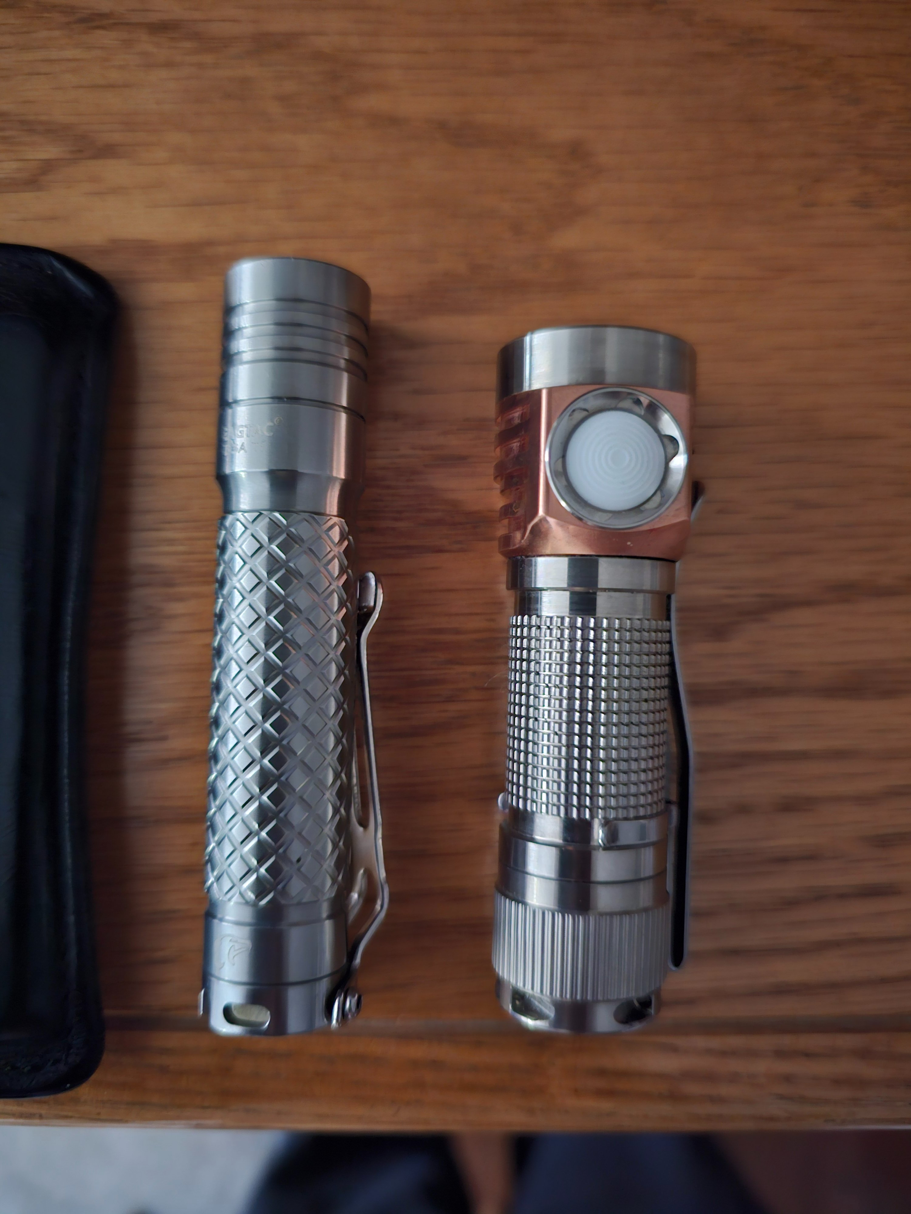

I got a new Emisar D3AAti from Hank a few weeks ago and I'm not sure it's for me. It's a beautiful light, but I find myself struggling with it usage wise and burning through battery life. For reference it's got 3 domed 519A 4500Ks and the stock 10511 optic, running on a Vapcell H10 battery.
I EDC a small flashlight and use it regularly at work in the early mornings when it's dark. I'd been using an EagTac D3A ti for maybe 6 or 7 years before getting this Emisar D3AAti to try.
I've realized I primarily use my EDC light in a hammer grip held up near my head looking down onto/into things, and I'm often wearing gloves, which makes a rear clicky far easier to use than a side button light. I haven't found a good way to adjust the brightness on the D3AAti while in a hammer grip, it's very inconvenient and I've nearly dropped it several times in handling.
Also, with such a diffuse hot-spot, I find myself using far more battery than I would with my EagTac to illuminate stuff to my liking. I never use the EagTac on turbo, high is plenty of light for everything I do, but I find myself using turbo on the D3AAti quite often.
I get 4 or 5 months of regular usage out of my EagTac D3A ti from an 1100mAh protected Orbtronic or 1250mAh unprotected Vapcell F12. I've only carried the D3AAti for a week and I'm already down to 3.98V with regular usage. At this rate I won't get more than 4 or 5 weeks out of it, and that's without using the aux LEDs at all.
I don't care for Hanks pocket clip on this light either and already have a Skilhunt m150 on the way to see if I like that better. I also ordered a 10507 optic and while I do like that a lot better I'm not sure it'll help any with battery life.
I bought the light originally to have a higher lumen output option in a small 14500 form factor light. Thing is even though it's really small, I still notice it in the pocket whereas I don't notice my EagTac D3A ti at all. Could be the shape, the weight, the way the clip holds it in the pocket, or a combination of all those things. And if I know I'm going to need a higher powered flashlight the D4K I keep on my nightstand is small enough to pocket anyway. So it leaves me luke warm regarding this D3AAti. I really want to love this light, but it's not going well so far.
It's a beautiful light and would be great simply as an addition to my collection.....but I don't really have a collection as of yet, lol. All of my lights have a place and a purpose and this was the first flashlight that could be considered a duplicate. In the end I'm still looking for a more modern/powerful upgrade to my Eag Tac D3A TI, currently eyeing a Convoy T3 Ti Cu with 5amp driver....but anyway. I just wanted to share my thoughts, vent a little, and see if you folks had any input on the matter. Thank you for your time

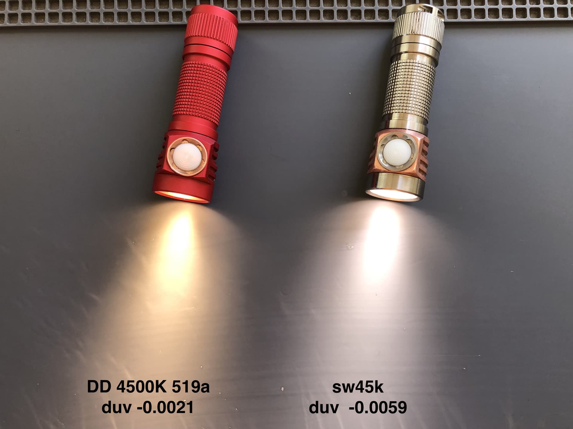

519A had a larger hot-spot
agree..
otoh, the SST-20 beam is more focused and wastes less power than the wider hotspot of the 519a

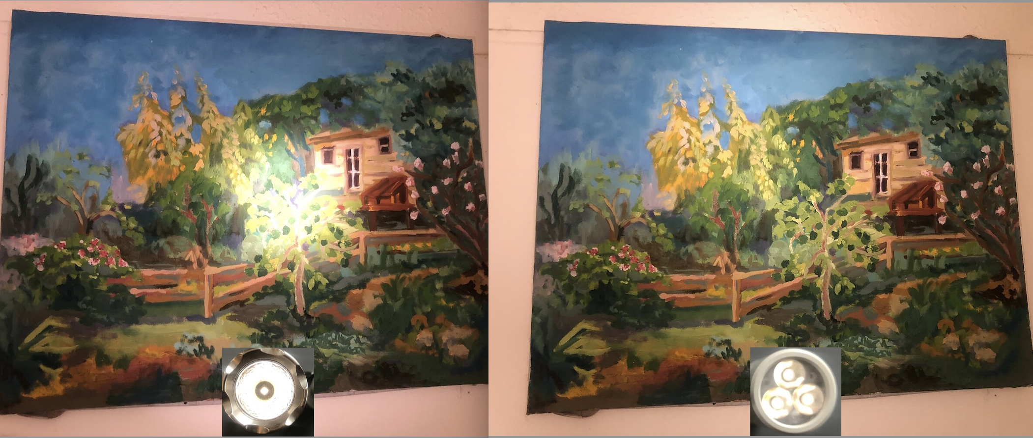

10 meters. .. to light up an analog gauge or display no larger than my hand.
excellent description of your application..
definitely agree the D3AA is not a good match for that distance and target size.. because it lights up too wide an area and does not project far enough forward..
the 10507 optic is slightly better than the 10511.. but imo still wrong tool for distance.. because it still wastes power by spreading light sideways, where it is not needed for your application
Agree a tight beam from a reflector suits distance applications better.. Ive not tried a Convoy but agree its worth a try, because it has a Single LED in a Reflector, not a floody multi LED beam
Multi LED lights, by their nature, spread light sideways, which is only good for close range and wide field of illumination
otoh, multi LED lights produce a more useful field of light to illuminate a painting at close range
Single LED in Reflector, vs Floody triple:
Note the reflector hotspot is too intense for the application

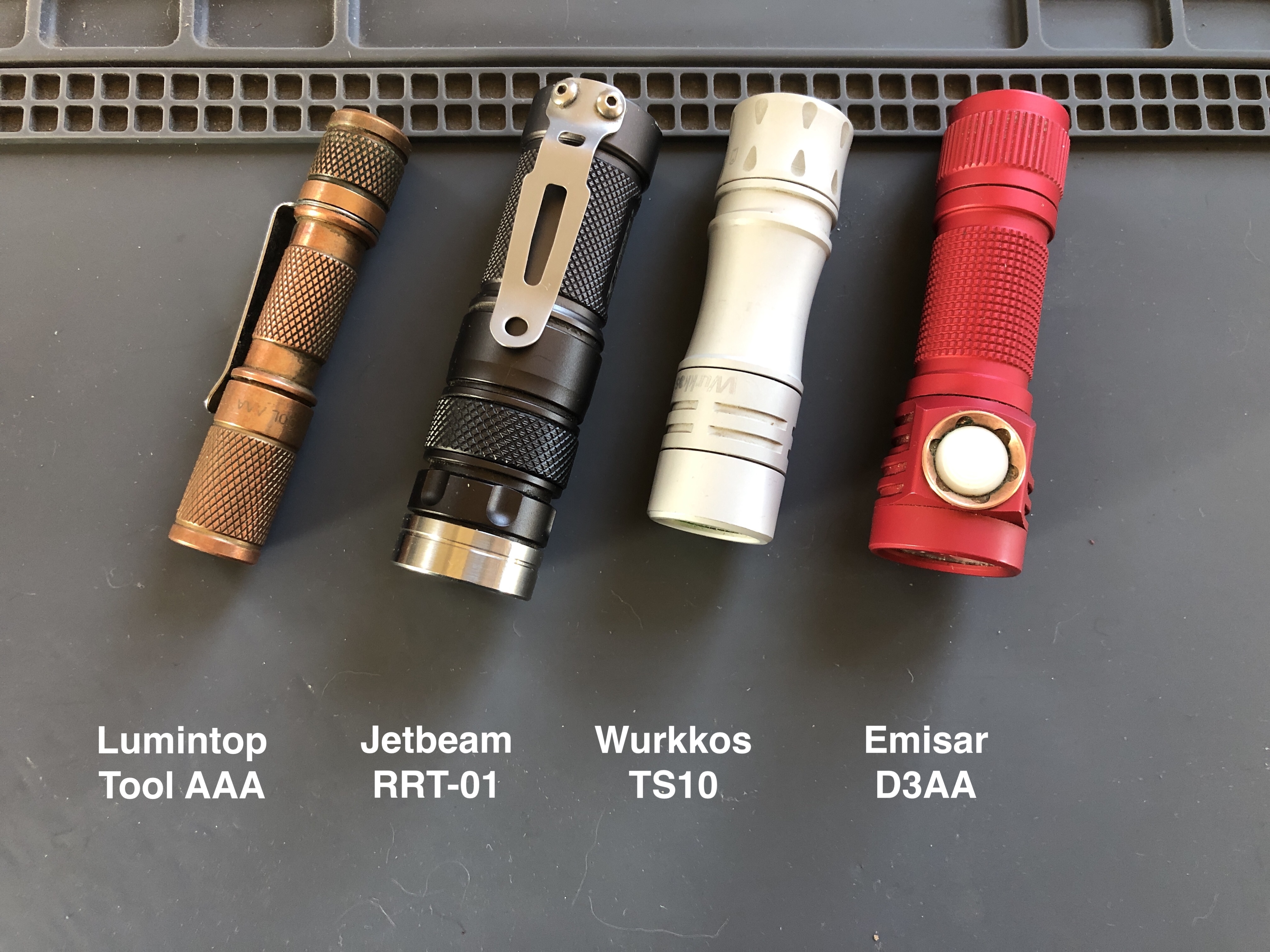

After my intro to flashlights, using AAA batteries, and later Eneloop, I also went through a phase where most of my lights were CR123a/16340/18350: mainly Jetbeam Rotaries, and Sunwayman Rotaries.. The Jetbeam has the best pocket clip, and most intuitive UI.
Lately Ive been shifting to AA/14500.. mostly because of the Wurkkos TS10, and now the D3AA. The TS10 has by far my favorite form factor, but the driver uses PWM.

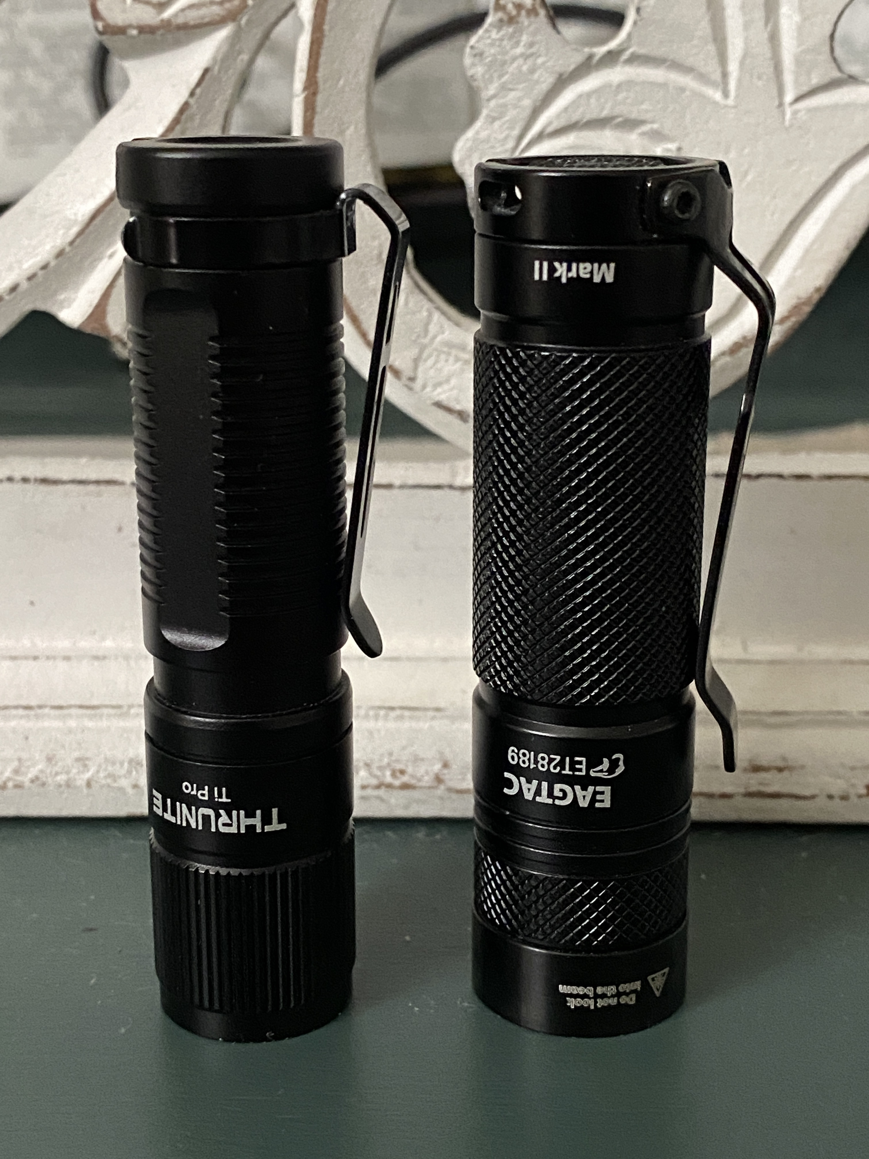

I left 123s for 14500s, but eventually whittled everything down to the Eag Tac D3A with Nichia 219C 4000K that I've been carrying daily for 6 or 7 years now. The Emisar D3AA is the only other 14500 light I own. So I've got half a dozen different 14500s laying around, lol. From older Orbtronic 840mAhs to their newer 1100mAh versions, plus the usual H10s and F12s and I think even an old Nitecore USB rechargeable 14500

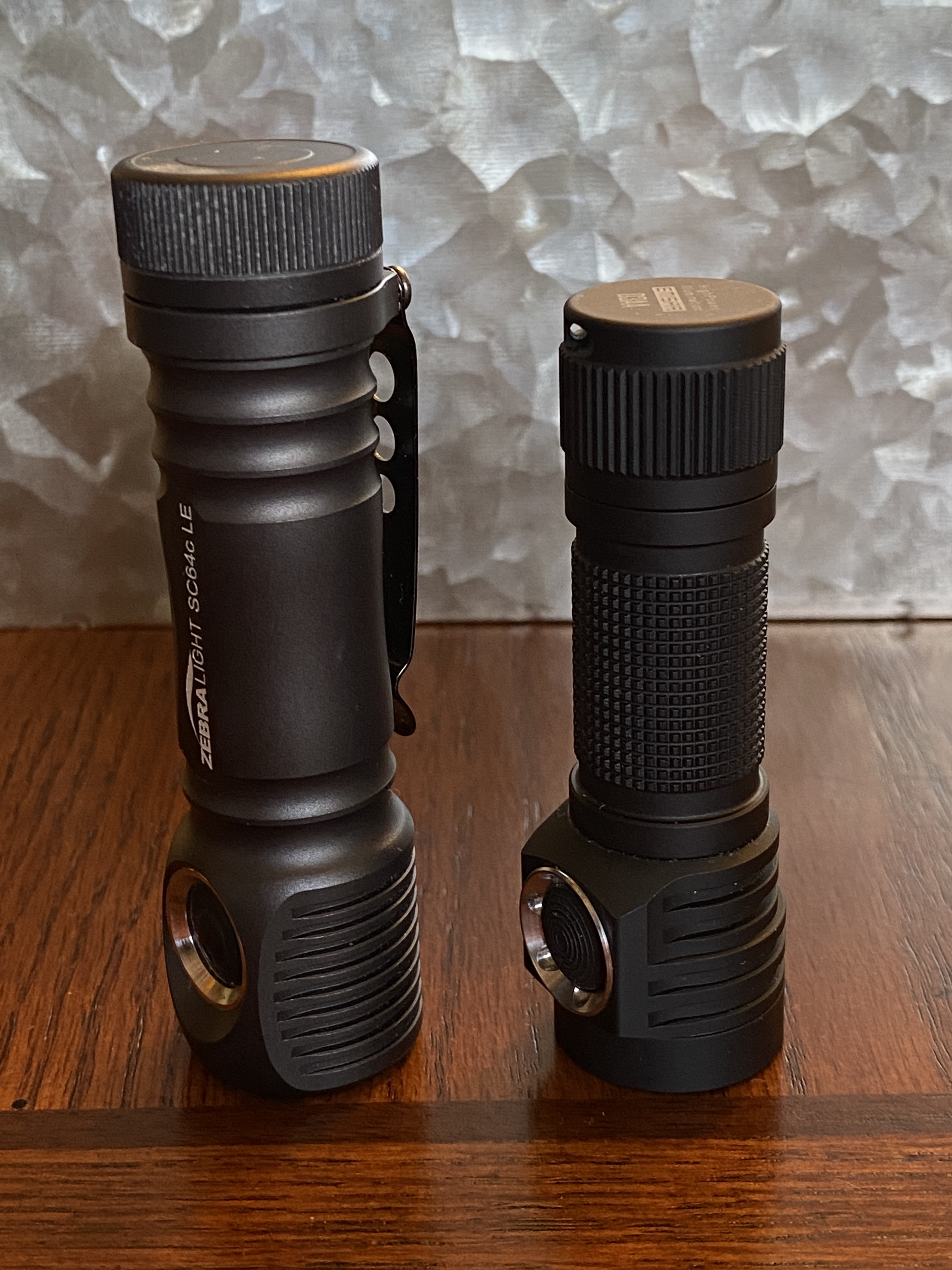

For me size/shape is more important for carrying/edc. I want it to be like my wallet or my knife. Always have it without knowing it’s there till I need it.
Light quality/UI is more important when I have a light on hand that I can place on a table, glovebox etc.
If I’m forced to carry the D3AA without a good clip I might as well bring the Zebralight.
EDC during daylight working hours the Thrunite gets the nod.
If I know I’ll be out after darkness arrives the Eagtac goes in the pocket.
The D3AA is a great light no argument from me and I’m really glad to have it. I’m just struggling to find the best use for it in what I need a light for. As a nightstand light in order to get firefly level it has to be in ramp mode. I prefer stepped mode so it’s brighter at its lowest output than I need.
I’ll eventually find the best use for the D3AA. If not it will be a shelf queen. A very nice one.

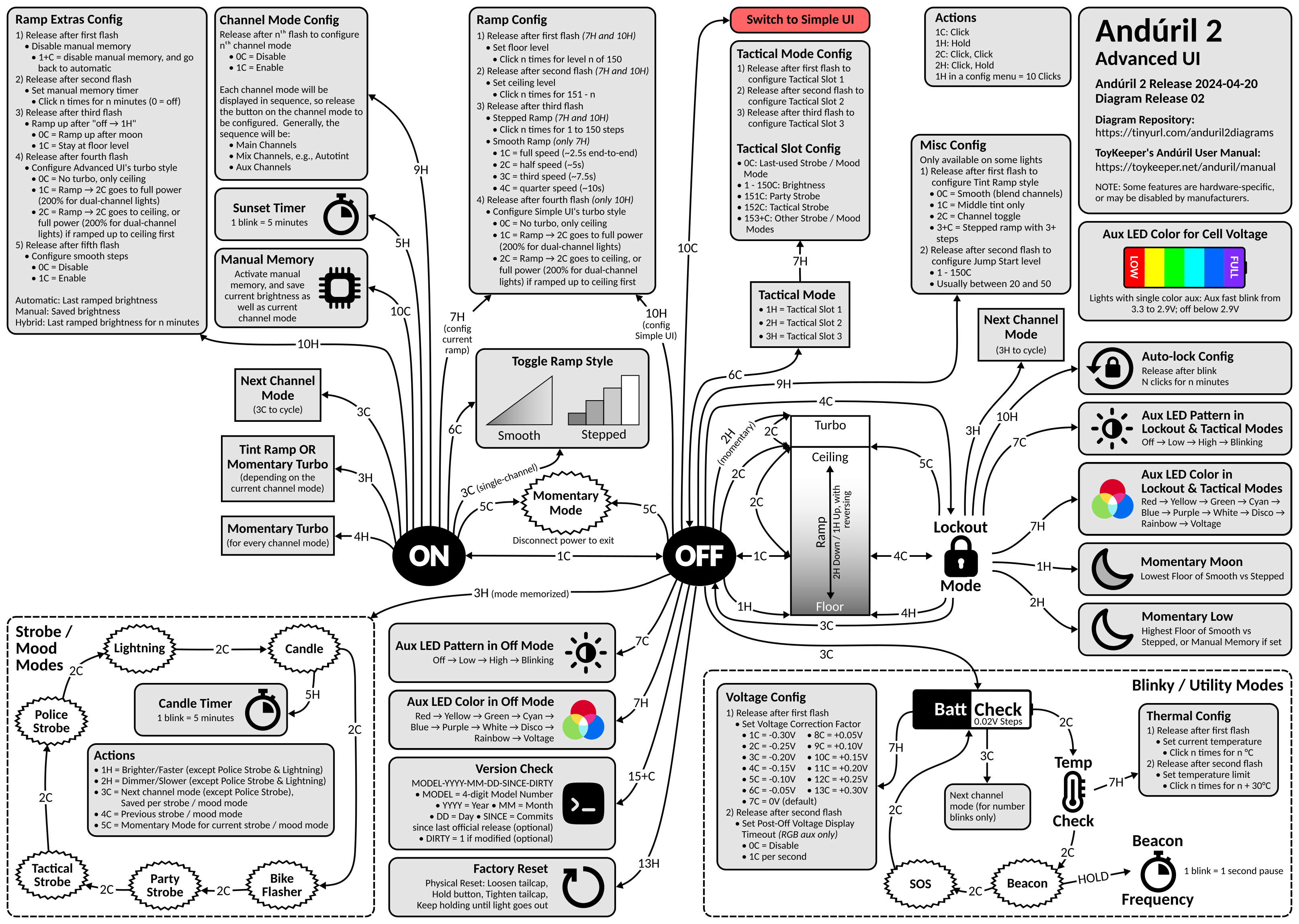

true, stepped mode is set to a higher floor
the floor can be changed to be lower.. the procedure may seem daunting, but might be worth learning
1. IF the light is in Simple UI: From Off, do 10H to switch to Advanced UI
2. Turn the light On in stepped ramping mode, then
3. Do 7H and release immediately at first flash, the light will start flickering
4. Clic 1 time to set floor to lowest level
5. Do nothing else, when the light finishes flickering youre done
however, that only lowers the floor for Advanced mode stepped ramping..
if instead you want to change the floor in Simple Mode do this:
1. If the light is in Simple UI: From Off, do 10H to switch to Advanced mode
2. Leave the light off
3. Do 10H and release immediately at first flash, the light will start flickering
5. Do nothing else, when the light finishes flickering youre done programming
6. From off do 10C to switch back to Simple mode. Now both floors will be set to minimum.
here is a flowchart that includes those steps (see the Ramp Config menu):
I’ll eventually find the best use for the D3AA. If not it will be a shelf queen. A very nice one. View attachment 77008
