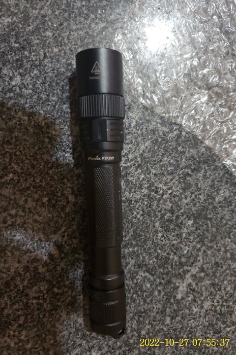

C cimerio Newly Enlightened Joined Aug 2, 2022 Messages 9 City & State/Province brazil Oct 27, 2022 #1 Hello, I would like to disassemble my dead Fenix fd20. Can someone please guide me on this? It seems like a "mono" unique piece, but doesn't make sense. Should be a way of dismantle it. Attachments 16668681194172891827809932866465.jpg 126.3 KB
Y yellow Flashlight Enthusiast Joined Oct 31, 2002 Messages 4,730 City & State/Province Baden.at Oct 28, 2022 #2 The bezel for sure is screw-on, that "grip ring" directly below also seems to be threaded in. As you surely have tried this already, did it not come apart? Fenix in the past has glued in parts often. Maybe heating them up could help.
Monocrom Flashaholic Bronze Member Joined Aug 27, 2006 Messages 26,703 City & State/Province NYC Oct 28, 2022 #3 A mini strap-wrench should help in getting the head twisted off.
