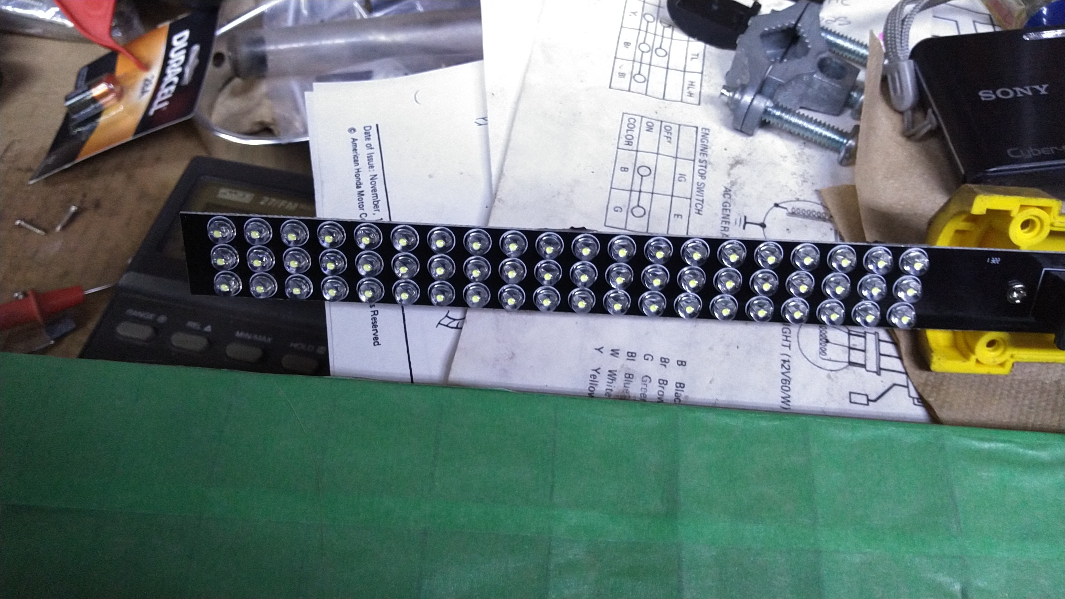

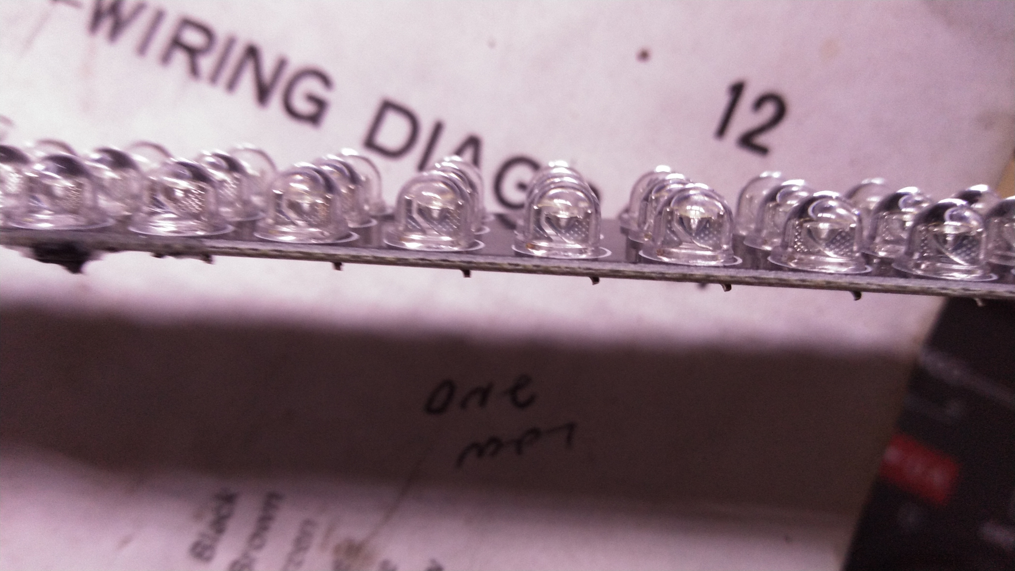

I have a Bayco LED drop light. (120v) I like it but.... Seems the reviews say half the bulbs die out and some arrive completely dead. I pulled it apart and there are 2 sections. (2 sets of 30 LEDs) One section that is often intermittent had a LED that is opening up. Looks like 3.1v across each LED. Approx 90 volts over the whole section. Opens up to well over 120 when that LED cuts out. Open circuit.
Sounds like poor quality LEDs. I like the light and hate to trash it.
Do I replace the one LED?? All the LEDs in that section?? Or all the LEDs in both sections???
Where would be a good place to buy replacement LEDs like these?
Someone mentioned just bypass the bad LED. I did that and so far it has been doing well for several months now.
