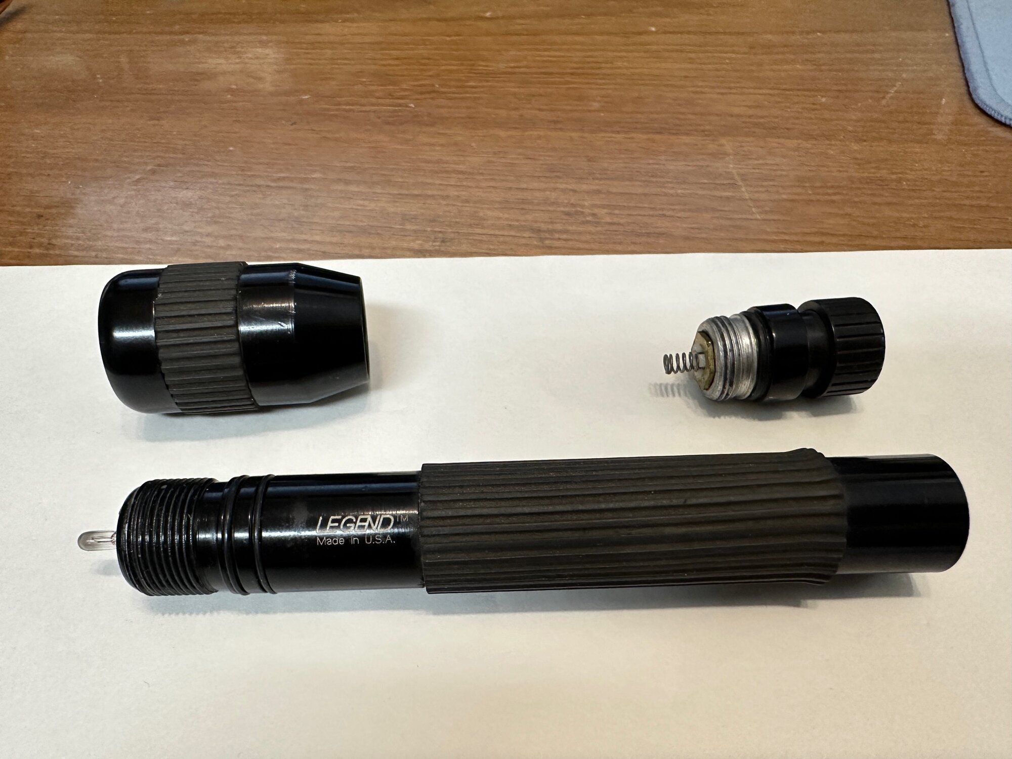

I have a very old Legend that says "Made in USA" and has the numbers 42331931 on it. It does not say Brinkmann anywhere. I would like to know more about this flashlite but cannot find a hit on the number. Can anyone help? Looking for a new bulb would be top priority for me.

I had read somewhere that older Legends were worth saving but I have to say that the existing bulb is so weak, I have to wonder if its the wrong bulb, or where they all so dim.
The glass of the bulb is black as if the filament is burned out, except it is not.
So I guess I should throw it out and buy a new LED light?
I wouldn't throw it out; it's a cool piece of history they don't make any more. But it's not worth much and micro incandescent flashlights have been obsolete for a long time. As far as the existing bulb, these bulbs wore out fast and would cloud up the glass with vaporized metal and get dim. New bulbs are clear. Also could be a wrong bulb--the original Legend bulb for these had a white plastic base. Red base meant 3AA. Bulb with no base is probably a Mag bulb.
At full power it won't be unusable but it will be pretty dim by modern standards. Same as a Mini-Mag. A new single AAA keychain light like an Olight i3e they give away on holidays is about five times brighter.
Thanks Abtomat. Mine has a white base, so probably the correct bulb. I guess it serves as an example of how far flashlight
technology has come.
