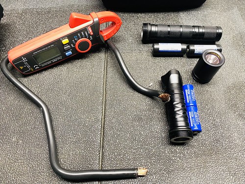

M91B with 2X123s is 2750ma
with 8Vis 1500ma
Here's my simple setup
yes, two new Battery Station 123s
Maybe it's my wall but the M91b looked just as bright on the wall with 6V as it did with 8V.
I don't have a light meter.
Ya under load they will be less then that but they should look real close.
I believe it is 2. It’s bigger than 4. It’s a negative battery cable with the ends cut off. I wanted to make sure I had enough wire to handle the loads. Haha

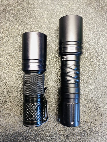

Now if two cells will be your primary setup, then a neat option is below:
Next to an MD2. MD2 is 5.13", the other is 4.30"
Specs: bulletproof twisty, M61T H/L ring, MD1.5, Oveready -15mm tailcap, 18650 flat battery or 2XC123
(@PoliceScannerMan sold me on this fantastic setup)
