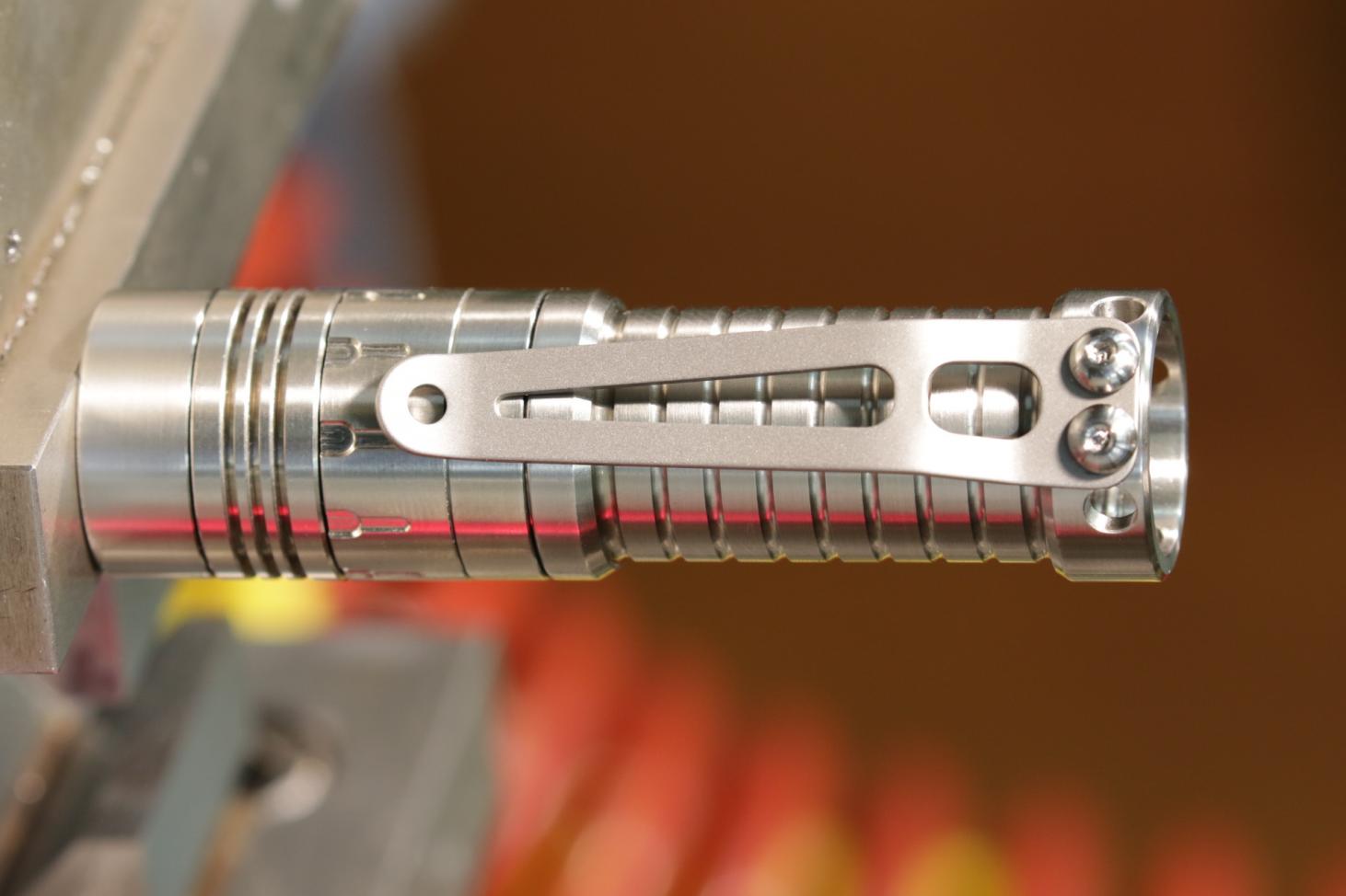

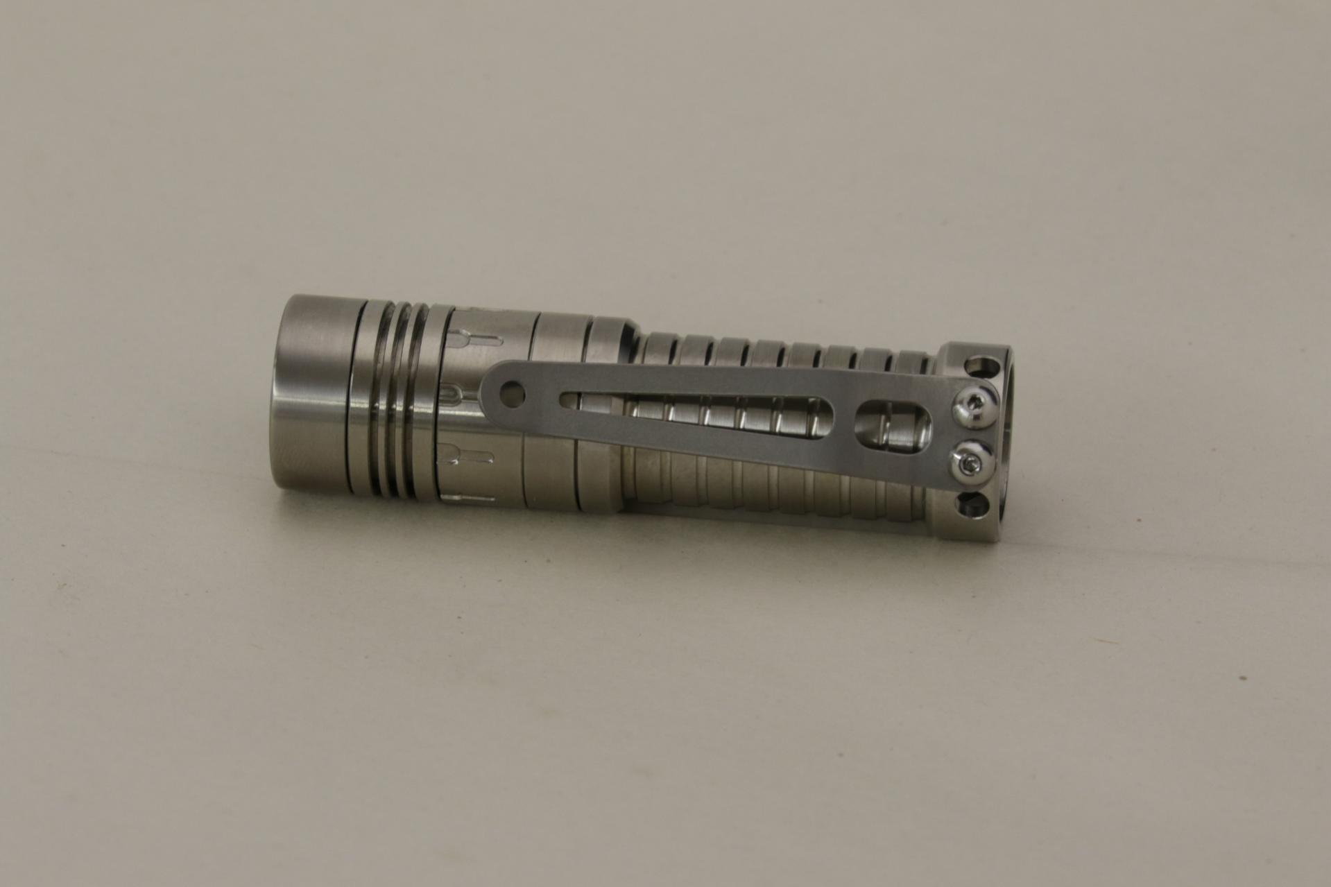

McGizmo titanium pocket clip installed, sanitized bezel & body wide grooved on SWM V10R Ti:
SWM V10R Ti with Haiku narrow pattern grooves, sanitized bezel & McGizmo pocket clip installed:

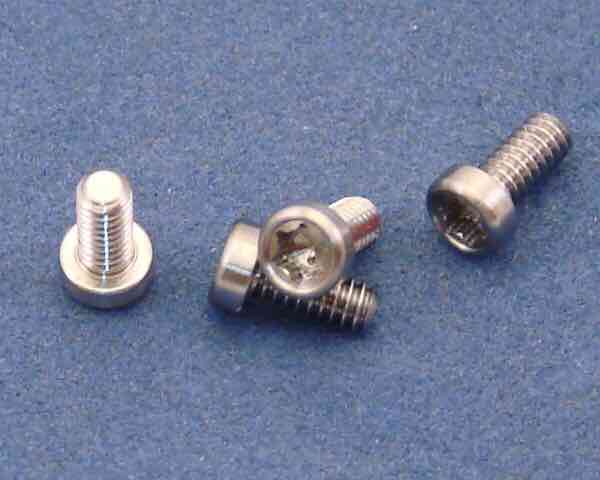

Threading detail of drilled & tapped holes for McGizmo pocket clip:
Image-9853934-216343289-2-WebSmall_0_71688b6b0331fa6616bb6842d8ee7a42_1
Stone wash with SWM etching left intact:
Image-9853934-161659978-2-Web_0_9617922c5c38607b3379b9ad4f5b8592_1

(PLEASE note: titanium screws are tender & the hex recess is easily destroyed by ordinary Allen wrenches. McGizmo recommends the Thorpe/MIP driver & that's what I use. http://miponline.com/store/mip9001.html) I can also supply Ti Torx head screws which don't require a special tool.
