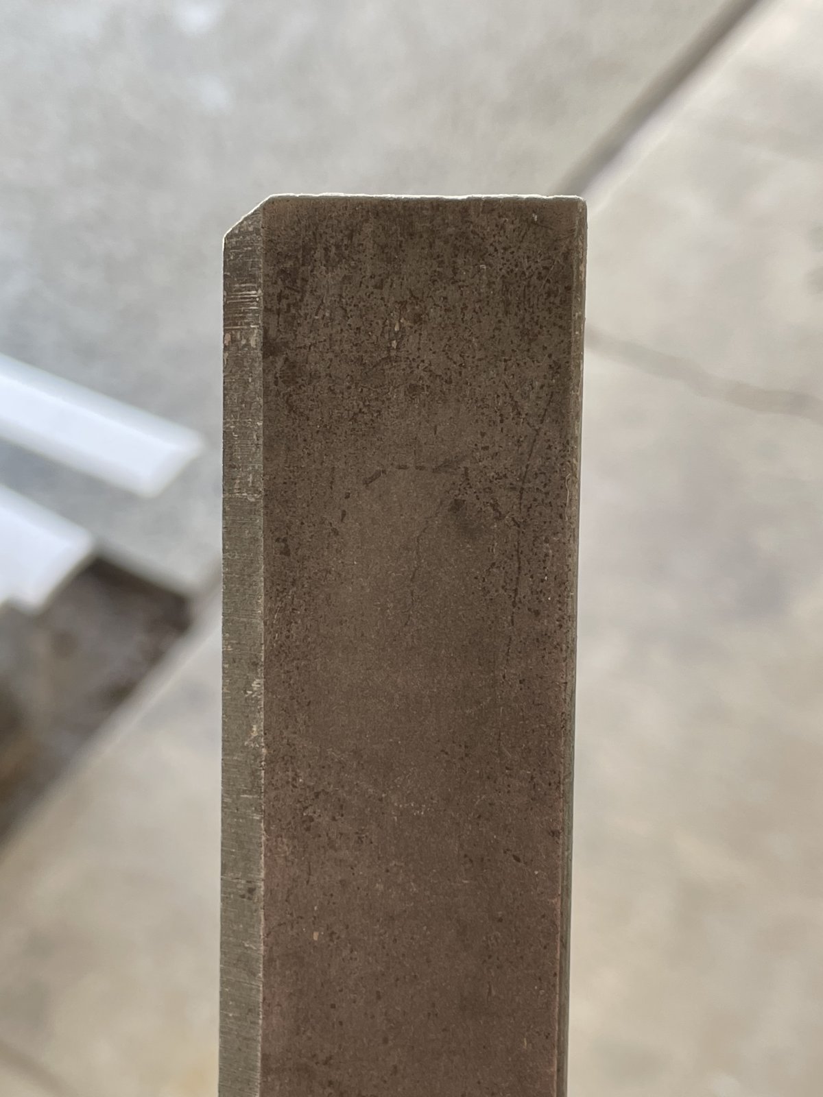

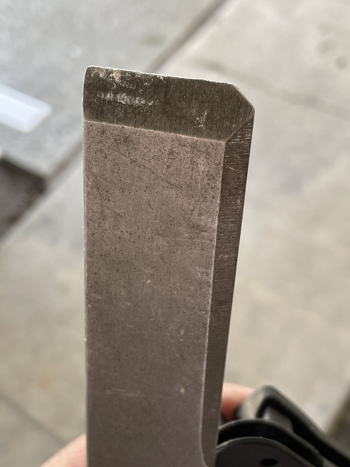

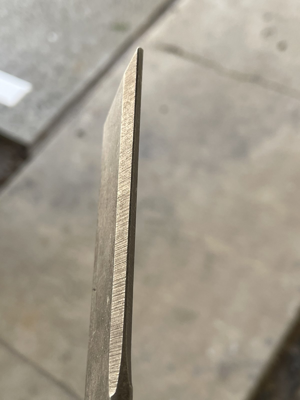

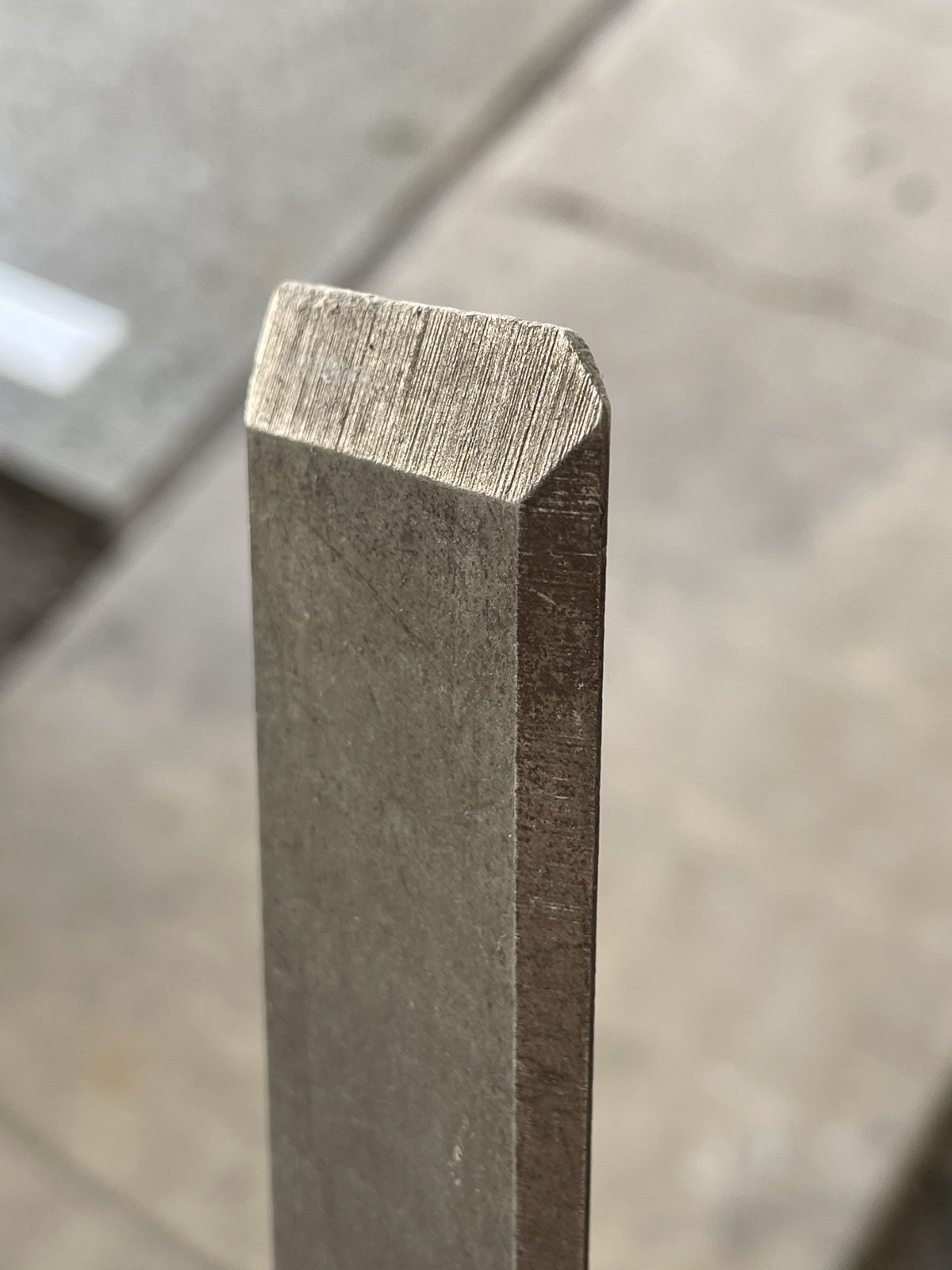

I have the full size EOD Robotics pry bar in steel from CountyComm. It's been through a beating with a few demolition projects, but very little dings are on the edge. I also have the mini version but haven't used it as much. I haven't struck any ferro rods with it, however I wonder if the bevel is different on yours? Mine still has the factory bevel and was never sharp by any means (actually has a 1/32 inch flat surface where the bevels meet). It could also be the steel and heat treatment are different.

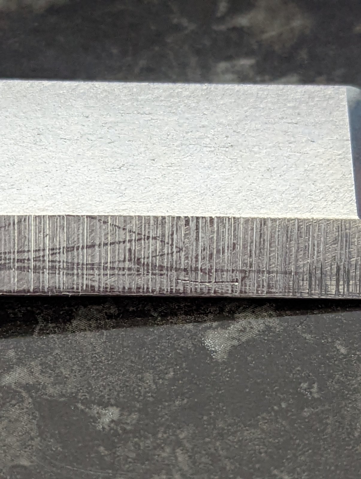

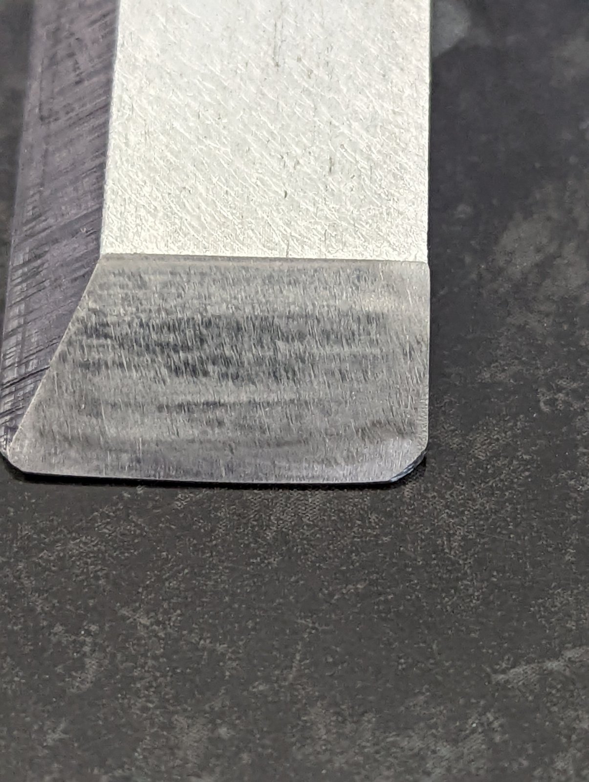

Thank you, that is interesting. The end of that looks pretty good if it has been used a bit.

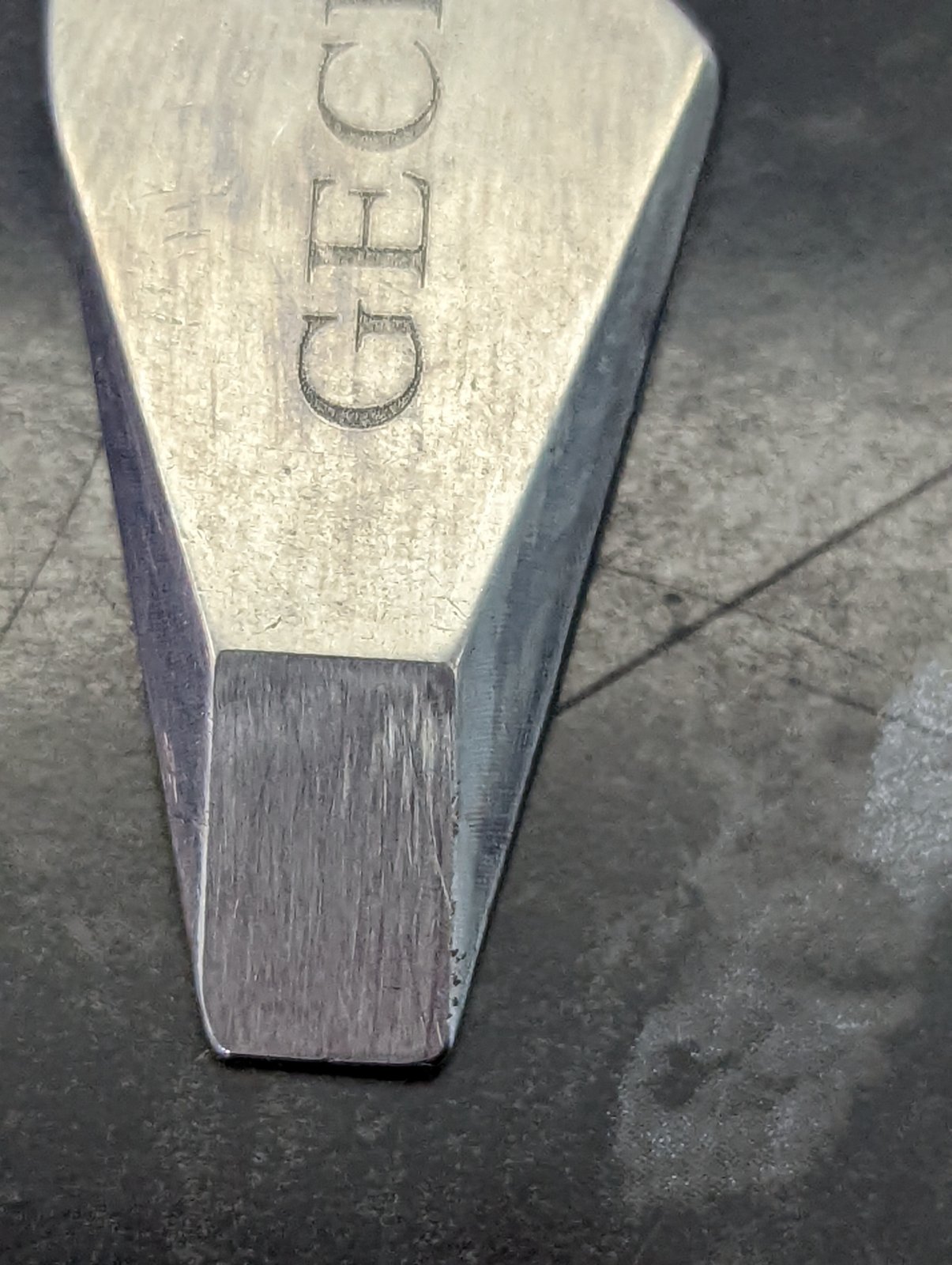

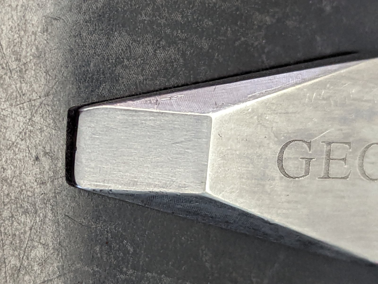

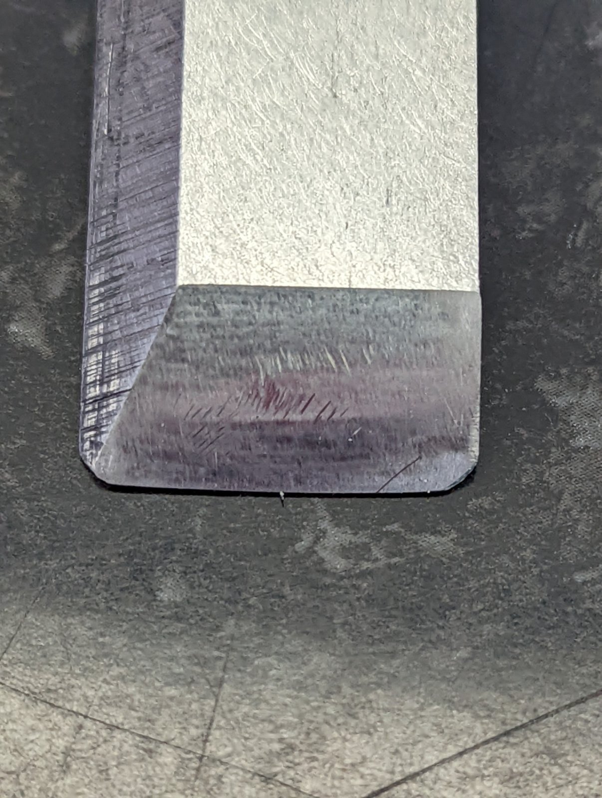

By way of an example, I just polished up the end of this one (the grind marks as new were similar to those shown on the side picture) and then pulled the file (metal not diamond) from the Leatherman juice across the end with its own weight. The file doesn't skip as I would expect for a hardened metal with no weight on the file, instead it cut some small marks. I tried similarly with the little Gecko one and the outcome was the same or slightly better. Not that I care about scratches, it was merely to indicate how soft the metal is. The marks on the side are where I tried running titanium bar against the steel one - they appear to be indented marks in the steel rather than deposition of titanium.
It will obviously work as a bit of mild steel and it is certainly thick enough not to bend under hand pressure but, particularly for the cost, I was hoping that it would be a little harder than it is. Like your EOD shown above, there is a flat of around 0.5mm around the edge so it isn't sharp but it doesn't have the same back bevel that yours displays.
