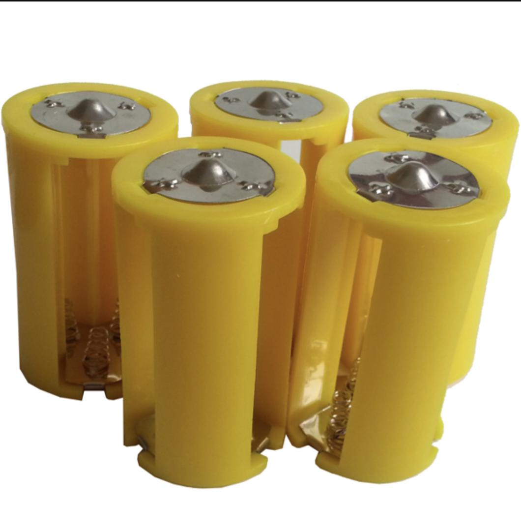

I also have some doubts concerning the build quality of the 3AA to D adapters I see offered for sale; are they an electrically-sound choice?
I've got a bunch of them in the following style, purchased on the 'zon. They've never given me any trouble. The maximum current I've demanded from them is ~2A; seems like they'd be good for more but I can't say for sure.
I had those adapters, they are good for 1A, they will work with 2A as well, but springs will heat up, there are some voltage loses, anything made for consumers with coil springs, especially with thin wire springs is only good for 1-1.5A.
Once i ran 4 nimh AA in a 4aa holder, to power an xml with a 8 amc driver, springs got so hot they melted plastic holder housing, and it was only 2,8A
I did the same once with an 8xAA flat holder except my error was shorting the output terminals - took all of about one second for the strongest spring against the weakest part of the plastic to melt through. Was a different, weaker, cheaper type of plastic than these holders and as 3x parallel adapters the current through each AA contact will be ⅓ the total, however I will defer to experience.
