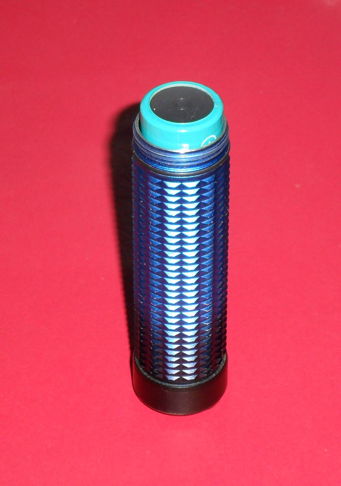

Used my Olight while working on my car in 16F temps last night, switched over to a H04 headlight leaving the Olight off but still attached to the underside of the hood for about 45min. Finished up, the headlight was slightly warm from the runtime, Olight 16F. I took the battery out & left it apart to reduce the chance of condensation as it warmed up in about 72F temps.
This morning it's dead as a door nail. Battery still works in another Olight BUT in the Wm3 the battery no longer drops in flush with the body. I tried a different battery that has worked in the light before that is slightly shorter. It dropped in flush, not slightly below like before but at least the light head screwed down completely. Nothing. Both switches click / feel like before but nothing. Cleaned the contact area on the body & head, nothing. Nothing in the head or tail look out of place or damaged. WTF??
Any ideas I haven't tried but should?

C&P my post to Olight CS USA. Will post updates as I have them. To be clear the battery is fine, works & charges in my S2R. The battery does not fit into the body as before & I can see no outward appearance of damage or cause in the body or tail switch.
Olight ask for pic & had me fill out online form. Took a couple of tries to make then understand the battery was fine.
So Olight sent a return tag, got in the mail Monday, less than 4hrs later I had an email that a replacement had been sent, w/tracking. Still no idea what broke / caused the issue but the CS is scoring well at this point.

Got my replacement Warrior today, quick CS, solid A grade BUT I asked if they knew what / why killed the old light. It's not recommended to use the light below 0c or 32f for us Americans, not sure if this just applies to the Warrior Mini 3 or all Olights or just lights with a tail switch. It looked to me [see pic] that something had displaced in the body as the battery no longer fit even with the tube. Only things down there is the switch & charging point. Would not having taking the battery out as it warmed up to room temp stopped "this" from happening? Ideas?

Couldn't find my manual so I checked online, sure enough the temp range in the pdf is 0-40 C. Again to be clear the battery that was in the light is fine, something in the tube/body changed. I couldn't tighten the head enough to make contact for a circuit
