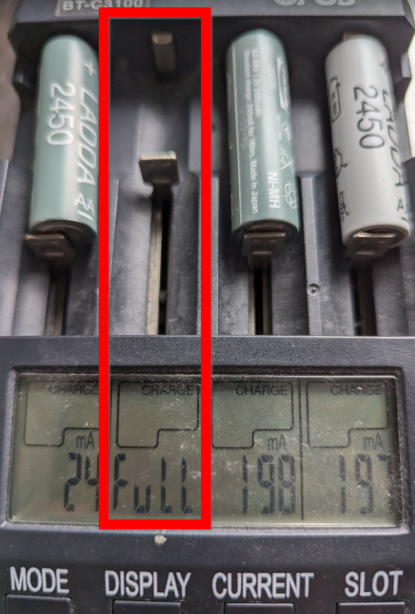

I have a. Opus BT-C3100 that says that the charge is full even when I don't have a battery connected in the slot. Anyone got an idea on how to fix it?
Sorry to hear. I haven't seen or read of this issue before and can't really help, but this doesn't strike me as being very encouraging just on its face in terms of resolving it. (I assume this is a 'hard' (not intermittent) problem and does not clear w/ power-on reset, vs one which can be cleared but then recoccurs on subsequent operations.)
Restarting the charger doesn't help unfortunately. Maybe it's just a good reason for me buy a new charger instead :D

I had 3 of them which failed within 2 years of use, so it's probably time to toss it. One of them made a battery go thermal. It's a good thing there was fresh snow out the window

Yeah, no need to mess around with a charger that behaves like that.
