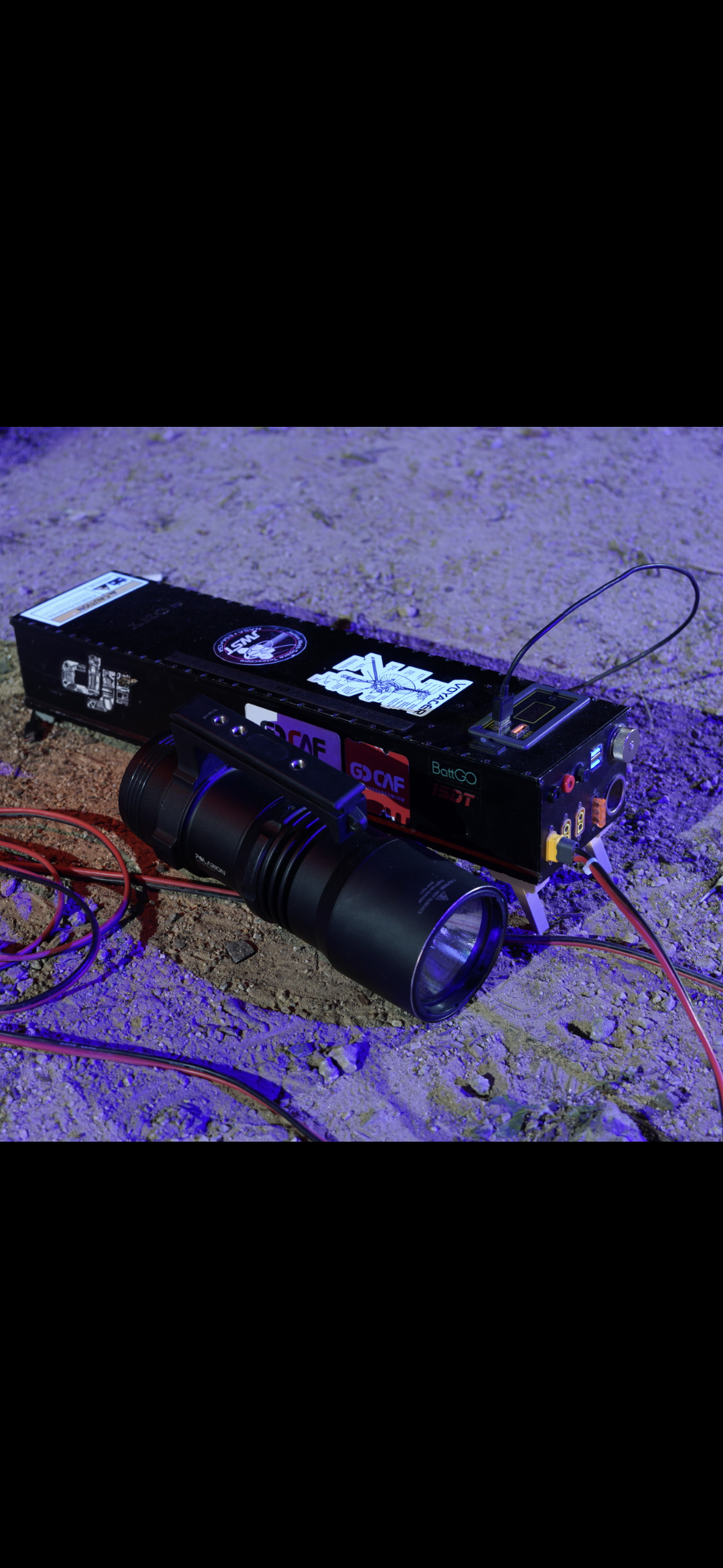

This is my abyss dual.
(60w power-up tuning applied. Polarion, does not offer power-up tuning, but I personally performed it)

60Watt Abyss……outstanding!👍

About 60W :
polarion ballast efficiency is near 90%. So if try overdrive the lamp, you may add +10~12% more power.
Hmm.
I have the abyss.
Overclocking, how hard is that to do?
Any long term damage to it by upping it to 60w?
Hmm.
I have the abyss.
1. Although the difficulty level is easy, it requires toxic chemicals and knowledge of electronics DIY. (The potentiometer may need to be replaced if damaged.)
2. ballast and lamp can actually handle a significantly larger capacity than expected. The problem is the battery. When a Polarion overclocked to 60W or higher is operated in a warm indoor environment, the stock battery's protection circuit can overheat and completely fail. (It must be used only outdoors, as air flows freely.)
This applies not only to the Abyss but to all Polarions. I overclocked an X1 model to near 100W, and the battery protection circuit failed in less than 15 minutes indoors.
A 70W overclocked model (X1 + Abyss style modification) had been fine outdoors for several months, but the battery protection circuit failed after I accidentally operated it next to a warm heater.
The Abyss 60W I am currently using is a model equipped with a separate 4S BMS.
3. If need....super overclock polarion....
