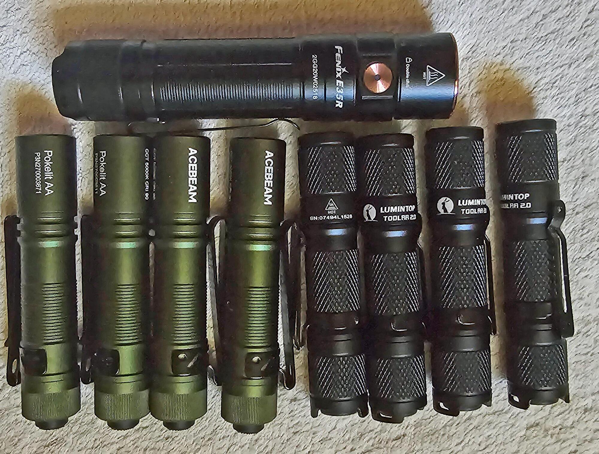

So.... I couldn't decide on one.... :unsure:so I have ordered the Lumintop Tool 2.0 AA (3 weeks for estimated delivery on the white one I liked, so just the black one with XPL-HD) and the Acebeam Pokelit AA, expected delivery for both is about 7AM tomorrow! :LOL:
Also ordered the Fenix E35R EDC 21700 based flashlight :D
Already found a couple of negatives:
Acebeam: if flashlight is already on, you have to turn it off to switch output modes o_O
Lumentop Tool: With 3.7V battery installed, the tail clicky has a blue light on while the flashlight is off. Doesn't seem to be there if you have an alkaline battery installed or maybe it's just too dim to see
Lumentop came without batteries, at least the Acebeam's did come with Acebeam 920mAh 14500 batteries!
So far, the Fenix is nearly perfect. Came with the Fenix 5000mAh 21700 button-top battery, and works just fine with my 3mm shorter flat-top LiFePO4 21700 batteries, but will only do turbo mode with the Fenix battery... On high mode doesn't even get warm after 10 minutes!!!
Hmm. Didn't know the Tool 2.0 came with any kind of auxiliary light. Mine doesn't.
Sounds like your ideal AA flashlight turned out to be a 21700!
Maybe check the Amp rating of the 21700 that won't run turbo. Could be under powering the light. Or maybe Fenix lights have a prejudice against unprotected cells, or can't handle the shorter size w/o the tail spring heating up? Hard to say.

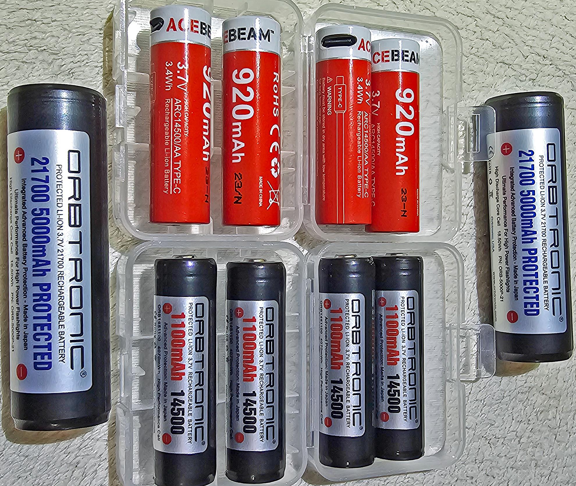

Just got the package from Orbtronic! Their 21700 protected batteries are the exact same length as the Fenix (y) I have the new batteries on my chargers, so it'll be an hour or so before I test them out.
I didn't notice when I placed the order, but those 1100mAh 14500's are also protected!!!
