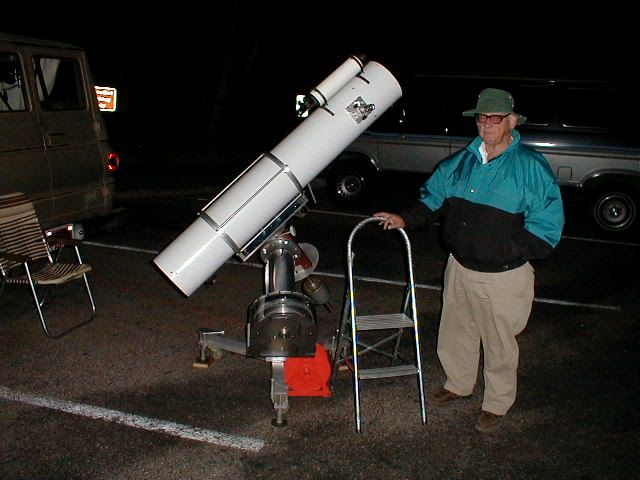

I remember a trip me and my wife made to Grand Canyon about 13 years ago. We passed by a group of astronomers with all this custom made telescope. I was so impressed with their telescopes I decided to take a picture of one forgetting about their dark adjusted eyes. As soon as my camera flashed all of them started screaming at me. I then apologized. I was lucky they didn't threw me off the cliff. LOL This was the picture I took.

But OTOH - judging from the pic - they were happily expecting a picture being taken :)
