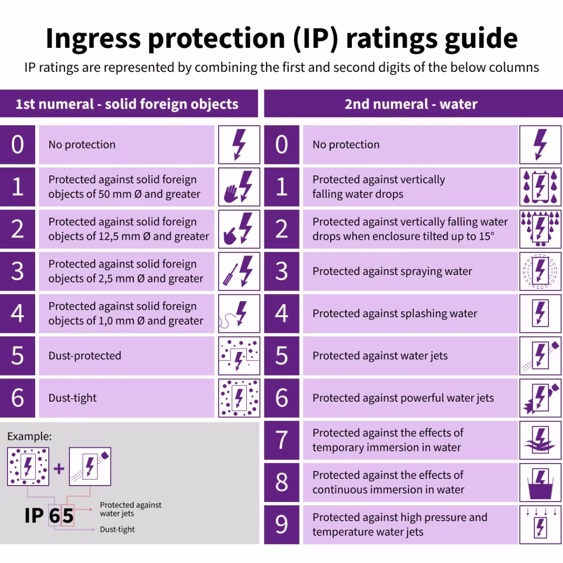

I cant really specify a light for you as there are thousands that will fit your criteria. I will however touch on some features you may want consider. Since you mentioned the light will be used for short bursts you should consider a light with a momentary on feature. This is a light press of the switch that makes electrical contact without locking the switch in the on position. In the long run it will save wear and tear on the switch mechanism. Given the fine metallic particles I would avoid any light that requires a twist activation as the particles will slowly work their way in along the threads with each activation. This leaves most MAG Lite's out unless your willing to clean and re lubricate the threads frequently. You don't specify the ingress protection against liquids but I would think this may be a problem on a work bench so I would suggest a light rated at IP67 or 68. The table below will explain the ratings if you are not familiar with them. Lastly I would avoid any light that uses AAA cells. They are more expensive and have much less capacity compared to AA so you will need to change them out more frequently. If you get a light that uses rechargeable cells like a 14500 or 18650 you may want to get an extra cell so you can rotate them, one in the light and one in the charger. Lights that need to be taken out of service to charge are a pain. So are lights that require a proprietary cell. I avoid Olight like the plague for this reason.
