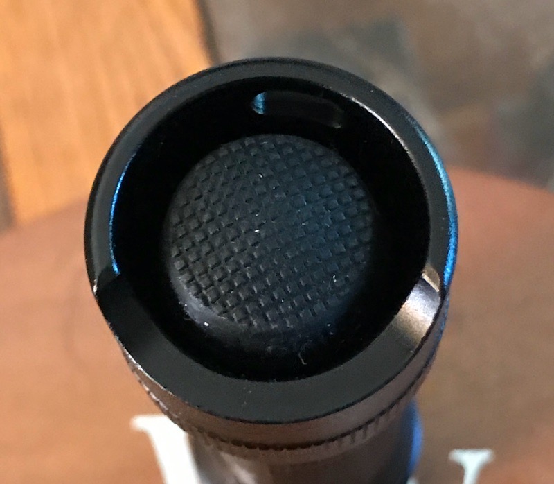

the e-switch is quite small

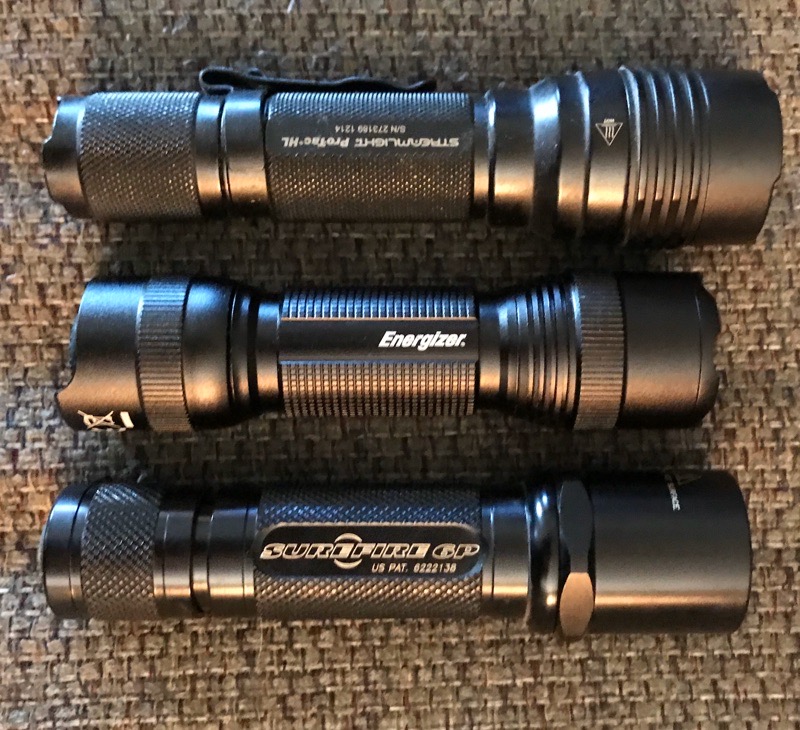

bought a new 6AA 1300 lumens version...
comparison to 2AA...
this is a newer version (not talking about brightness nor number of batteries) as Energizer has put something called "digital focus" in the control circuit. It alternate between the lone flood optics and 2 TIR optics by holding down the switch when the light is on, as a result, you can somewhat have "variable brightness" while the light is alternating between the optics. An interesting idea indeed. Kudos to Energizer for creativity! :thumbsup:

Thanks for sharing, I'll probably grab one of this as a good "family light" if they are available where I live.

Great find ! Curiosity got the best of me and I picked up the 6 cell model. It was in a set with a 3XAAA headlamp for $30,a good deal for the money based on the initial quality and it is nice to see that Energizer put some thought into this light. The knurling gives it a "stylish" look but I don't think it provides as sure a grip as I would like. The tail cap could definitely use some knurling instead of being smooth. I was able to screw it on but it is too slick IMO. My example still seems to be on the cool side with the hot spot but it is not horrible or anything. There was no Daylight Color symbol on the packaging for my light but it did mention the "high def" design.
Nice to see this kind of light in B&M stores aimed at the average consumer. :)
EDIT: After a backyard trip with the Vision HD it seems much more neutral and I have to say I was impressed. The cool "effect" to the hot spot is only noticeable in white wall hunting and not in actual use. I probably see it more since I am so used to seeing 4000k lights with consistent tint and they have a little warmer color.
