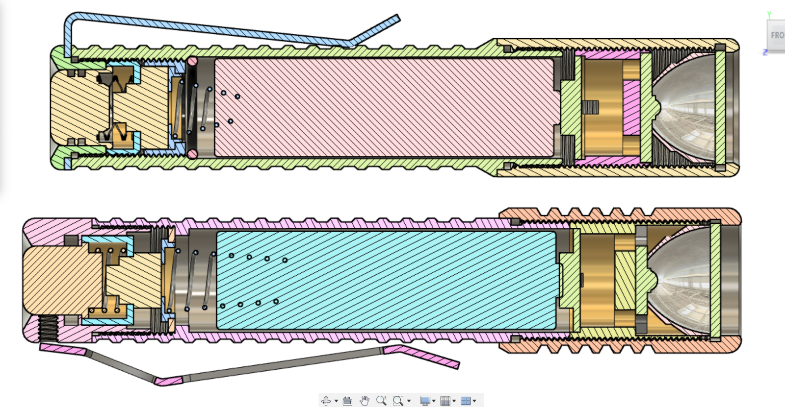

Good afternoon everyone, I'd like to share a project I've been chipping away at behind the scenes for a while now.

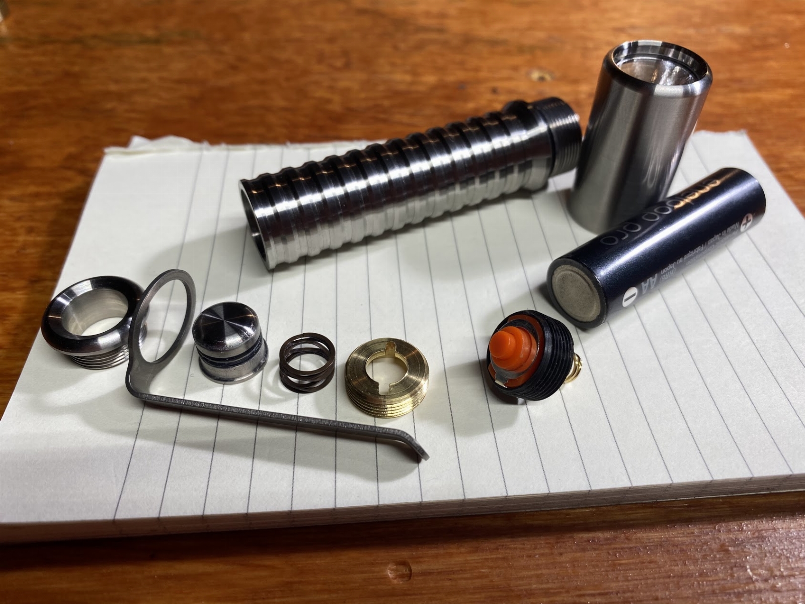

This is the "Corvus" project, a conceptual successor to the Hyperion, intended to eventually be made as a AA/14500 compatible light once a driver is available to use. Overall light design is shorter at ~100mm OAL and a bit skinnier than the Hyperion with a smaller 20mm diameter head. As usual for me, this is a manually machined custom light.

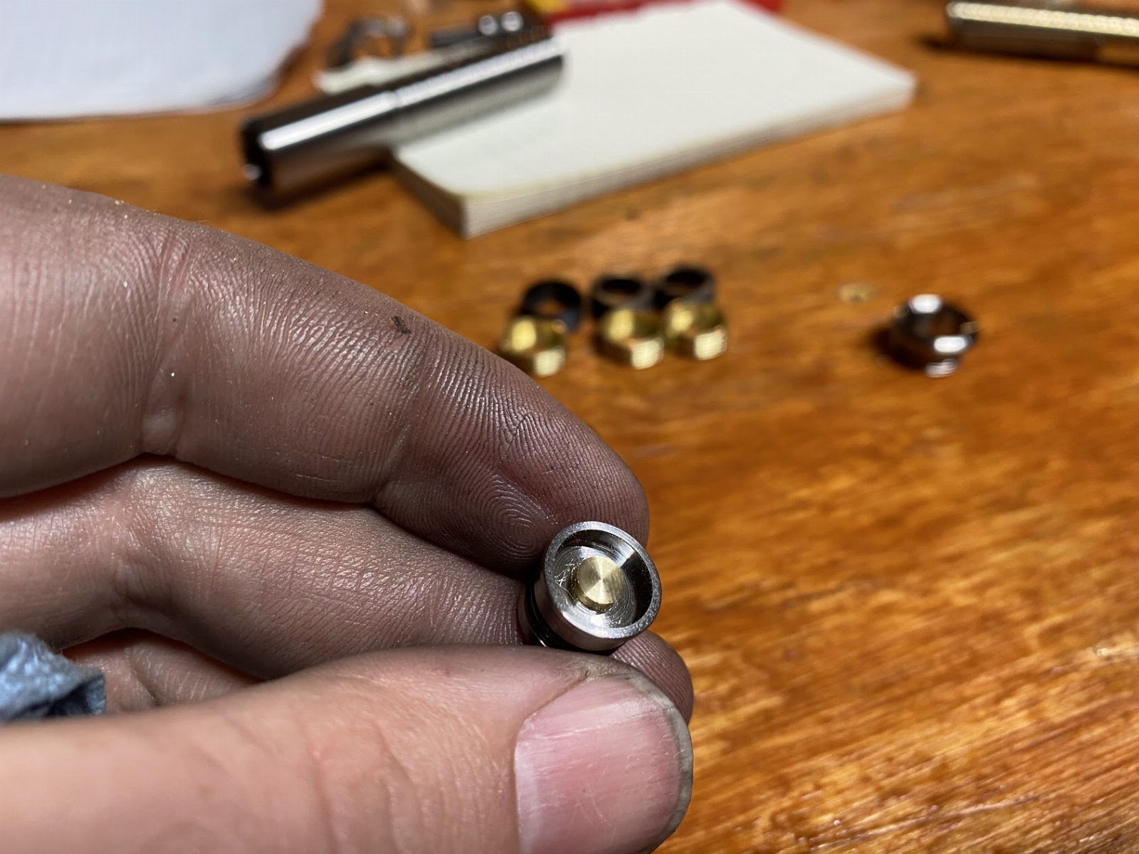

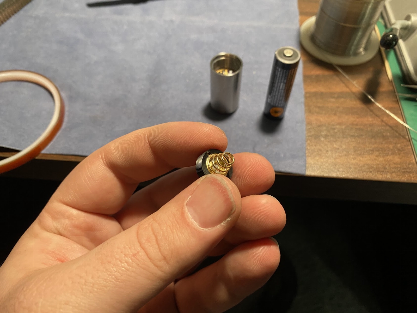

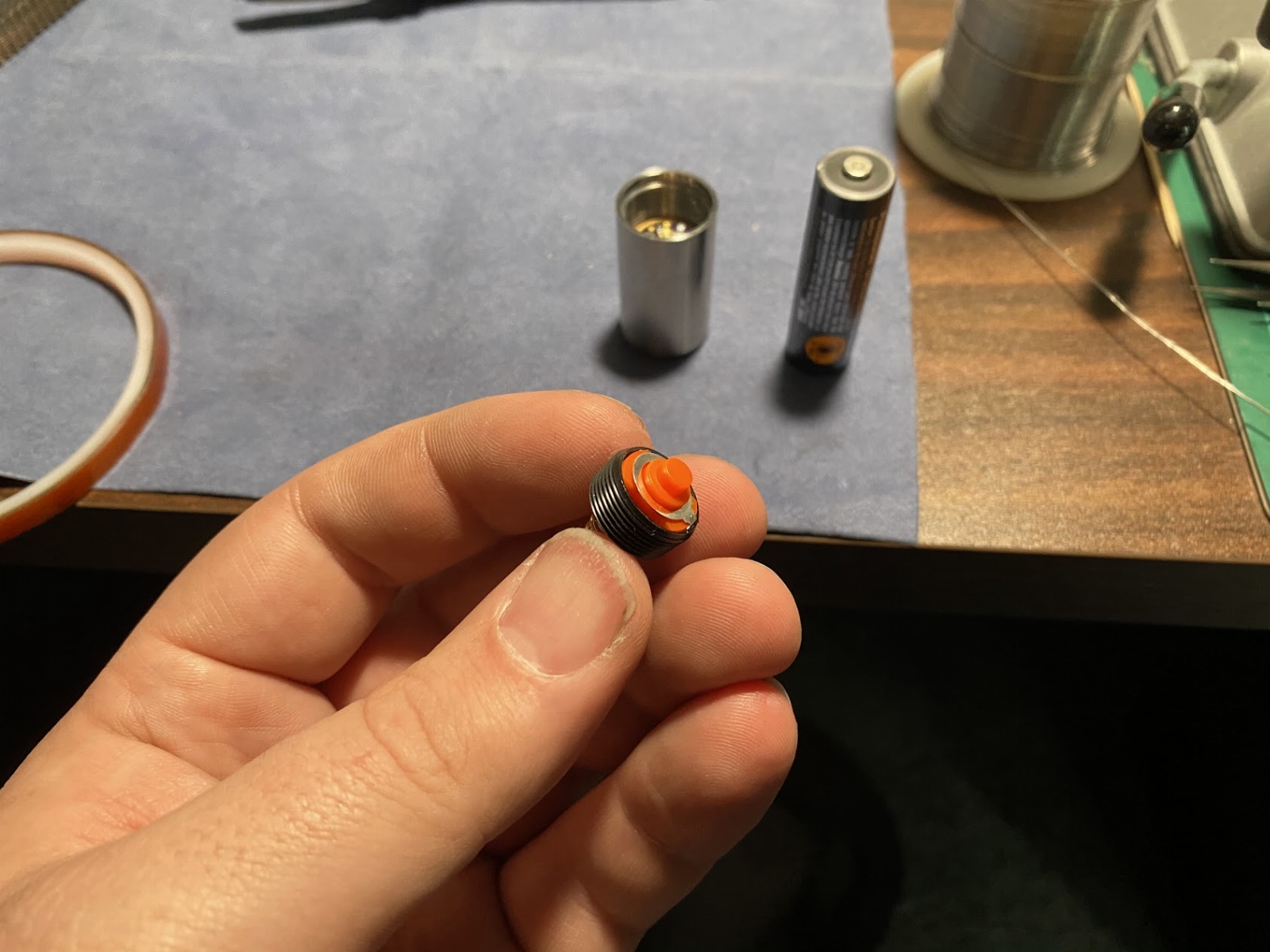

Intended design elements are a smoother and more compact variant of the titanium piston setup with a larger 11mm diameter piston, and a captive titanium deep carry clip. The assembly is powered by a compact wave spring which provides a smooth firm resistance with a crisp "break" at actuation. The whole switching assembly while a bit more complex in machining terms due to the brass spring cup and acetal isolator around the switch being threaded and slotted, is more consistent and stable in assembly with the switch forming a nice assembly with the isolator and spring plate.
The head and tailcaps interlock with the body where they mate up to distribute force and enforce consistent rigid lockup.
The reflector continues to be the excellent McR-16S which provides a punchy beam with a wide spill that makes good use of even moderate output levels.
Grip-wise I've wanted to try something a little different from my usual "Acme" grip pattern and plan to use what I refer to as a "Wave" grip. This uses a bit wider of a ring with shallower chamfers, the result is a less abrasive grip which still provides a solid tactile grip.

I think that would be appropriate, the Corvus is the successor to the Hyperion in my mind, it takes the concepts and improves or fixes all the things that bugged me with the Hyperion. Reduced diameter and length, smoothest piston actuated switch I've done yet, simplified tailcap geometry, easier to service mail seals for the piston, easier to control seal pressure, better supported and more consistent switch/piston assembly, easier switch replacement routine, and a deeper clip arrangement.
The new seal arrangement also got rid of the "lock-stick" like effect where the x-ring would lock the piston in place in some of the tighter sealed Hyperions and require a firm push to release it.

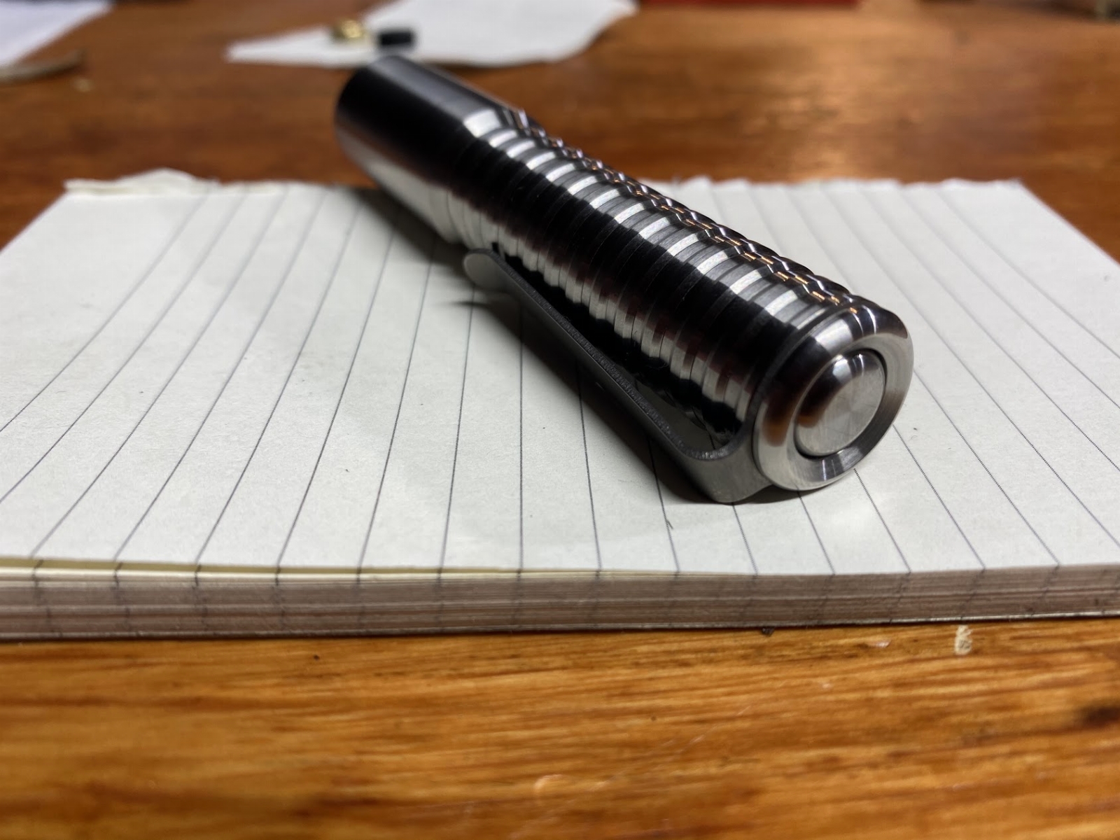

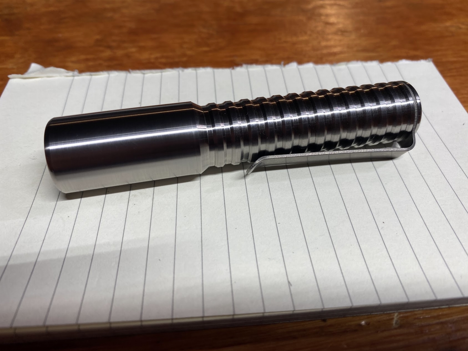

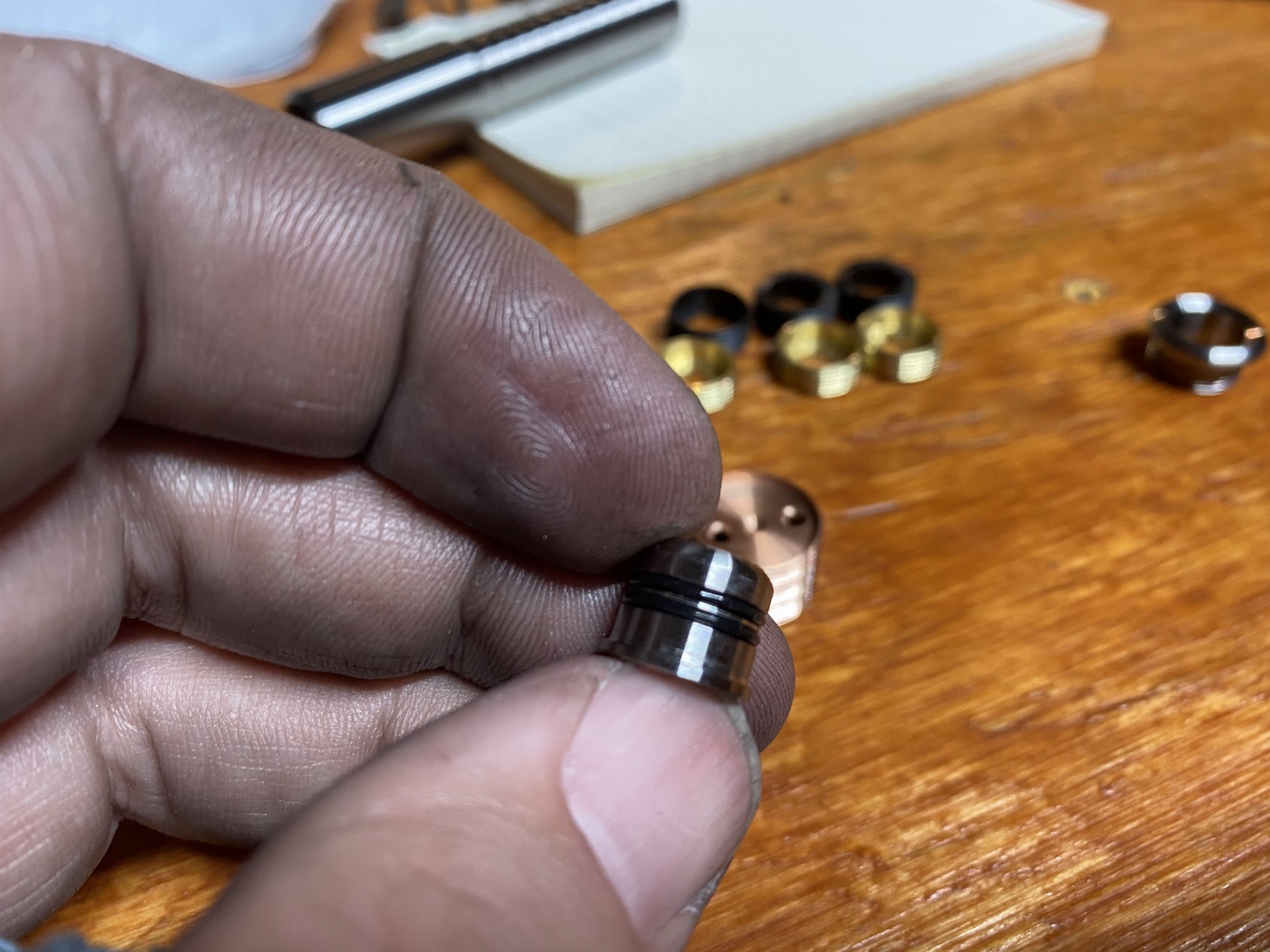

A mechanical update on the Corvus design. Piston design is holding up very well, minimal wear on the sliding surfaces of the piston setup, with grease still well-retained. Roughly 5 months and at least 2000 piston cycles, sliding surfaces are still polished and greased for an action as smooth as the day it was made.
ACtC-3ehAfnkZ-hpLRjoZ33n5inYsvwSqtc2p189nX137Amu1oSFz4otwf4NKDECemXsg1ZQGq8TcM3HlZBj0ao1PhmMma8z0Thp64pm98KLliEuItw2rator89_zEzFvRDQCeV_PZEiItC8gFAKF99JqoNYFg=w1854-h1390-no
ACtC-3e4mFvh9nMI86vnLYuSZGr8WBPRX9y_c-AuNWrupVMerK7aGUf_soFlfkvd_dackDSWx1QDFQb8kejbX3sMlass15uoahUyJy5KHLm8zThe-6H2sl_8eRqnOK3LINW4uXQDo93YtjGGa5BZlsSMfjYY2A=w1854-h1390-no
