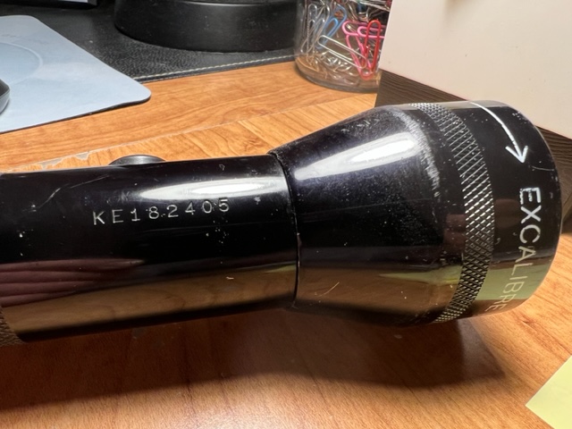

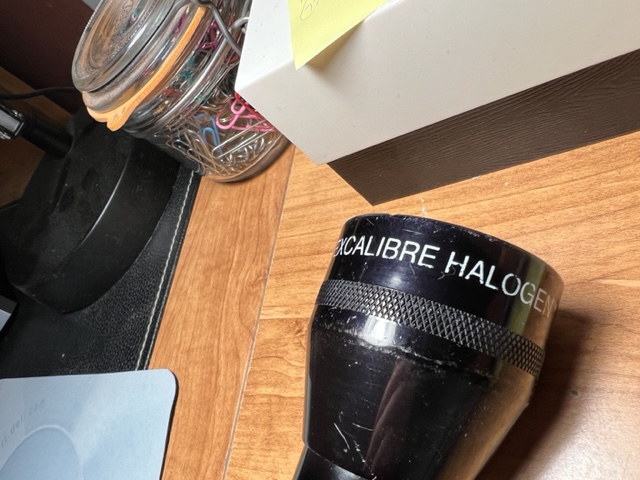

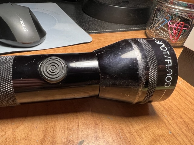

See post 8 for some insight but not a direct answer to the size of the missing o'ring.
The title of this thread causes me to think it's an excalibre you have William. I pasted a link above to point out a 4D Streamlight and a Streamlight excalibre were completely different flashlights.
The tubing of the Streamlight 4D is thicker than the excalibre that was more along the lines of a Brinkmann Code 4.
The excalibre was a Streamlight attempt at a lower cost 'cop light' by lowering the cost to produce it. A Streamlight 4D on the other hand was a 3rd gen Kel-Lite in essence. It was a Kel-Lite with a push button switch and Streamlight stamped on the tail cap where Kel-Lite used to be prior to Streamlight buying Kel-Lite.
The Brinkmann Code 4 was once an LA Screw Code 4 and when GT Price bought LA Screw they also focused on lowering cost of production. Later when Don Keller went to work at Brinkmann he bought the designs and rights of GT Price products. He never built the Code 4. It was built by Brinkmann post Don Keller.

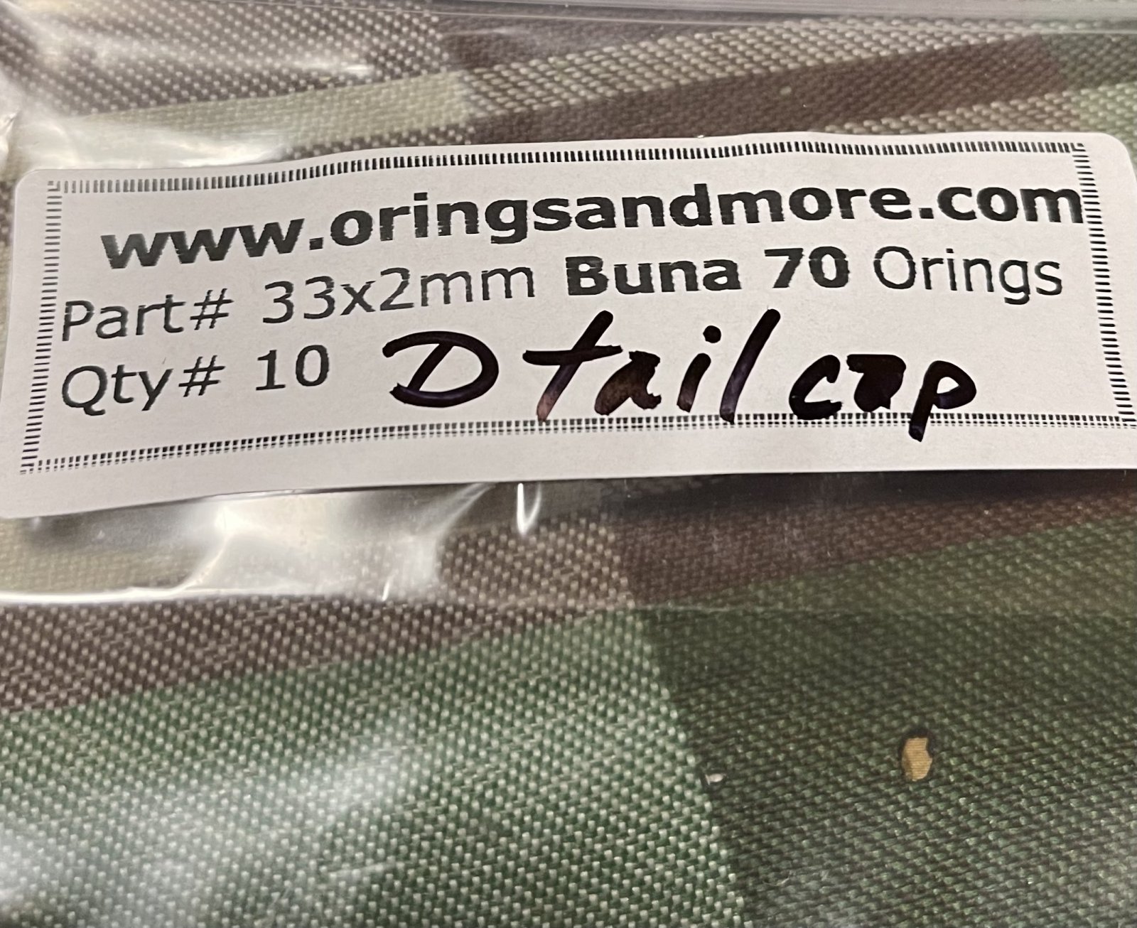

This size o'ring will work, in either light.

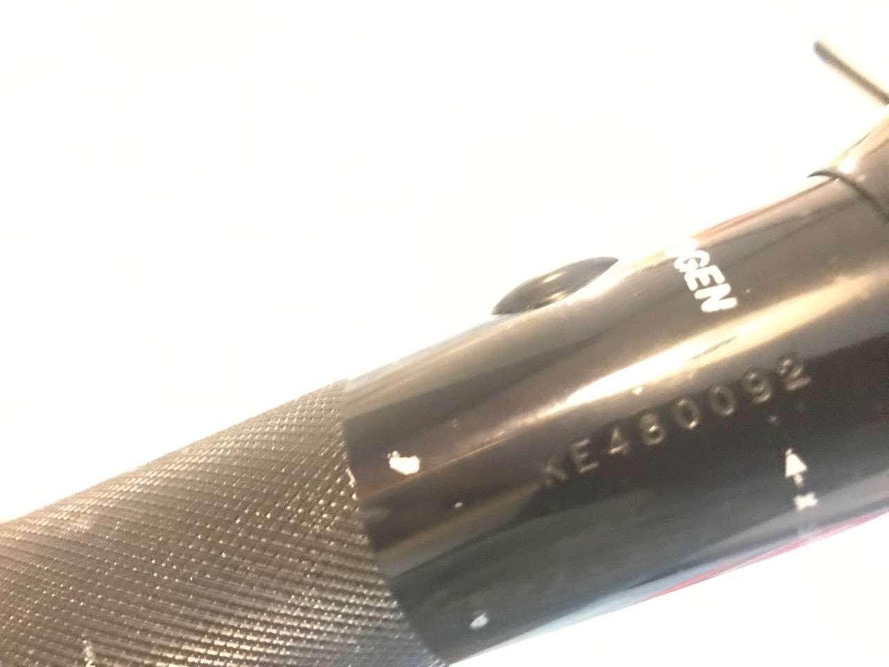

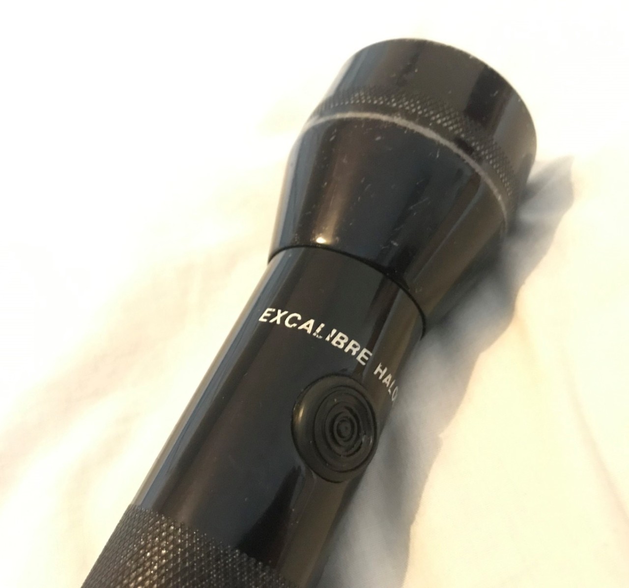

Yes, it was an Excalibre. The white writing is around the barrel, just above the switch, KE480092 serial #.

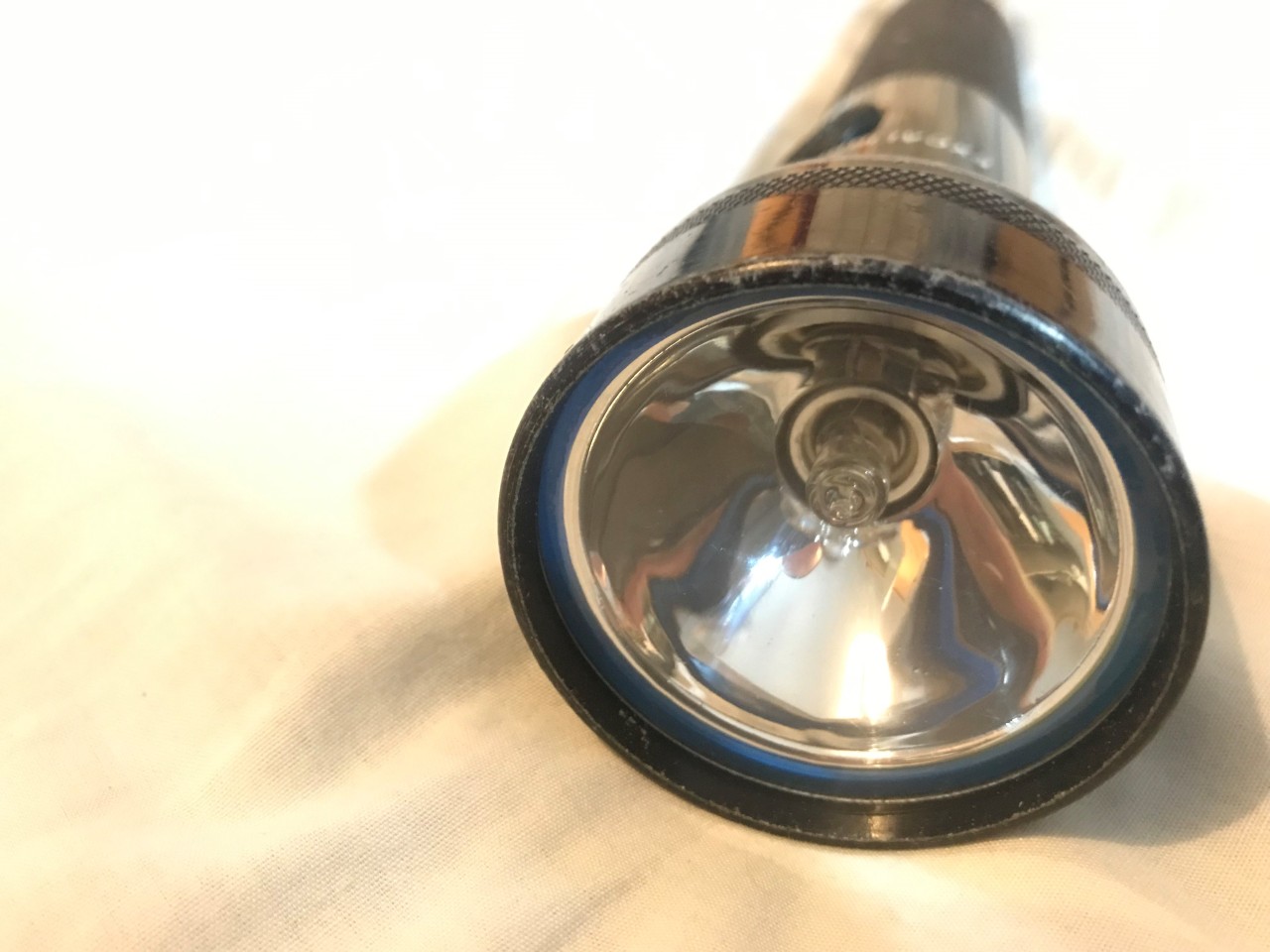

The reflector and inside of the lens were covered in dust, so after some research, and with trepidation, I immersed the whole head section into an ultrasonic tank, then rinsed with de -ionised water and dried quickly with a hair dryer. Came out undamaged and much improved.

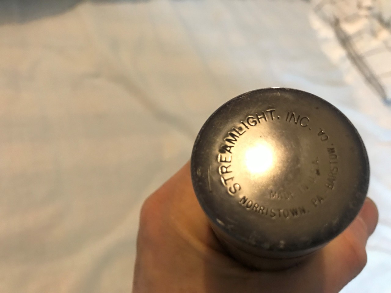

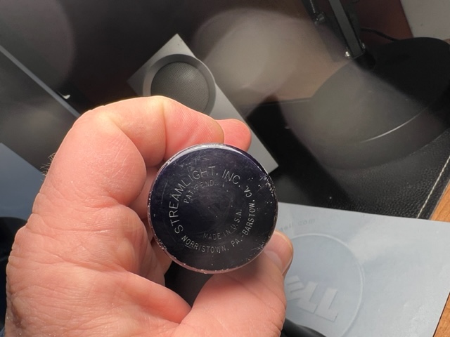

Sorry , struggled tying to get photos on here. Are you Jason, with the very informative blog?
William's pics. They highlight an issue identifying these lights. The Excalibre and focus markings on the body flake off and a rough cleaning could erase them all. It'd be interesting to know how many lights actually got them. The early KD's were Kel-Lite II's (as advertised--they never were marked as such) and the later ones were bezel-marked Excalibres. KE seem to have been a mix of bezel and body marked, KF was body marked, and I'm unsure about later ones. I'd like to get a full set of clean painted lights but I haven't lucked into many yet.
This style flashlight (with and without the markings) is the common style of D-cell Streamlights you find now. You'll find them with one-piece heads like this or the slightly earlier ones with separate bezel rings. The older Kel-Lite models have larger bodies and different knurling patterns on the head and tailcap.
Awesome, thanks for the pics. Now that you've posted that I'm going to correct my earlier post. I actually do have one of those with bezel lettering, and it's nearly worn off like I mentioned. KD prefix too. Found it in the part of my collection I haven't touched since I moved 13 years ago.
Bought some of those 33x2mm o rings for my missing tail cap one, but unfortunately they are too big. Ordered some 31 mm ones.
