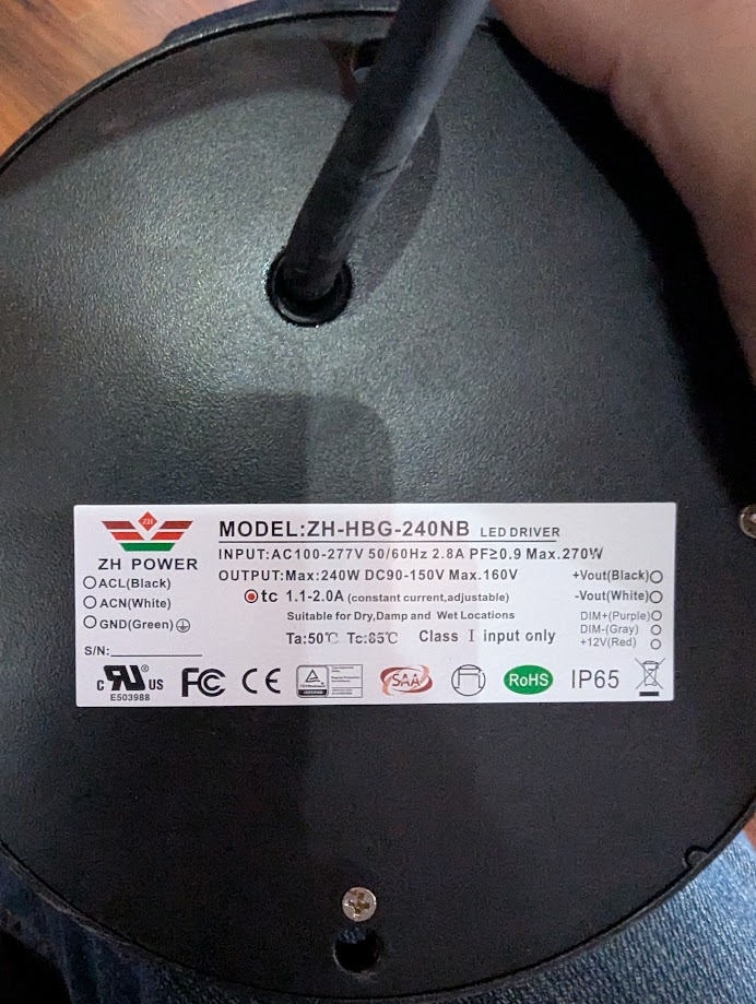

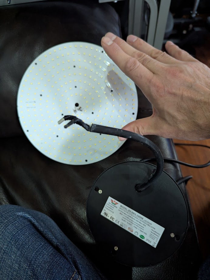

I just disassembled a stage light that was retrofit with this 240W LED panel. Want to build possibly a ridiculous cannon of a flashlight or something with it. its 9" across and the LEDs are only about 1/4" apart. so micro reflectors might be tough.
I would love to make a searchlight of a beamer... but not sure how easy it would be to focus this, if even possible.

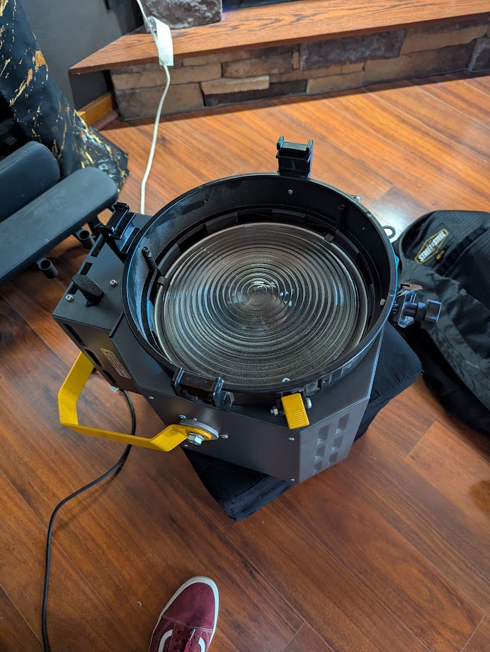

Throw it in a aircraft searchlight with beam smoothing and a giant fresnel lens?

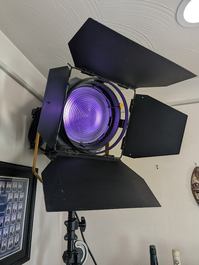

actually kinda what it came out of. A stage light with a fresnel.... But that was a big heavy light. Want to try making something a BIT mor portable.
And the old light is becoming a display piece so it didn't need its guts anymore

are those clamps on the old housing for mounting light filters? Also, I just thought of something that might be cool for aesthetics and not necessarily function...an indirect lighting wall mounted "floating" moon with a motorized blocker that reveals the moon phase

Yeah Barn doors and gels can be attached. its primarily or was a stage light. now it has a Phillips Hue bulb in it.

I would use Blender. 288 LEDs is AI counted correctly (I was NOT going to count them quite yet) looks like they are about 8.5mm centers though oddly there is a bit of fluctuation by a half mm or so through the different rings.
So any reflectors I could fit on them would be tiny
A compromise. Instead of individual reflectors make them ring shaped troughs for each ring of LEDs.
