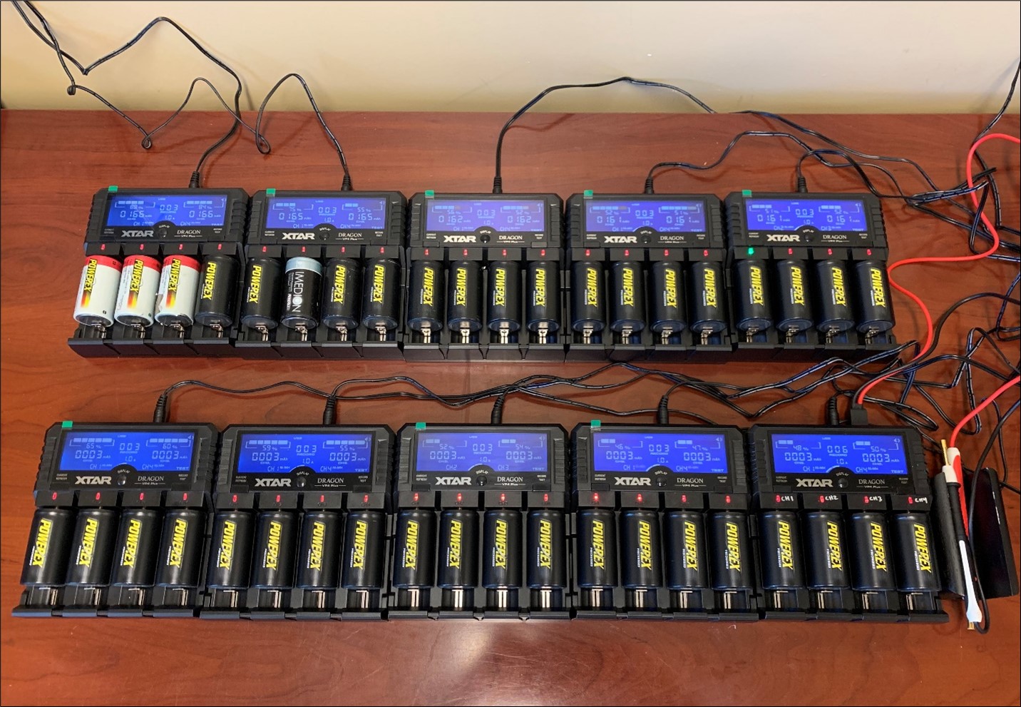

I use rechargeable D-cell NiMH batteries at work, and we own about 400-500 of them. The ones I settled on are the PowerEx 10,000mAh low self discharge D-cells. They power our devices in the field for months. For charging and testing, we have ten XTAR Dragon VP4+ units, and we have been very happy with them.
Who is your company supplier for PowerEx cells?
I know AA PowerEx are made in Japan but not sure about their C or D-cells?
Thx..
pendragon1998
Oct 8, 2017
10
Thx..
The battery said tested and assembled in Taiwan, made in China - whatever that means.
I think we generally buy them off Amazon, actually.
