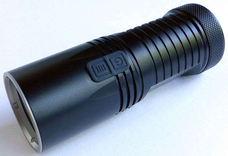

    Taking a more detailed look:
    The photos here show; the packaging, contents, size in relation to an AA cell, tail-cap, LED, reflector tail-cap contacts and locator rods, battery tube with locator holes, tail threads, internal contacts, battery tube with four AAs loaded and the EA41 with the D4 charger getting ready to go!

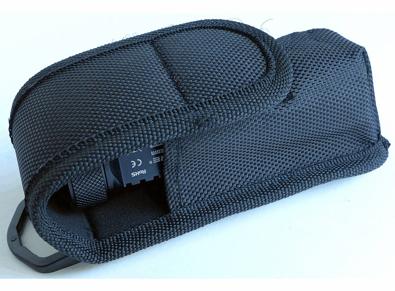

    Moving onto the EA41's holster to show the fittings on the back as well as the front view:

    Modes and User Interface:
    One of the key differences between the EA41 and its predecessor the EA4 is the change from a single two-stage switch to a two (single stage) button switch. As much as I liked the NITECORE two-stage switches, they can become a bit 'tricky' from time to time especially if using gloves.
    Personally I find the new layout far more intuitive and much easier to use. There is direct access to maximum and minimum modes as well as simple activation of the locator switch illumination
    The two buttons are the Power and Mode buttons.
    Pressing the Power button will switch the EA41 on and off, returning to the last used steady output mode. When on, pressing the mode switch cycles through the steady output modes.
    When on, pressing and holding the Power button for more than 1s will put the EA41 into standby mode which flashes the switch illumination to act as a locator beacon. This is disabled the next time you switch the EA41 on and off, so if you wish to have the locator function showing you need to switch off by pressing and holding the power switch. (Note in this image the flash frequency appears slightly faster than it really is)
    From off, there is direct access to Turbo (using the Mode switch) or Lower (using the Power switch) by pressing and holding the appropriate switch for more than 1s.
    Special flashing modes are accessed by pressing and holding the Mode switch when the EA41 is on.
    The EA41 has a lockout mode as well. When on, lockout is accessed by pressing and holding both switches for more than 1s. After switching off, the EA41 gives one bright flash to indicate it is entering lockout. To exit lockout press and hold both switches for over 1s.
    These are just the main features, for more detail see the full user manual here:
    NITECORE EA41 User Manual

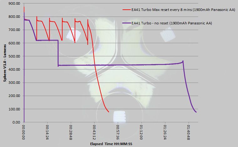

    The EA41 has a particular output profile with the Turbo output. After switching onTurbo, the output is held at nearly 800lm for 3 minutes after which it then gradually declines for the next 4 minutes to around 620lm, then maintains this for a further 13 minutes before dropping to 430lm (just a little less than the high mode of 490lm). If not reset, this 430lm output is then maintained as long as the cells will allow.
    For the runtime test I have completed two runs. One with the Turbo mode activated and then no intervention and the second run where the Turbo mode was reset once the output had finished the gradual decline to 620lm. Both are shown on the same graph. Cell voltages at the end of each run were 1.0V-0.8V

    Quote Originally Posted by Timothybil View Post
    Appreciate the effort you went to to get those numbers. They correspond very well with what Nitecore has in the EA41 User Manual.
    Standby Mode
    With the light on, press and hold the on/off switch for more than one
    second to turn off the light and activate location beacon function. The
    blue power indicator will flash once every three seconds to indicate the
    location of the EA41. In this mode, the EA41 can keep running on 4 × AA
    batteries for 120 days.
    NOTE: With the power indicator off in standby mode, the EA41 can work
    for more than 12 months with 4 × AA batteries.
    [Bold is my emphasis]
    Did you make your estimate based on LSD NiMH or alkaline?
    It is based on what I consider to be the most appropriate cell, a LSD NiMh and my test cells are all 1900mAh, so this is the capacity I use.
    When I talk about parasitic drain I always use the time to fully depleted, but of course the reality is that if it would take 2 years to deplete the cells, after 1 year you are down to 50%, so even this is not great as half of your potential runtime has gone down the drain. By giving the time to fully deplete the cells though, anyone reading my review can make up their own mind as to what is a minimum remaining capacity for their requirements. This might mean topping up the cells ever three months, or simply leaving the cells out of the light. There is no right way of dealing with parasitic drain apart from being fully aware of it.
    Another important factor is that I have come across many instances where parasitic drain increases as the cells become depleted, so a fully charged cell drain might be quite low, but as the cell voltage sags slightly the circuit starts to draw more power. I can't really include all of this detail as my testing would take far too long to complete.
