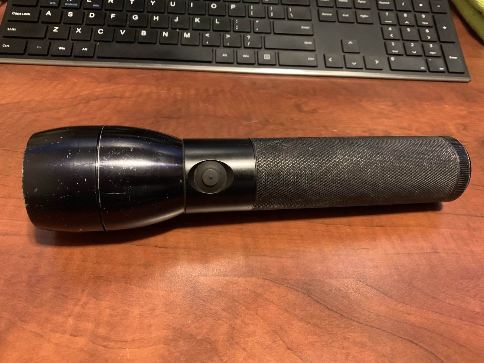

My dad passed a couple years ago, and for a while during his life he was LEO. I found this flashlight of his, and I'm interested in restoring (and actively using) it if possible. It seems to be a little unusual and my googlefu must be pretty weak cause I'm not finding much about it. It definitely has the look & feel of a good old vintage maglite, but not so sure thats what it really is. Several pictures attached.

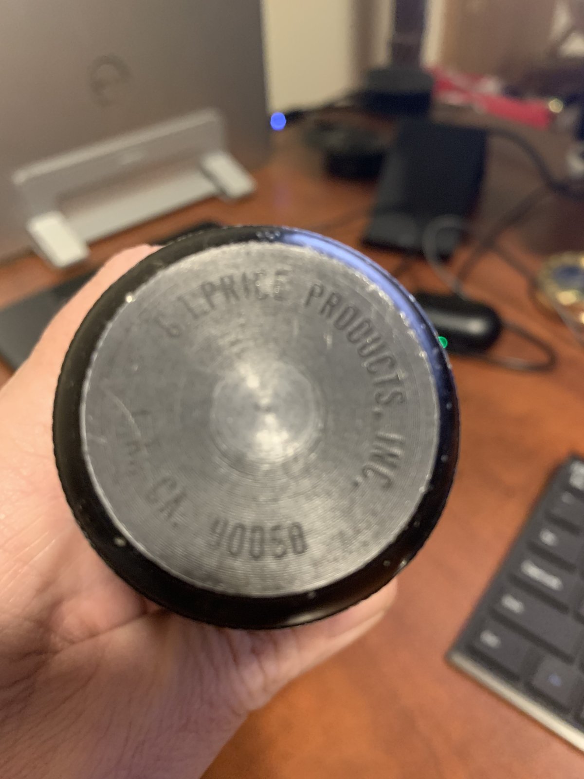

The butt is stamped "G.T.PRICE PRODUCTS, INC." and "L.A., C.A. 90058".

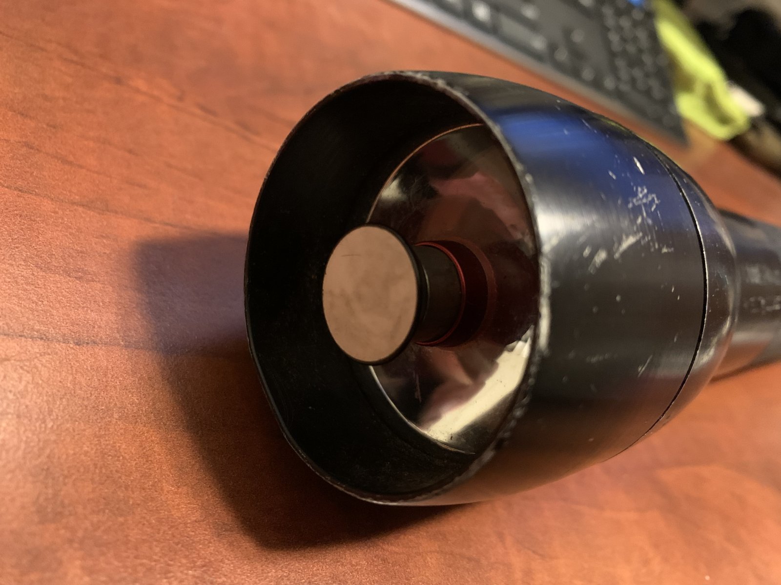

There is a disk mechanism protruding from the lens (see 2nd pic listed below), pulling and pushing the disk changes the color of the beam from white to red.

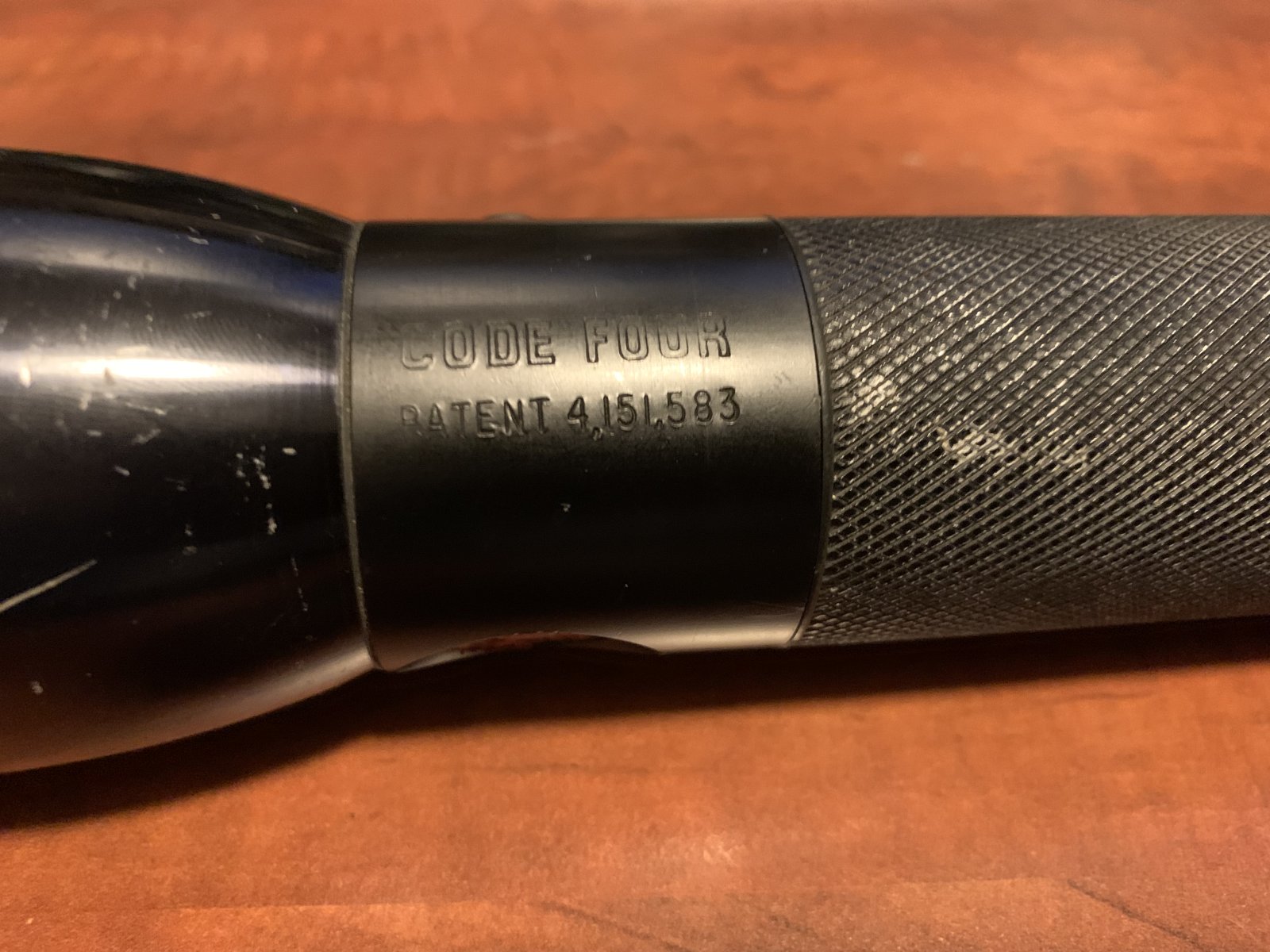

One side is stamped "CODE FOUR" and "PATENT 4,151,583".

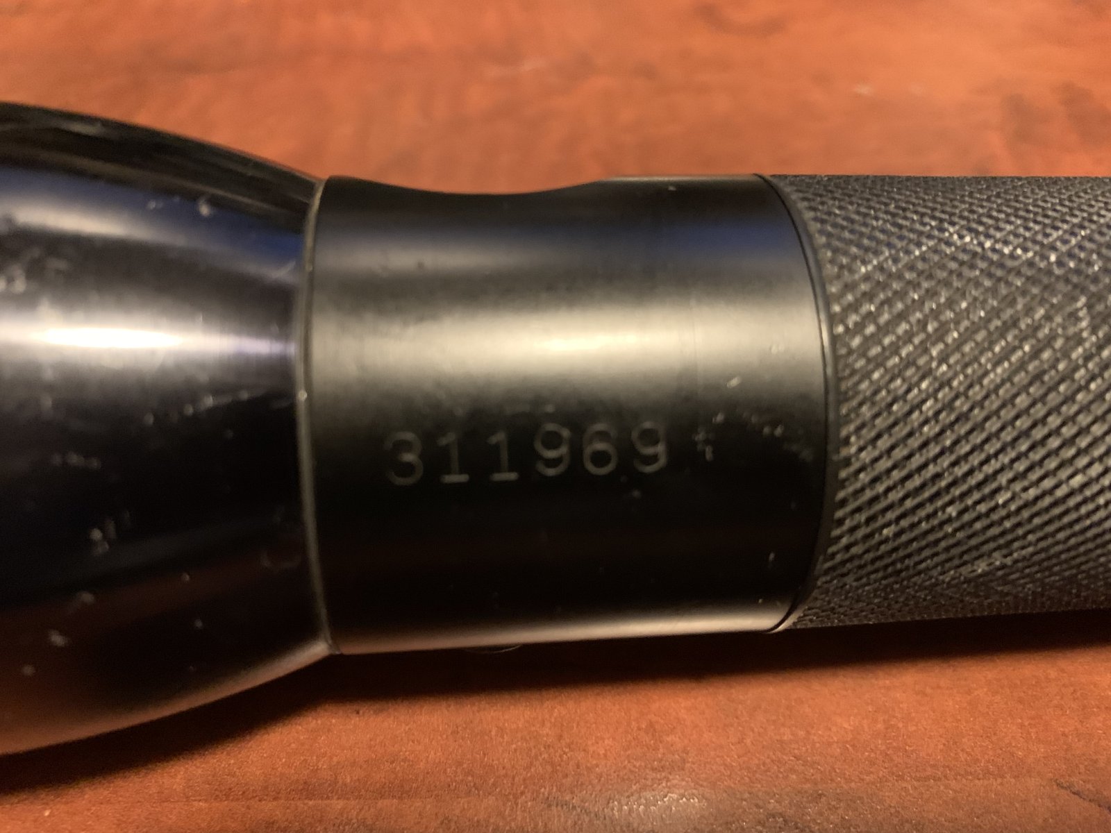

The other side is stamped with what I'm guessing is a serial number, "311969".

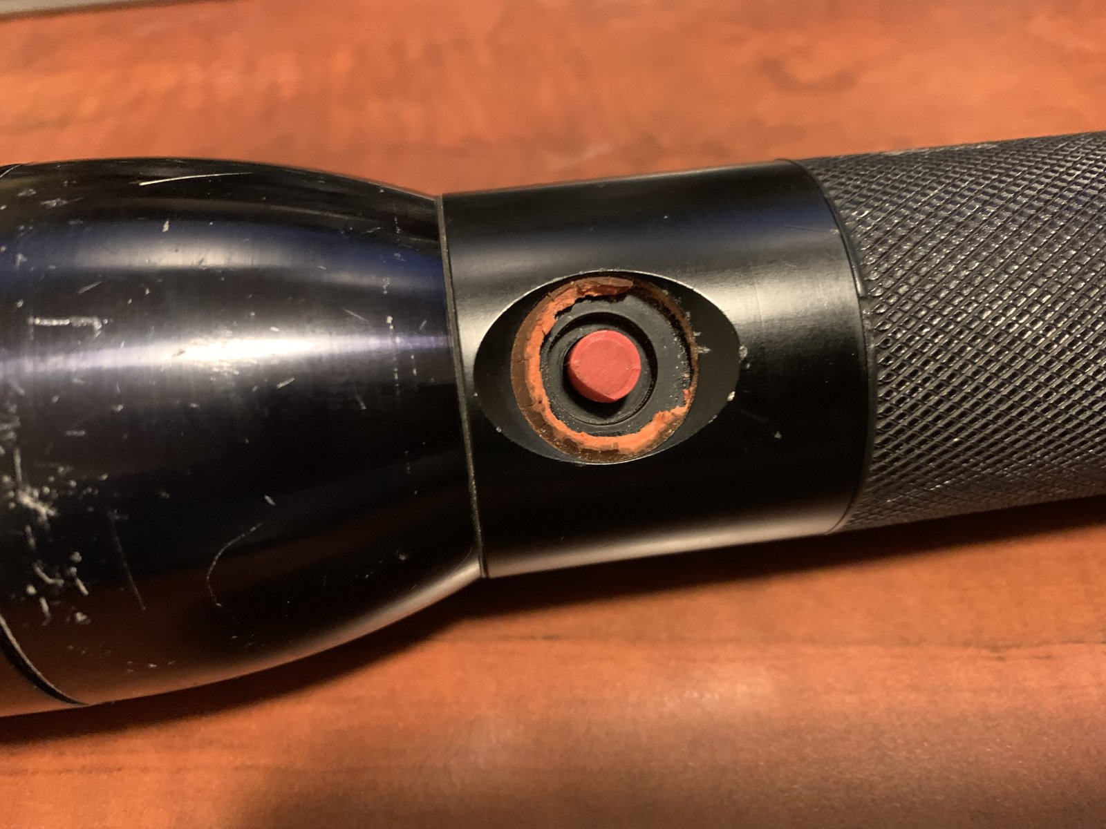

There is a single plunger with two rubber covers (one on each side, directly opposite so one side turns it on and the other side turns it off).
It uses 2 D cells.
Incandescent bulb is marked "K2 JAPAN" (very typical/common looking bulb with flange).
1) I would be very appreciative if any sage wizards here can provide any background on this particular model or company.
2) The light does work, but is quite dim even with fresh batteries. I plan on putting in a modern led bulb if #3 and #4 below can be fixed.
3) One of the rubber switch/plunger covers is in perfect condition. The other looked like something corrosive got on it. Thinking it was just a pull-off-able cover like most maglites, I pulled it out but edges are stuck in. I'm not sure if whats left just needs a dental pick and a maglite cover would work? Or did I destroy it? I don't see an easy way to remove the internal switch mechanism if that is what is needed. Any Advice?
4) All the threaded joints work very smooth and easy, except the first one behind the reflector. It binds, but the threads are ok. Is there a recommended lubricant that I should try?
If there is hope for the rubber switch cover, first thing I will do is get Caig DeOxit on all the contacts and springs. Not sure there is much that can be done for the finish, I'd prefer to keep it original rather than cerakote or similar.

I'll skip to 3, the idea behind the plunger switch was so the officer/user could easily ID on or off. The thinking at the time was the red for on was easy to spot. But in the dark they "felt" the same. So some ripped the red cover off so they could definitely "feel" the on side. Those reds covers are as rare as an honest politician so keeping it as is is kinda cool anyway.
Now to question 2, once you crack it open you'll likely find there is no bulb fastener. LA Screw did that on purpose saying it saved time changing bulbs in a fire-fight.
Question 4, vasoline will be ok to use to lube the threads.
Go ahead and try to deox-ify the internals but they generally weren't very bright. What you should notice is the beam going from an orange to a nice yellow, but don't expect a lot of difference in output.

While it would be nice to have a red cover now that I know those were authentic, I'd be happy with another black one. Has anyone found a compatible replacement?
The top cover for the switch assembly came off by itself, and one of the tiny black U-shaped (one leg longer) springs popped out. That seems like it would be easy to replace with needlenose and the other is still in place. I'm not sure how far down they are supposed to sit in that cavity. I guess my main question is - if a rubber cover can be found does the switch assembly need to be removed in order to replace the cover?

First off, some of the folks posting stuff in the lube thread have spent hundreds on a flashlight so they are generally not concerned about the cost of the lube
Next, regarding an LED, unless you find a high output LED "bulb" we call drop in or do a high output modification there is no need to be concerned about heat or excess taxing of the switch itself. LA Screw built lights of the same parts that could withstand up to 7 D cells without the light bulb melting anything. If yours has a metal reflector that was an upgrade they did when halogen bulbs began to show up.
The reason your outter edges are sticking on that red cover is they used a "cheap miracle glue" (we now call super glue) to keep it attached. If I recall correctly you do not need to disassemble anything to reattach one.
I do not know of a substitute for the switch cover. But even around here there is not a lot known about the LA Screw flashlight so there may be a viable substitute like a Maglite switch cover that could work. Try a site called zbattery for one of those. Or perhaps flashlight distributor for a Streamlight switch cover.
Hope that helps. You being a tinkerer you should be able to get that spring back in. Again the cheap miracle glue was used to hold the top cover in place.
