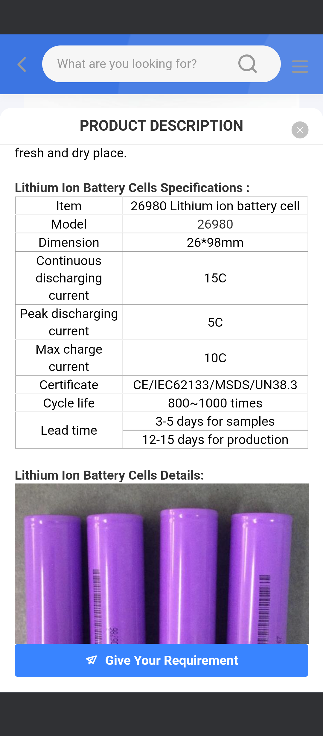

I am running these 6000mAh batteries in my Convoy L8 and another flashlight I have. I got this information from the battery manufacturer's website. So they are saying this battery has a CDR of 90 amps. Is that correct?
These appears to have same diameter of 26650 but several mm longer which is disadvantage and same Capacity.
What is advantage compare to 26650?
I would be stunned if they didn't just accidentally swap the "peak discharging current" and "continuous discharging current" fields. That's gotta be a typo.
