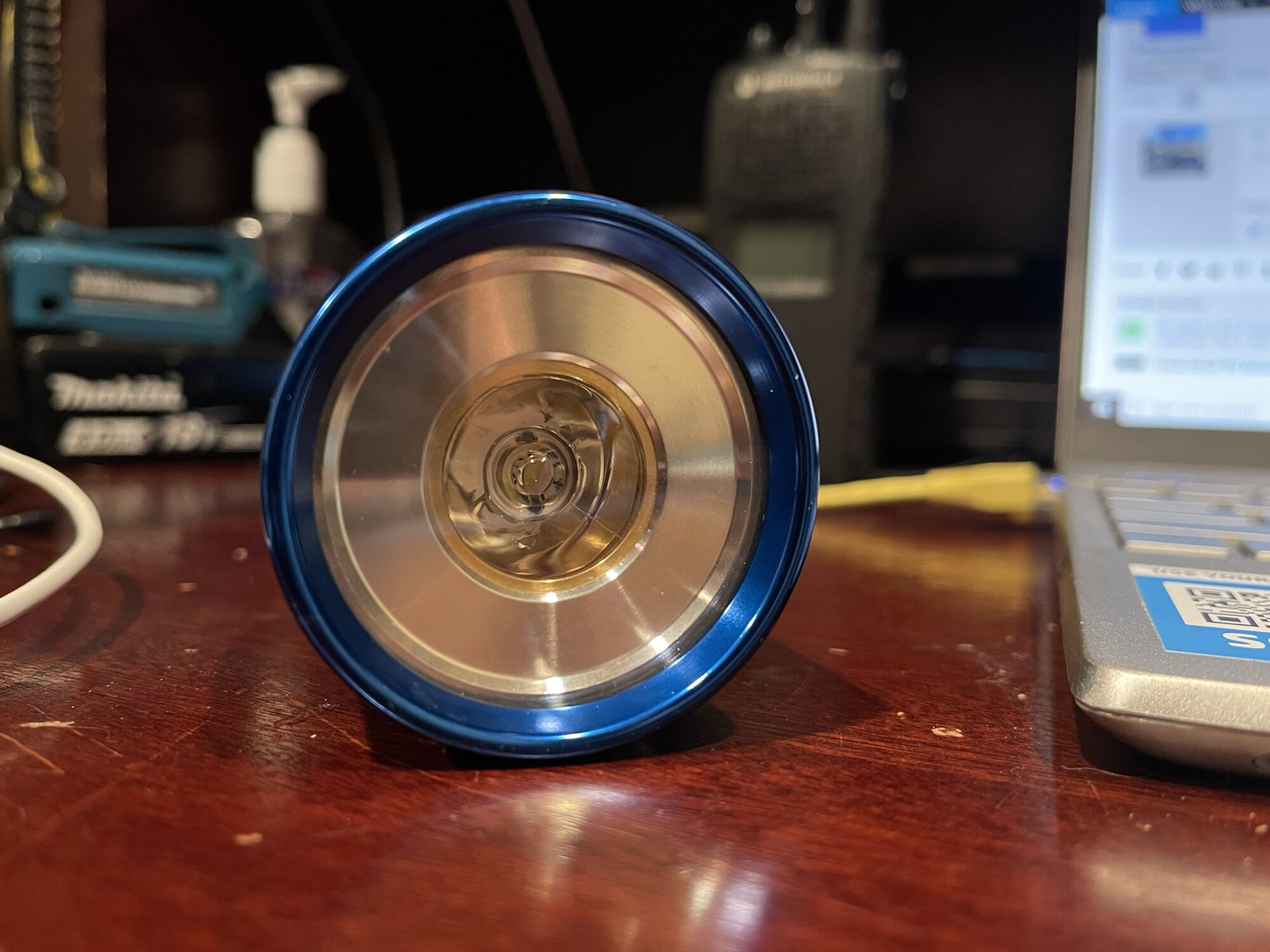

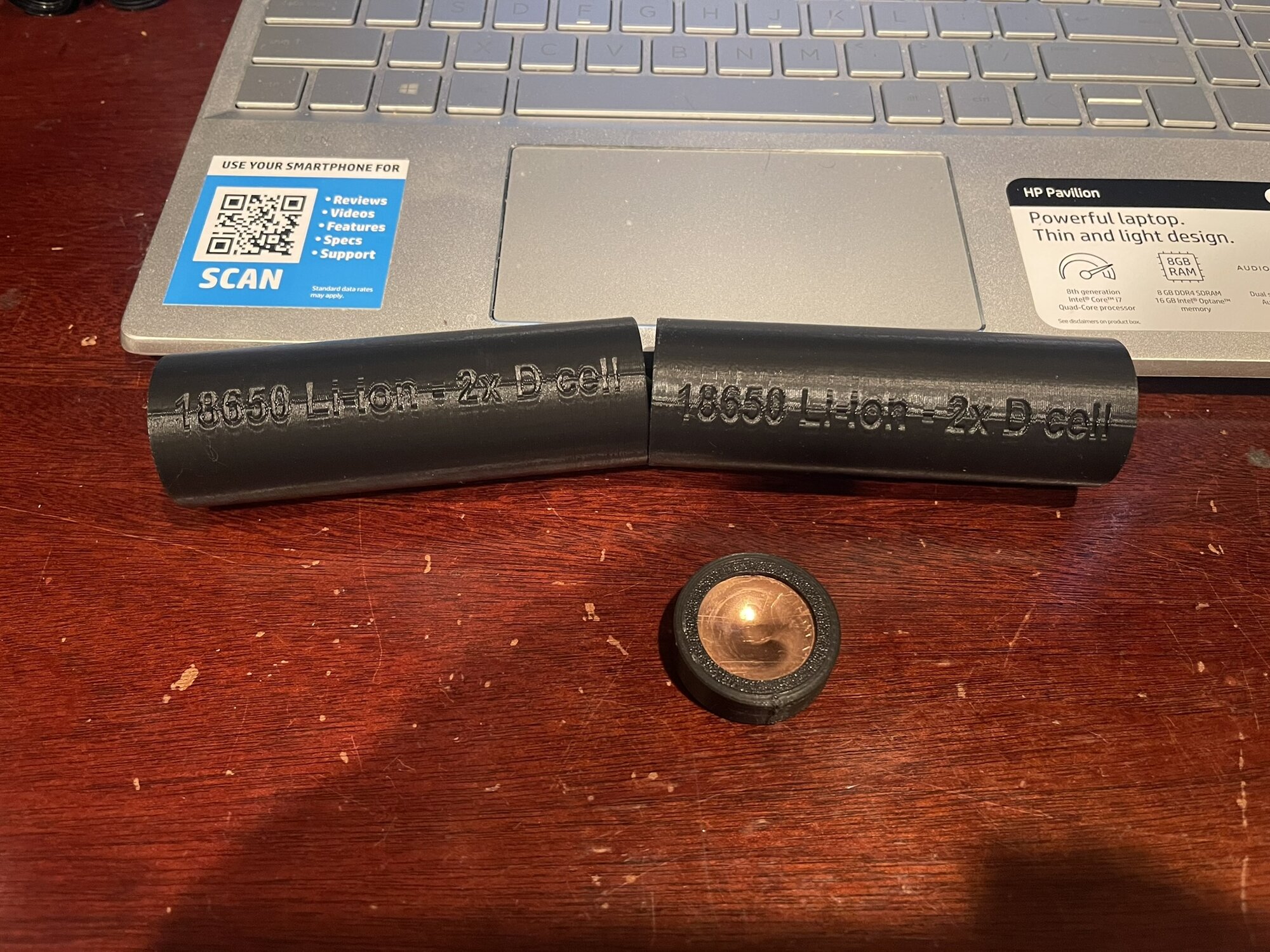

So I ended up upgrading another 4D Incan I had laying around,
4D Blue Maglite as the Donor
Malkoff M91T Drop in
D cell 18650 adapters from Bino1973 on eBay
Weltool glass lens.

I've had really good luck with these German bulb replacements, using the existing reflector. I got some AA to D cell converters and use Eneloops, 2 per unit rather than 3 for better weight distribution for, uh, alternative uses of a large Maglite. I like the 5 or even 6 cell ones and last I knew, Maglite was still selling them dirt cheap on Walmart or directly from their own website. Though I really do like their own LED solution in the ML300L series, which still uses D cell batteries.
I'm curious how the Malkoff drop ins are when dealing with impacts?
Malkoff drop-ins are specifically designed to cope with impacts. They’re built like tanks due to potted electronics, brass construction etc.
M61 is floody beam. Modules with optics instead of a reflector (M61HOT, M91T) have more throw. Like the stock Maglite beam but more powerful.
