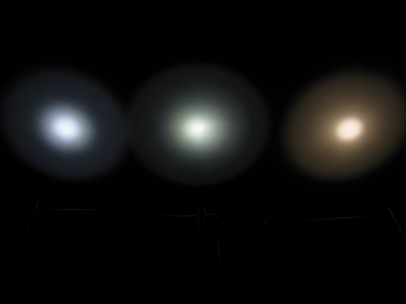

The Uniquefire AA-S1 has a more neutral tint than the typical cool white, but it isn't really a true neutral. Here is a beam shot at 1/400 second exposure of an AKOray K-106 modified with a cool white XP-G, then the Uniquefire AA-S1 with Osram LED, and then a flashlight with a XP-G R4 5B1 LED that I got from Cutter.
