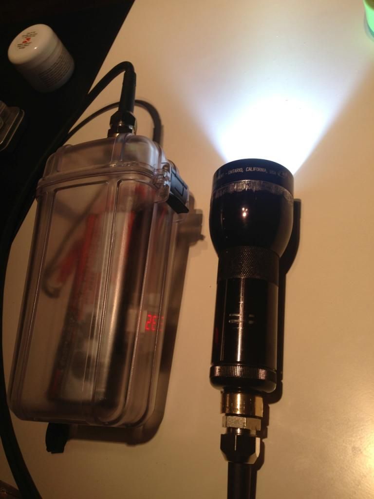

Hi everyone,
this is my first attempt on a canister dive light, and it turned out ok so far, with some difficulties. Please excuse my lack of knowledge below, I'm new to building led lights myself, and I really like it, and enjoying the process a lot.... I must thank Hector for all his help without his suggestions and parts I would not have been able to complete this light.

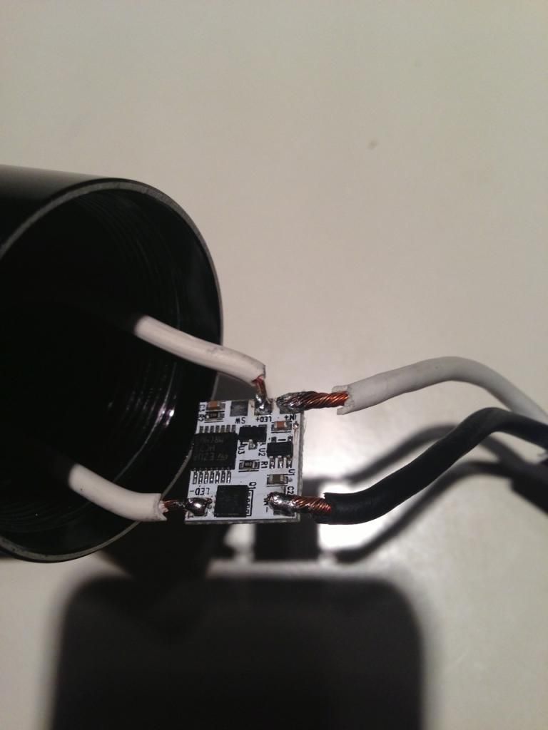

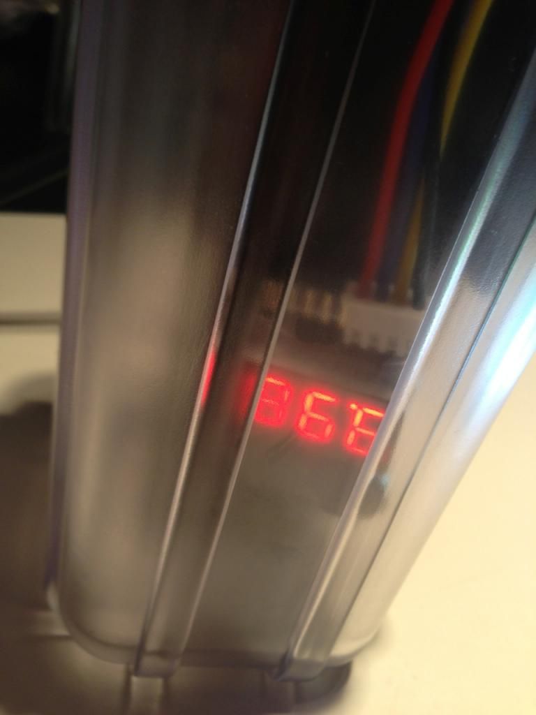

I have used a triple drop-in xml module from dx and it shines ok, but I think I need a new driver in order to get the maximum out of those XMLs. The battery I used is a 9.9V LiFePo, 4500mAh, and it looks like it will drive these leds for a long time. Haven't tested it yet. If anyone can suggest a driver that I can replace one from the module, I would be grateful.
Also I measured the current inline between the module and the taskled switch that I used, and it shows like the leds are getting 0.42A which was really weird. It's possible that I'm measuring the current wrong. :)

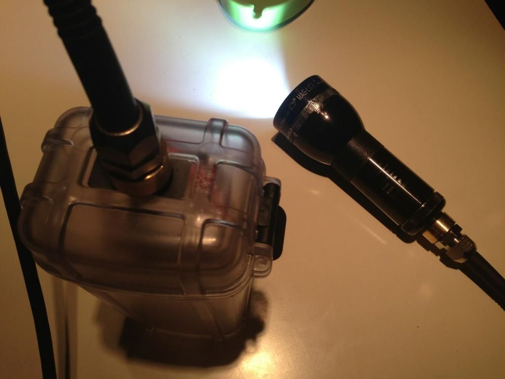

I'm planning to take this setup without the electronics (battery driver and switch) to my next dive, probably to 40-50m, to see if it will leak anywhere. I'm worried about those o-rings I've used on the connectors to the mag and the canister. I'm wondering if I should just glue the connectors with silicone to avoid leaks.
Daniel
