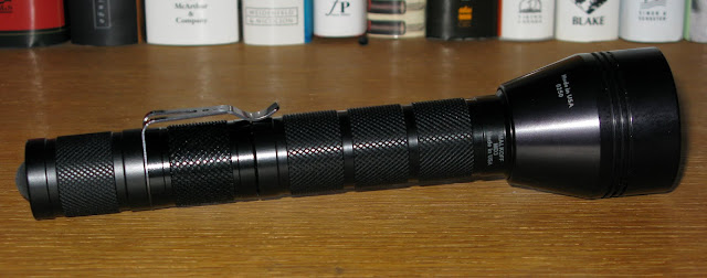

I've never handled one of the MD2s but if they are the same size as the C2, I found that the moddoo clip for my HDS + an o-ring goes under the tailcap really nicely. A pretty good alternative IMO. Maybe someone can confirm if they fit.
Here's what it looks like on my C2 in post 381.

I'll try out the Moddoo HDS/Ra clip later tonight. It wouldn't work with the old-style MD2s since there is no tail cap.
<EDIT> OK, I've tried the Moddoo clip. As expected, it installs very easily between the tailcap and the body. It also is very solid - it gets clamped between the two. If you have the new-style tailcap with a McClicky, you can also install the clip on the tailcap, like installing one on a Z59. This makes for a deep-carry clip. Two things to consider for that configuration... you'll need to add a washer of the same thickness as the clip, since the delrin ring clamps the switch in place, and you'll have about two full turns of threading the delrin ring into the tailcap to hold the clip in place. I've also seen a reference that suggests the delrin ring is going away - maybe an aluminium retainer instead, with an idea to securely holding a Malkoff issued clip in place? (Speculation on my part!)
<EDIT 2> There is a picture of the new tailcap without the delrin ring in the "Official Malkoff Junkie" thread. From the picture, and a description elsewhere, there is no external ring - the McClicky threads in place from the inside, so we're back to the add-on delrin ring with clip or other custom (e.g. drill/tap) options for clips.
Note: This was done on an MD4/Hound Dog/Wildcat since I don't have one of the new MD2s with the McClicky. I expect it applies though.

Syncytial, how does one remove the delrin ring on the tail cap? I tried removing mine but it doesn't bulge.
I didn't even know it came off, so I tried to remove mine. It just unscrews. You have to grip it pretty tight.
Looks like I need a new MD2 host, I loved my 6P/Z59 set up with the clip installed on the tailcap. If the new MD2 can be done this way too it's the next one I'm getting. Thanks for the pics!
The delrin ring just unscrews normally. There was no thread-locker on mine, but it was tight. I used a silicon sheet to aid in grip.
