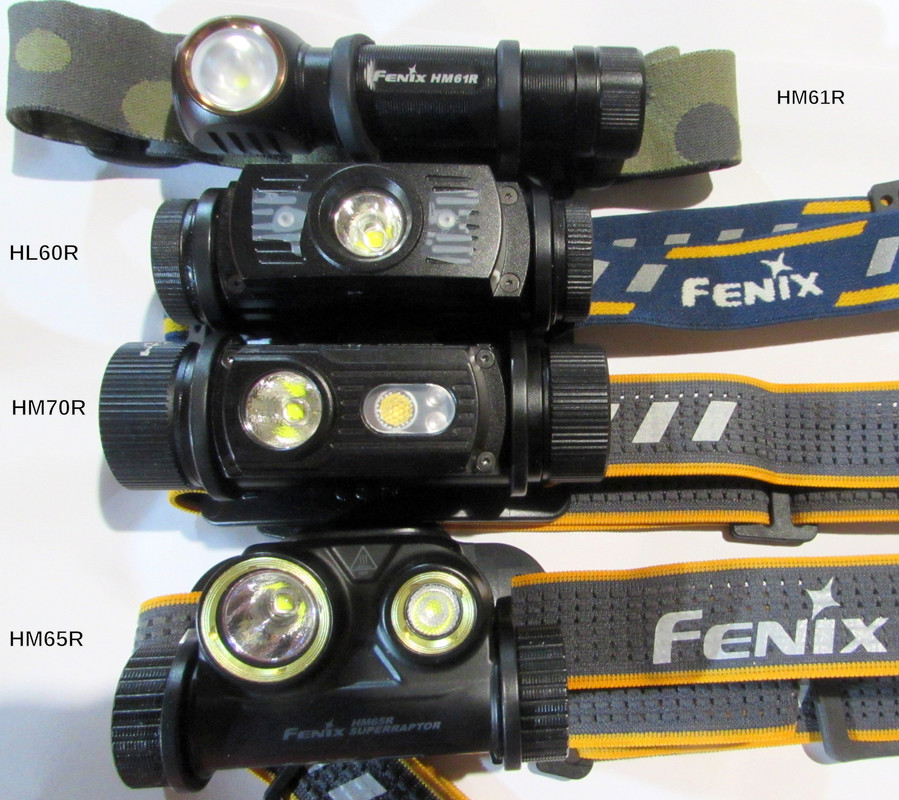

After buying the excellent HM61R model the previous year, I clicked to buy the HM70R, it has two LEDs, one (SST40) has a spot type beam and has a cool withe tint (about 5700/6000 K) the other one is XP-G2 HE (flood) led with neutral tint 4500/5000K) and high CRI, there are also two 2835 type red leds.

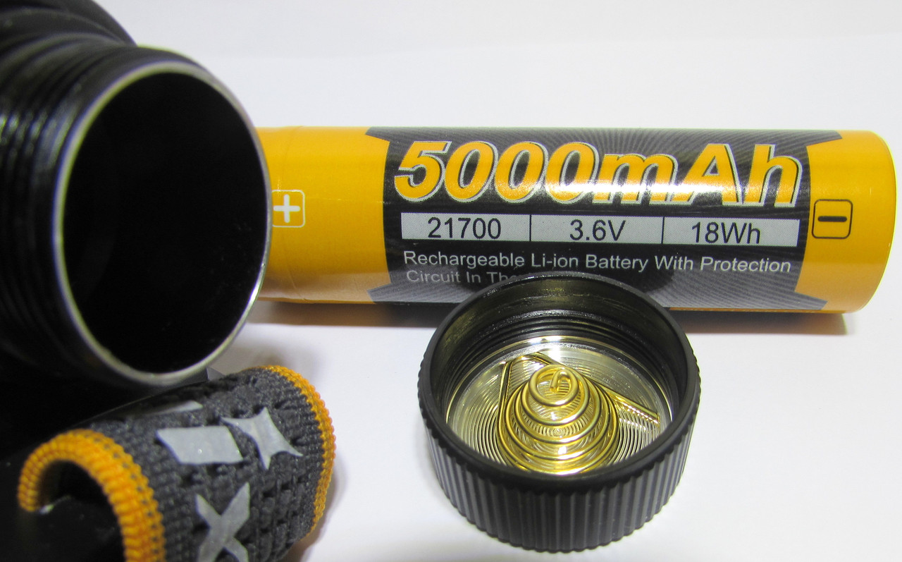

Compared to the HM61R the HM70R uses a 21700 battery with a capacity of 5000 mA, this means more weight and slightly larger dimensions but also a longer autonomy.The HM70R has a look reminiscent of the famous HL60R (with 18650 battery) called by many "the caver's headlamp", a HM60R model with 18650 battery has also been released.
![IMG-0853.jpg IMG-0853.jpg](https://data.www.candlepowerforums.com/attachments/39/39337-4f01ea7055a7b6ecaa5f8f2fe51cb06c.jpg)
![IMG-0854.jpg IMG-0854.jpg](https://data.www.candlepowerforums.com/attachments/39/39338-2462913e2d64b26c37ecc5cdbce3b306.jpg)
The first thing that struck me when I had the HM70R in my hands is that it is not as big as I thought from the photos seen on the web, it is bigger than the HL60R but in my opinion it has very small dimensions (considering the type of battery and its performance)

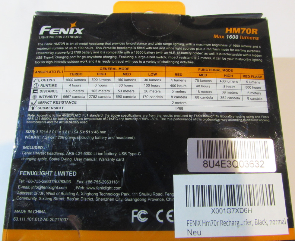

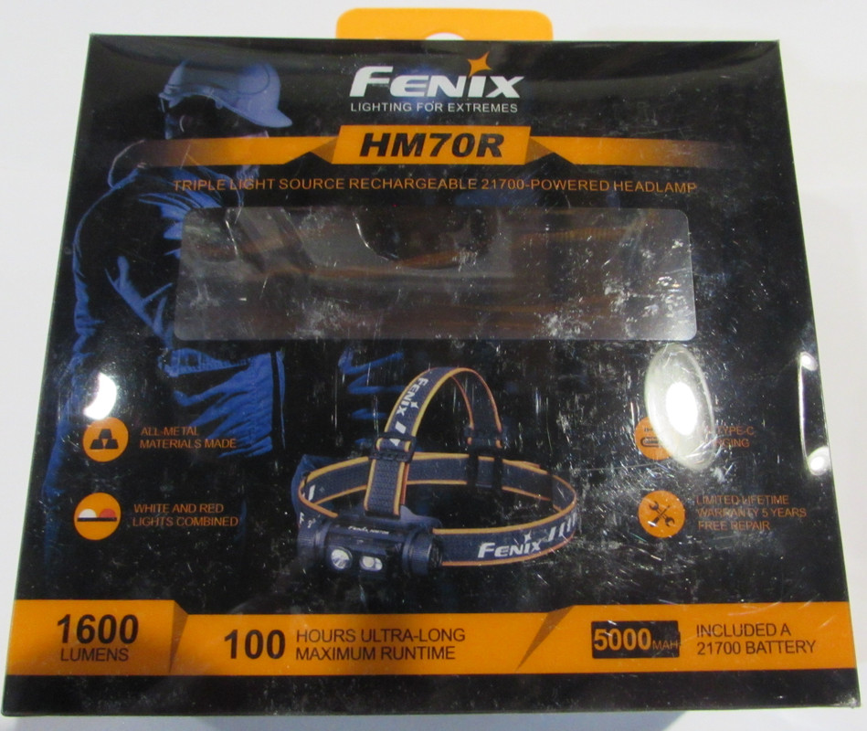

I show some photos of the packaging, front and back.

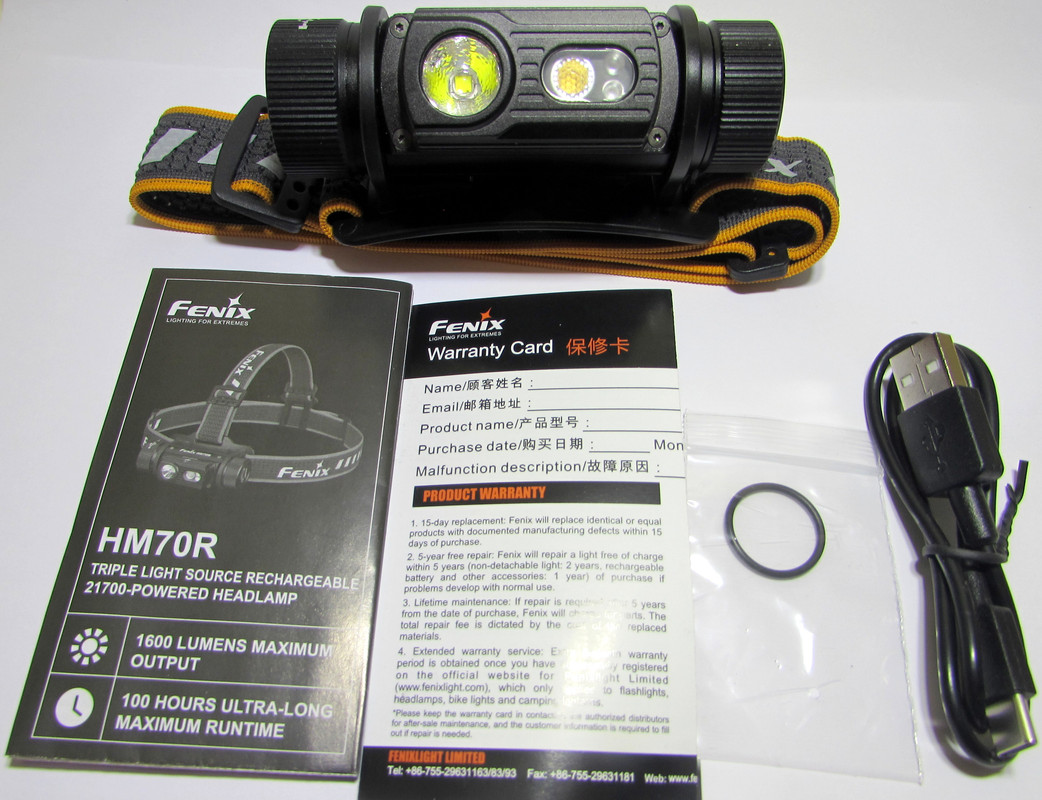

The content is the usual, small paper manual, warranty card, spare oring, USB-C cable for recharging.The flashlight is sold together with its 21700 Fenix ARB-L21 type battery with 5000mA capacity.

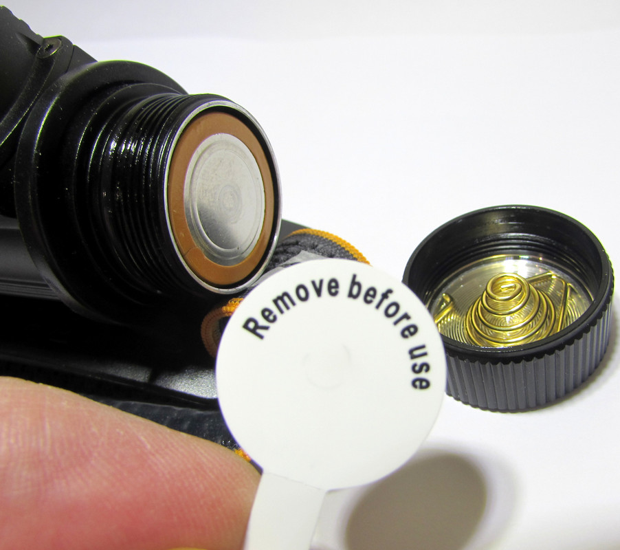

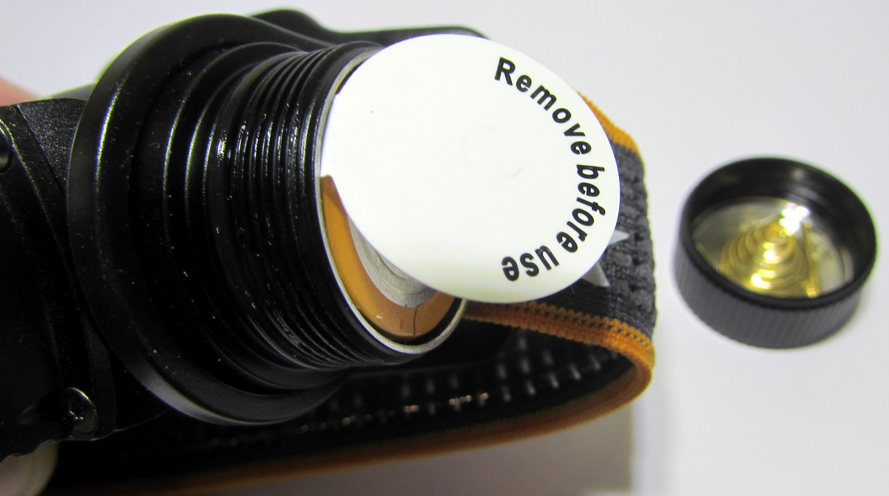

The battery is already inserted in the headlamp, but before using the HM70R it is necessary to unscrew the cap of the battery compartment and remove the plastic protection disc, this is an additional safety measure adopted by many manufacturers to remove the contact and allow the torch travels to the final customer without any possibility of accidental ignition.
![IMG-0869.jpg IMG-0869.jpg](https://data.www.candlepowerforums.com/attachments/39/39343-7ad8417b57ae5402a95fa109d0389a6c.jpg)
![IMG-0870.jpg IMG-0870.jpg](https://data.www.candlepowerforums.com/attachments/39/39344-4e42b79cb72be6de56e29ff009f9a71c.jpg)
![IMG-0868.jpg IMG-0868.jpg](https://data.www.candlepowerforums.com/attachments/39/39345-46fd23ef3bfb9f36887af81bf6117a5d.jpg)
Also attached to the top band is a plastic note reminding you to remove the plastic disc before using the headlamp.
![IMG-0872.jpg IMG-0872.jpg](https://data.www.candlepowerforums.com/attachments/39/39346-2e83e5dfd74b3ce5bbb9fd7bc4e5d23a.jpg)

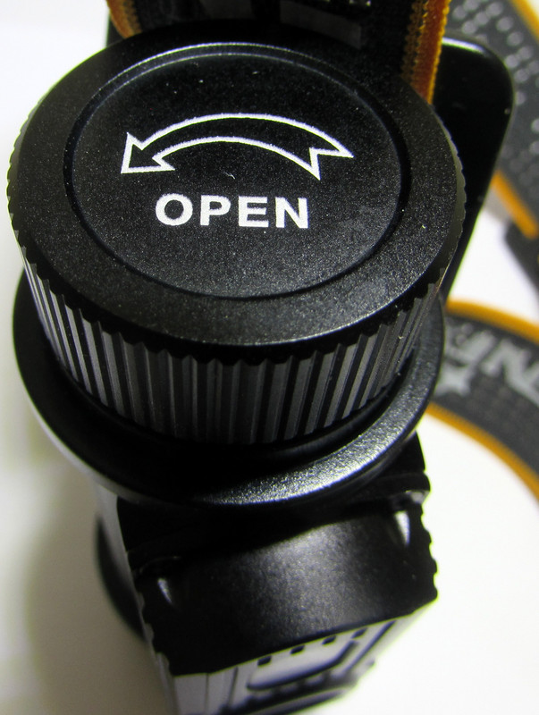

The battery cap is placed on the side and there is written: OPEN, an arrow shows the opening direction.

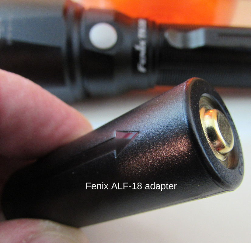

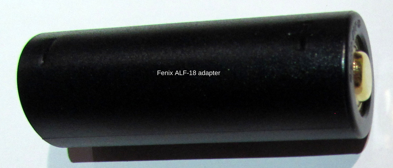

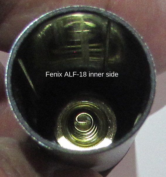

For those interested, I point out that a plastic adapter called ALF-18 is sold separately which allows you to use 18650 batteries on Fenix torches born to use 21700 batteries, it is only a plastic cylinder but it is very well made and has an internal spring (even flat 18650 batteries will work)
I bought one when I bought the PD36R and tried it, it works as promised.. if you have 21700 flashlights I recommend buying at least one because in case of an emergency it allows you to use the 18650 batteries that we all have in abundance.
![IMG-0888.jpg IMG-0888.jpg](https://data.www.candlepowerforums.com/attachments/39/39348-c9402fa18cfd7eb74faa55de863c8ce9.jpg)
![IMG-0890.jpg IMG-0890.jpg](https://data.www.candlepowerforums.com/attachments/39/39349-9611da7f1553cce4460706150e75d529.jpg)
![IMG-0886.jpg IMG-0886.jpg](https://data.www.candlepowerforums.com/attachments/39/39350-dc8fd8dd1dd43ae827ca3b51b756a8c0.jpg)
Like many Fenix lights of recent years here there is only one spring in the battery compartment, this forces you to use 21700 batteries with a protruding positive pole, the good news is that the Fenix battery is not a proprietary battery so any 21700 battery long enough and with a protruding pole projecting positive will work.
As spare batteries for my Fenix with 21700 batteries I use the Keeppower 21700 "USB Series" (acronym P2150TC) which have a low cost and a USB charging chip integrated into the battery (handy if something goes wrong) they fit perfectly.

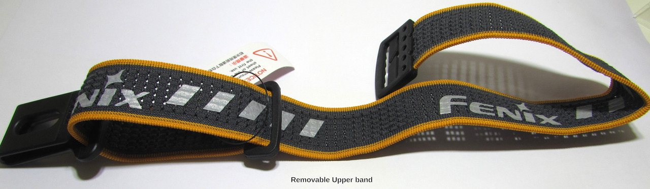

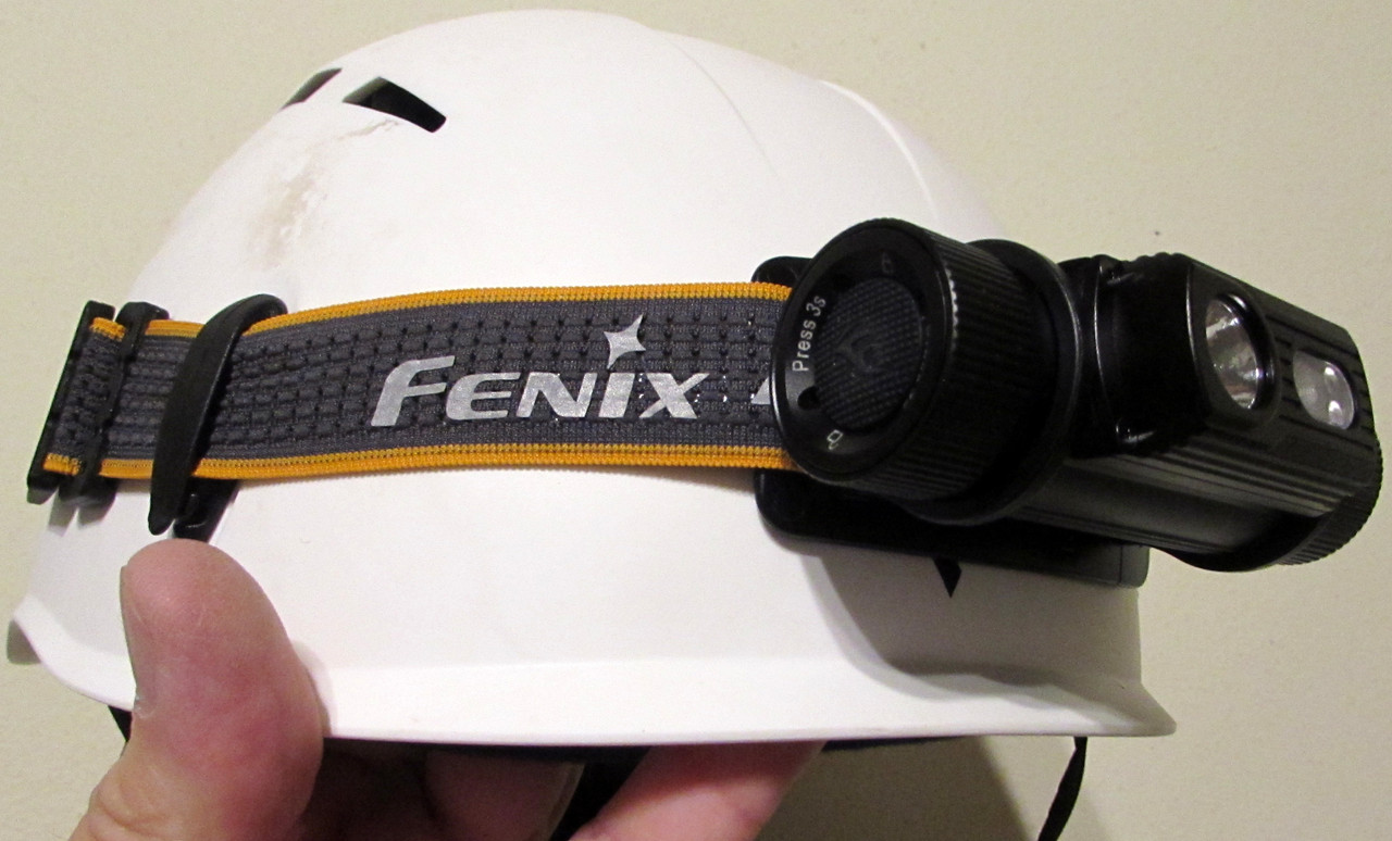

The HM70 has a good elastic band with Fenix logo and reflective bands, it can be seen very well in the dark and increases the safety of the user, it is in two pieces but I confirm that the upper piece of the band is easily removable.
![IMG-0873.jpg IMG-0873.jpg](https://data.www.candlepowerforums.com/attachments/39/39351-80cdbde51b9f2b9b883201f4de011bd2.jpg)
I never use the upper part of the piston rings and it is the first thing I remove, but for some the upper band could be useful.

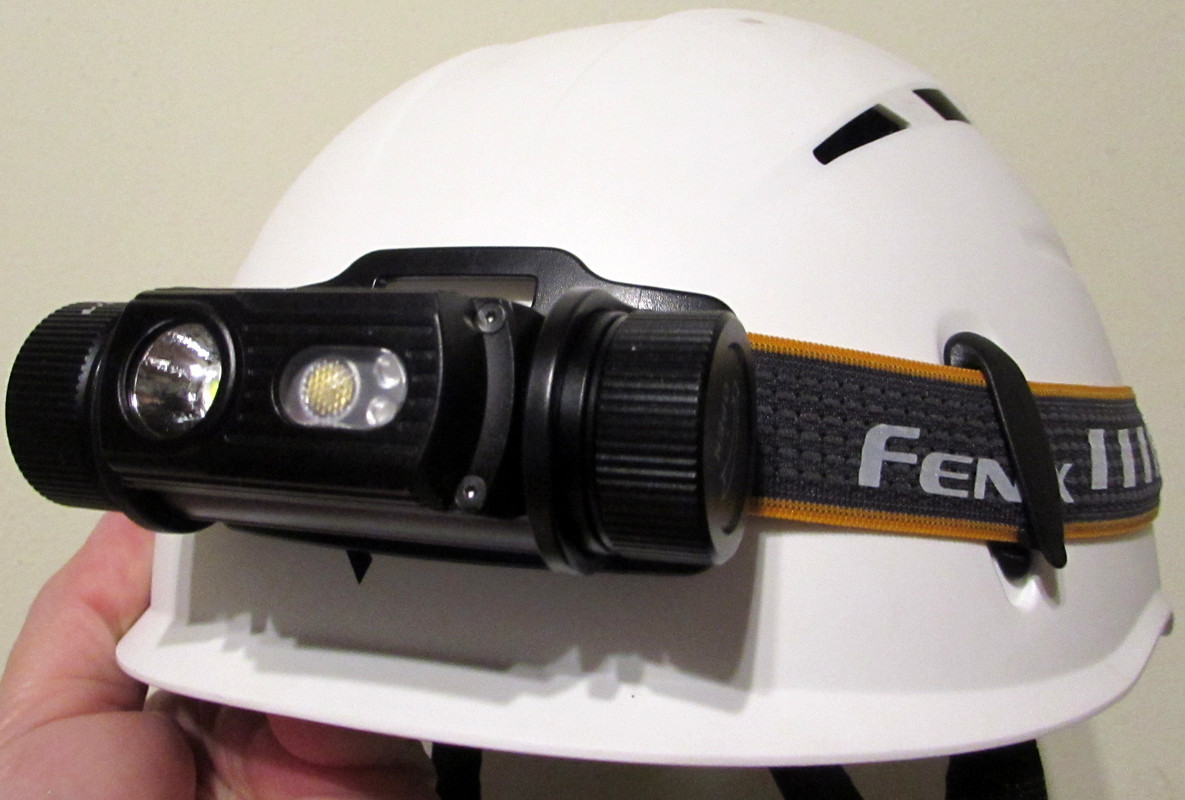

Being a Headlamp with 21700 battery it has its weight, but it is not excessive and I can use it for a long time without problems, but if you are a runner you will need the upper band.

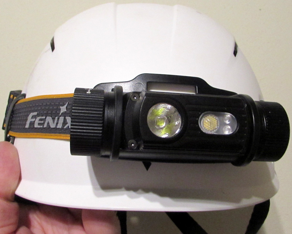

The upper band can also be useful if you plan to use the headlamp on a work helmet, it is not mandatory to use it but it could increase the seal if your helmet does not have a good lateral fastening.
My helmet has the attachment points and the top band is not needed.

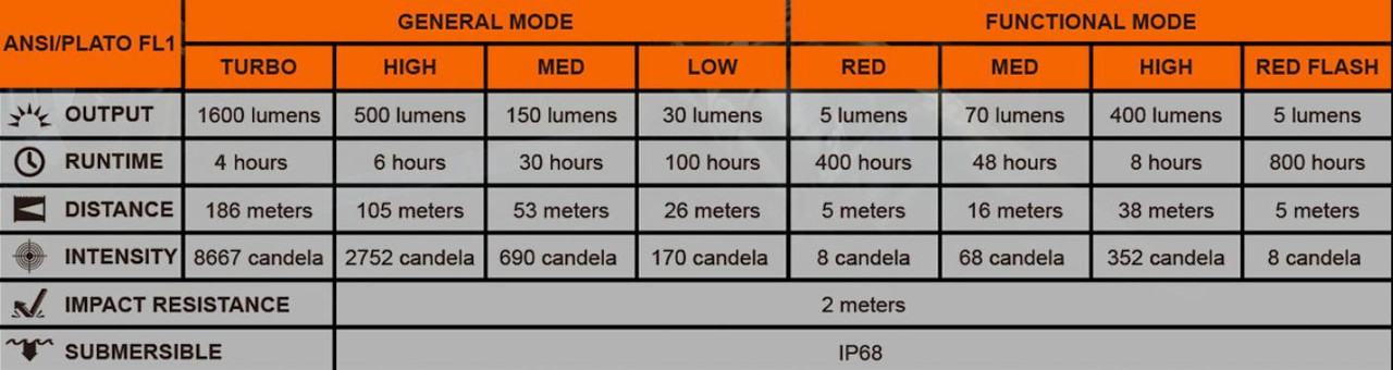

For the main menu the brightness levels are:
30 - 150 - 500 - 1600 lumens with cold light (approx. 5700/6000 K) and a spot beam which, except for the cold tint, resembles that of the HL60R

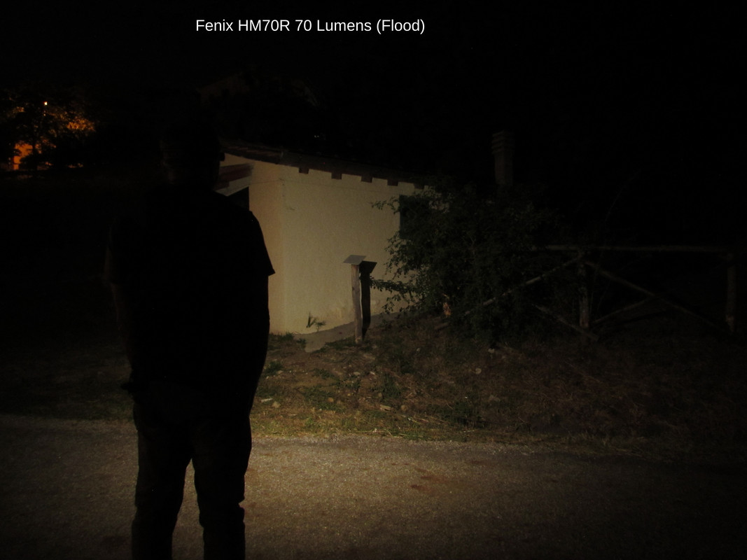

For the functional menu the levels are:
5 lumens_(red light) - 70 lumens - 400 lumens- SOS_(red light) - the two levels of 70 and 400 lumens have a very wide and pleasant flood beam, the tint is approximately 4500/5000 K with high color rendering.
![LIVELLO-DA-SITO-FENIX.jpg LIVELLO-DA-SITO-FENIX.jpg](https://data.www.candlepowerforums.com/attachments/39/39356-39d92889969368ba89e6bf94dc8a9b4f.jpg)

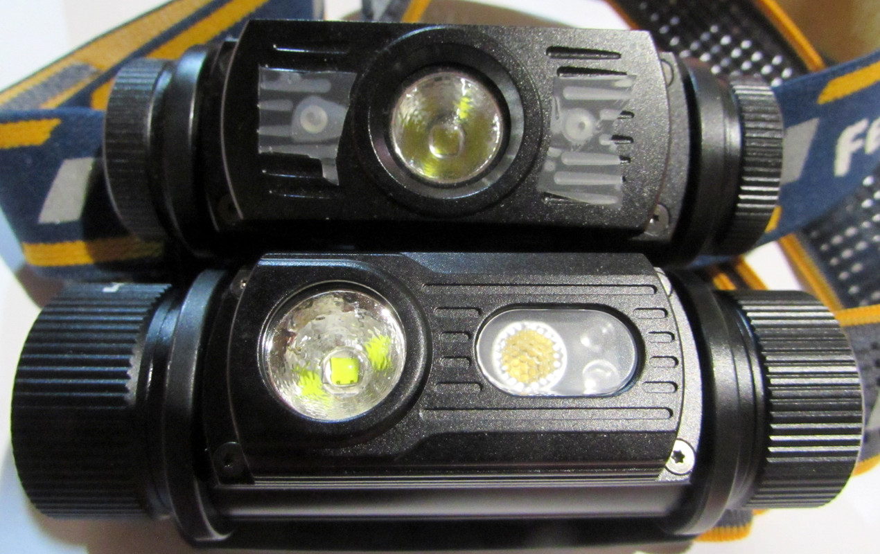

The XP-G2 HE (High Efficiency) LED is placed under a small honeycomb TIR lens that can resemble that of the Armytek Wizard models or the secondary LED of the Fenix HM65R Headlamps.

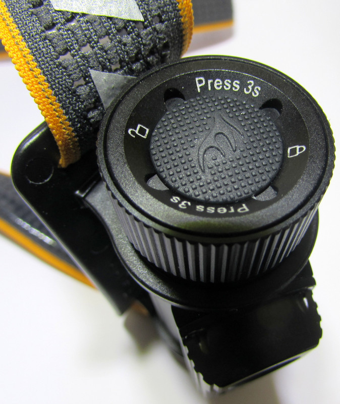

Two brief explanations on the operation of the HM70R
Half second press: turn on
Half second press: turn off
When it is on, just make a single click to scroll through the four levels Low, Med High Turbo.
Security lock: press and hold for 3 seconds, after 3 seconds the red leds flash three times and warn us that the lock was successful.
![IMG-0864.jpg IMG-0864.jpg](https://data.www.candlepowerforums.com/attachments/39/39357-3ee5cad639e8eaeed9da9f6ecf325c7b.jpg)
If you try to turn on the headlamp while the lock is active it will flash red to remind us that it is locked.
To unlock: press and hold for three seconds, if this is done correctly there will be three red flashes, the headlamp can now be used.
Personally I almost never use this feature, I prefer to loosen the battery cap 1/4 turn but it's nice there is this feature available if you want.

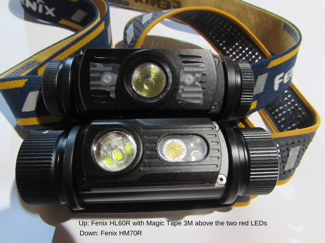

The old HL60R model had two 1 lumens red LEDs that were not very useful (full of concentric artifacts) but with the HM61R and HM70R models it is very different and you have a very pleasant vision.
I experimented with a little hack with the HM70R red light, if you use it indoors just use a very small piece of transparent 3M Magic Tape on one or both of the small red leds, this will diffuse the light and you will have a very red flood light similar to that of the HM61R model.

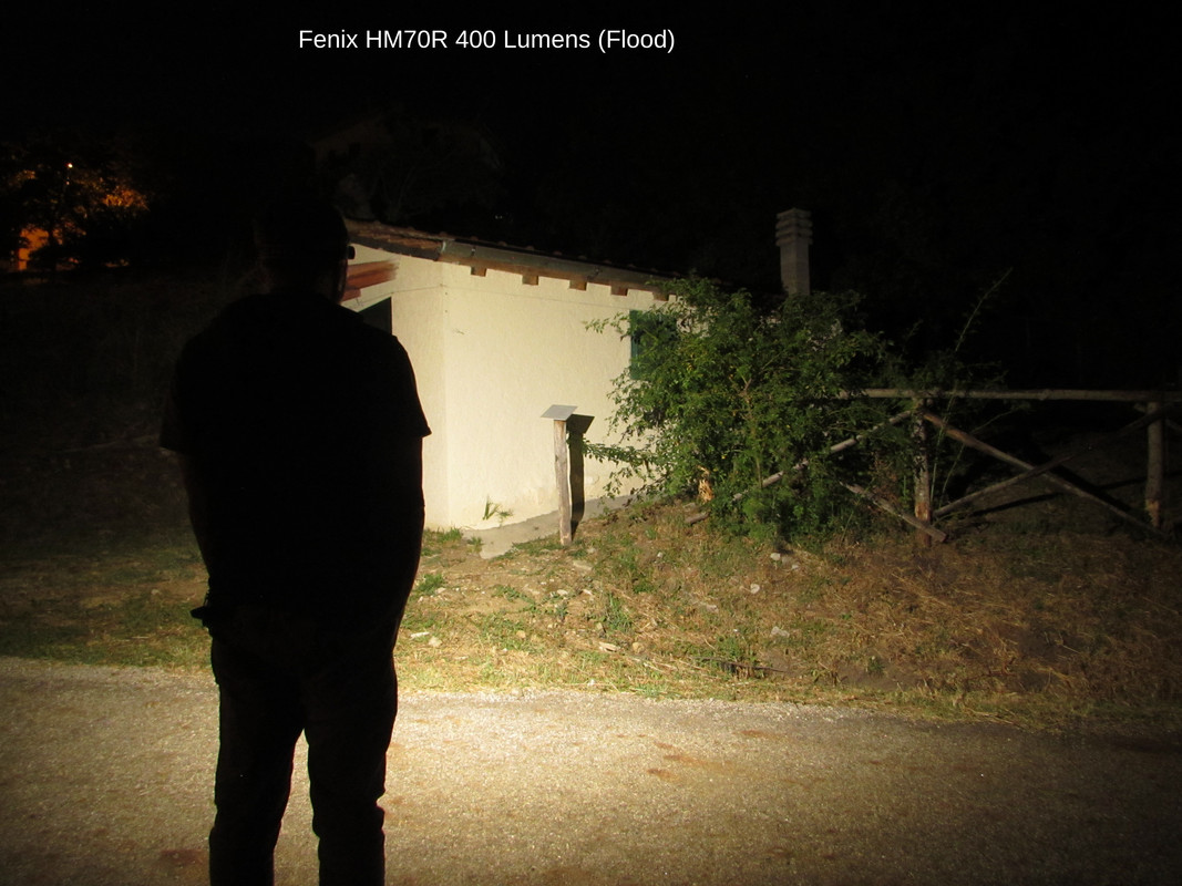

Using the HM70R with the HI CRI flood led is very pleasant for the quality of the light emitted, with 70 lumens you can see very well in any indoor environment but also if you have to do something outdoors at close range.
For walking on an impervious, difficult and perhaps dangerous path, the 400 lumens level is perfect for seeing where you are stepping.

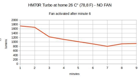

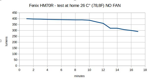

While I have used the HM70R indoors for a long time I have not tested the HM70R thoroughly outdoors, only a few walks of about 30 minutes (I had to temporarily stop due to the summer heat and the usual summer invasion of wild boars with their young) but enough to be able to say that the Turbo is stable enough for at least 4 or 5 minutes, then it clearly starts to drop in power.
This shouldn't be surprising because 1600 lumens on a headlamp is a lot and the HM70R isn't as big as it may appear in the picture (to dissipate heat optimally you need a large, thick and therefore heavy headlamp)
The few times I used it in tandem with the PD36R or PD36 TAC on summer nights I was thrilled.
After many minutes there is the usual drop in performance but I think it always remains around 800 lumens, with winter temperatures a higher power should be kept longerI did a home test using the 400 lumens flood level to see if there is an aggressive stepdown, the result is decent.
![IMG-0885.jpg IMG-0885.jpg](https://data.www.candlepowerforums.com/attachments/39/39340-11384fb1b4ed0ba485ce48a69213df3f.jpg)
![IMG-0907.jpg IMG-0907.jpg](https://data.www.candlepowerforums.com/attachments/39/39341-1369117e570d43031d22ffe41f021813.jpg)
![IMG-0877.jpg IMG-0877.jpg](https://data.www.candlepowerforums.com/attachments/39/39342-9befab90525f9965166c35e609867163.jpg)
![IMG-0866.jpg IMG-0866.jpg](https://data.www.candlepowerforums.com/attachments/39/39347-9fff97565f6792e9ae7a42ae7325a491.jpg)
![IMG-0903.jpg IMG-0903.jpg](https://data.www.candlepowerforums.com/attachments/39/39352-12ba293e2eaeada475d469ca76d54753.jpg)
![IMG-0904.jpg IMG-0904.jpg](https://data.www.candlepowerforums.com/attachments/39/39353-fd79d40eba65f9fa58e3fca33ea5c971.jpg)
![IMG-0905.jpg IMG-0905.jpg](https://data.www.candlepowerforums.com/attachments/39/39354-b8411b79da4990afd03ae945021f211d.jpg)
